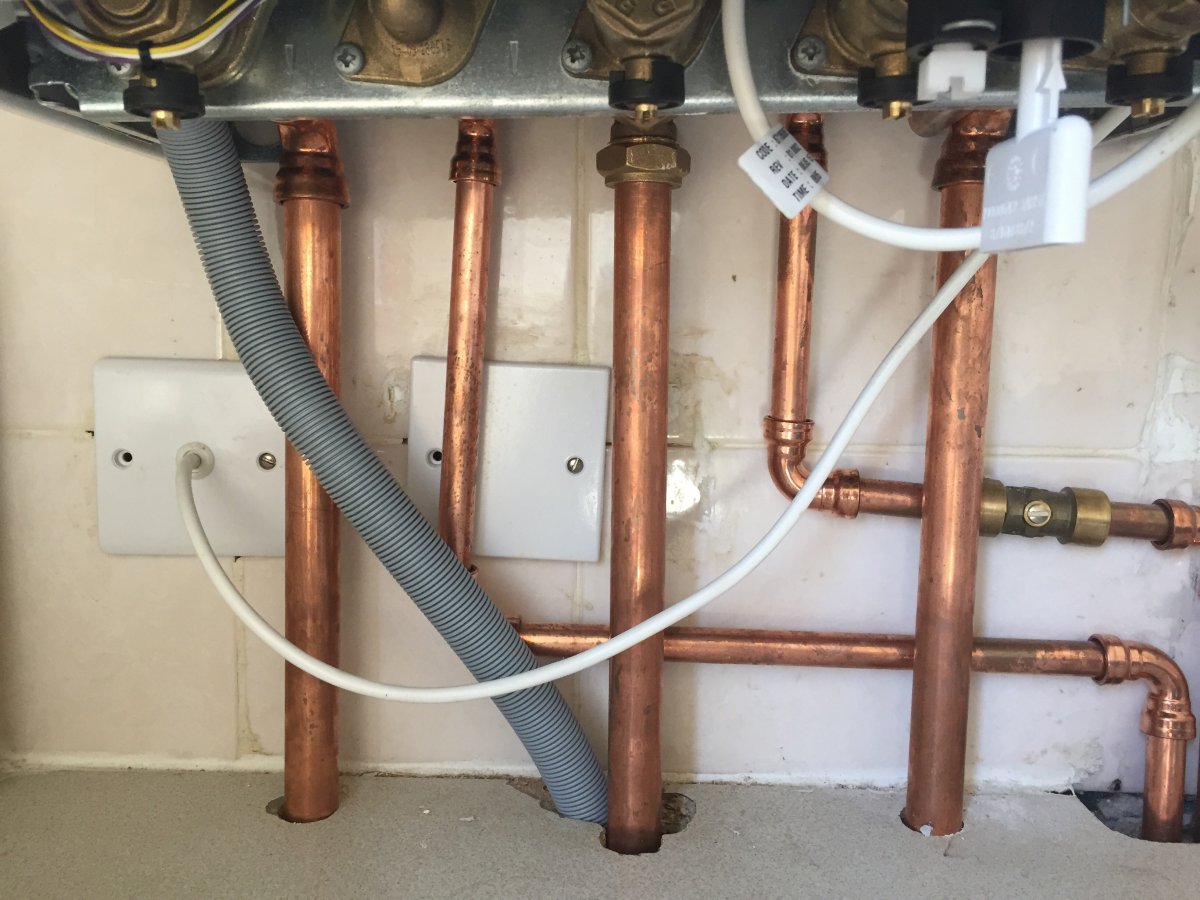

Can these pipes be moved back?

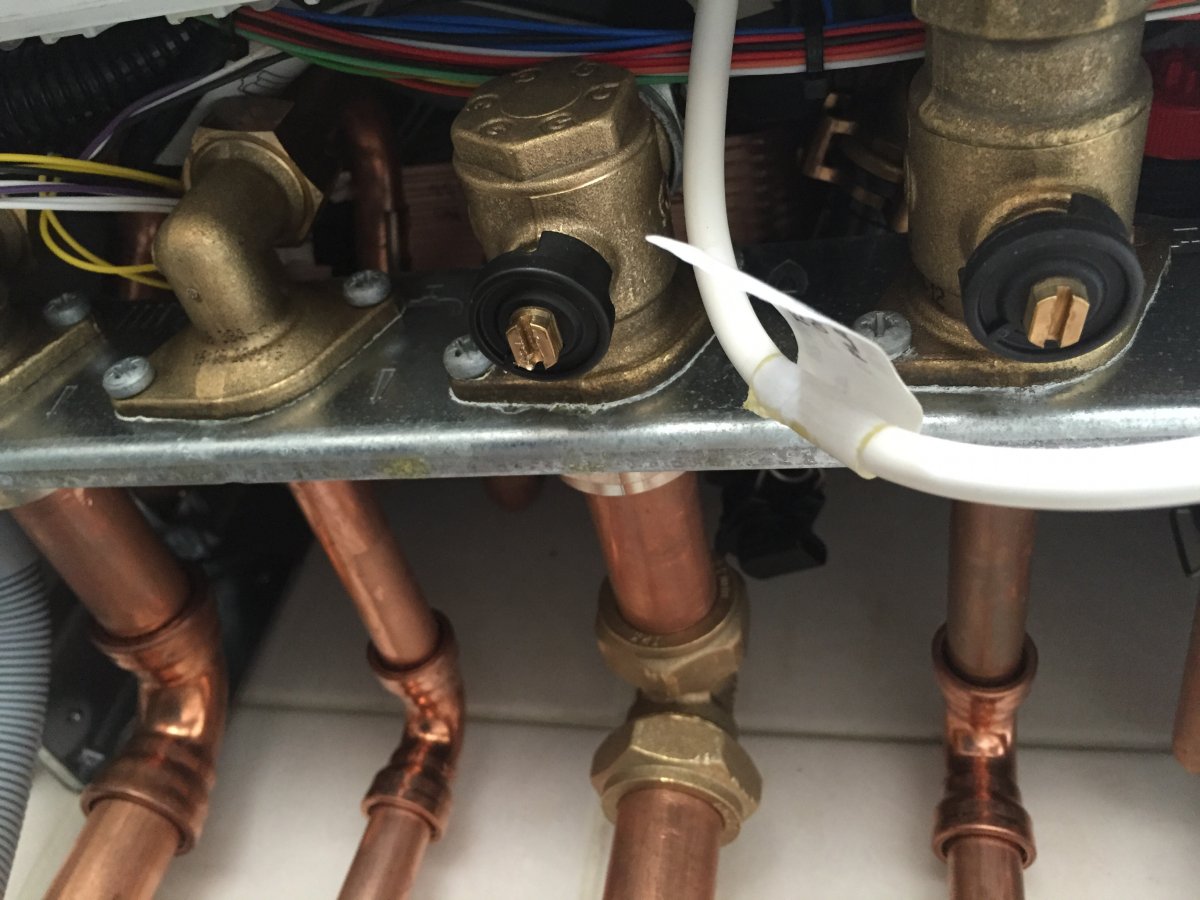

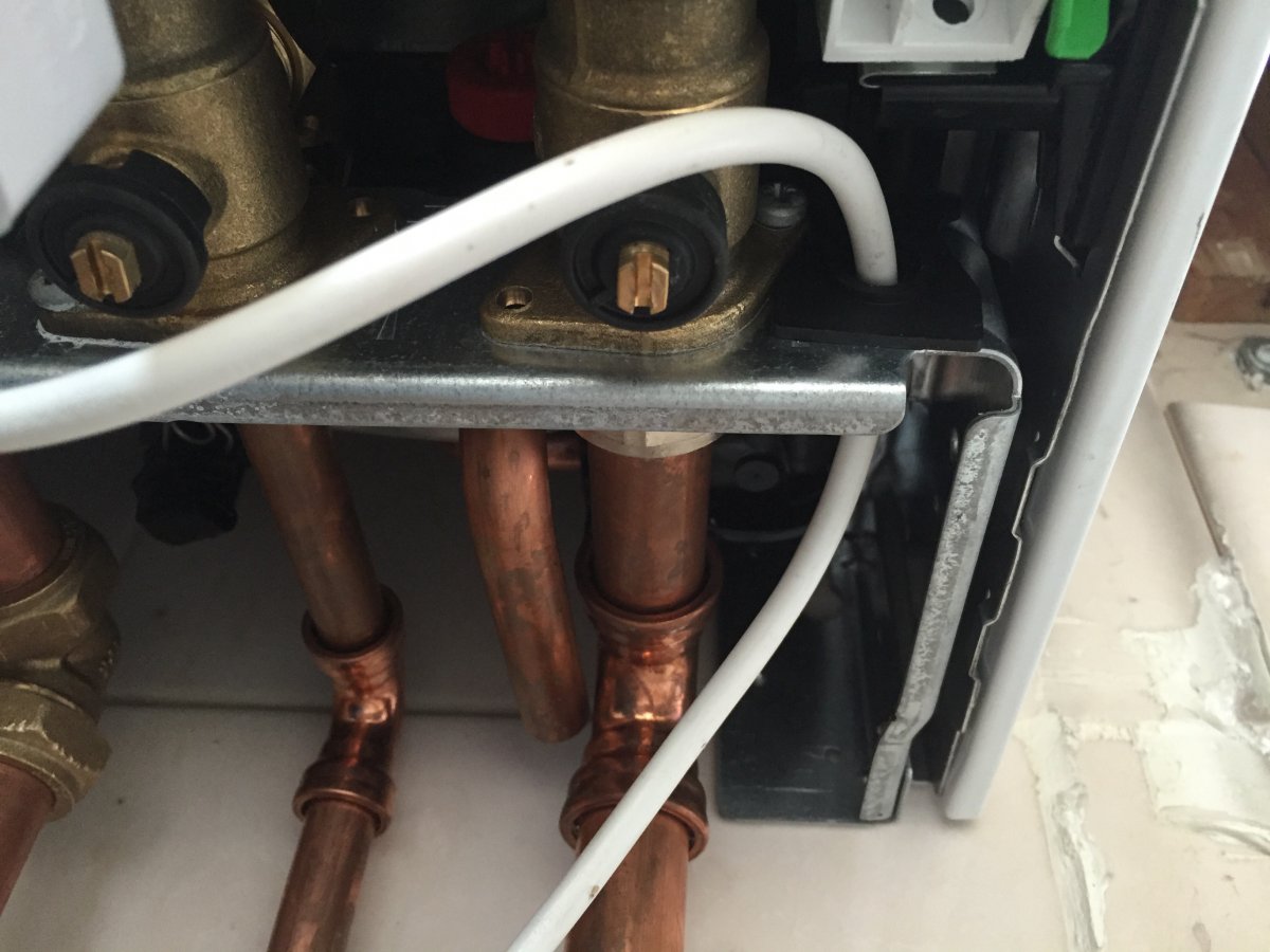

Maybe someone who is actually familiar with this model of boiler can comment, but....
I think that the pressure relief outlet is just to the left of the right-most copper pipe coming out of the bottom of the boiler. In the photo I can see something metal that points backwards towards the tiles. Does that actually go through a hole in the tiles and appear outside? Or is it just left pointing at the tiles?
It is pointing at the tiles...
Oh great!!
OK, so that is where superheated steam and scalding water will come from if the boiler overheats and it is supposed to go through the wall.
I imagine that Gas Safe will find that interesting.
I think you should assume that it is all unsafe; turn off the electricity (I'm not sure where; you don't seem to have a switch on the electrical outlet) and the gas (at the meter if you don't have any other gas appliances; if you have a gas cooker then turn it off where the gas pipe enters the boiler). Then get a proper installer to come and re-do it all. As they work, take photos of every bodge that you find and write down a list of all the faults.

My thought about safety is that we haven't seen inside the boiler. The faults we can see are mostly bodges and not immediately dangerous. But they are such terrible bodges that I have no confidence about this *******'s ability to do anything right, i.e. there could be more hidden defects that really are dangerous.
