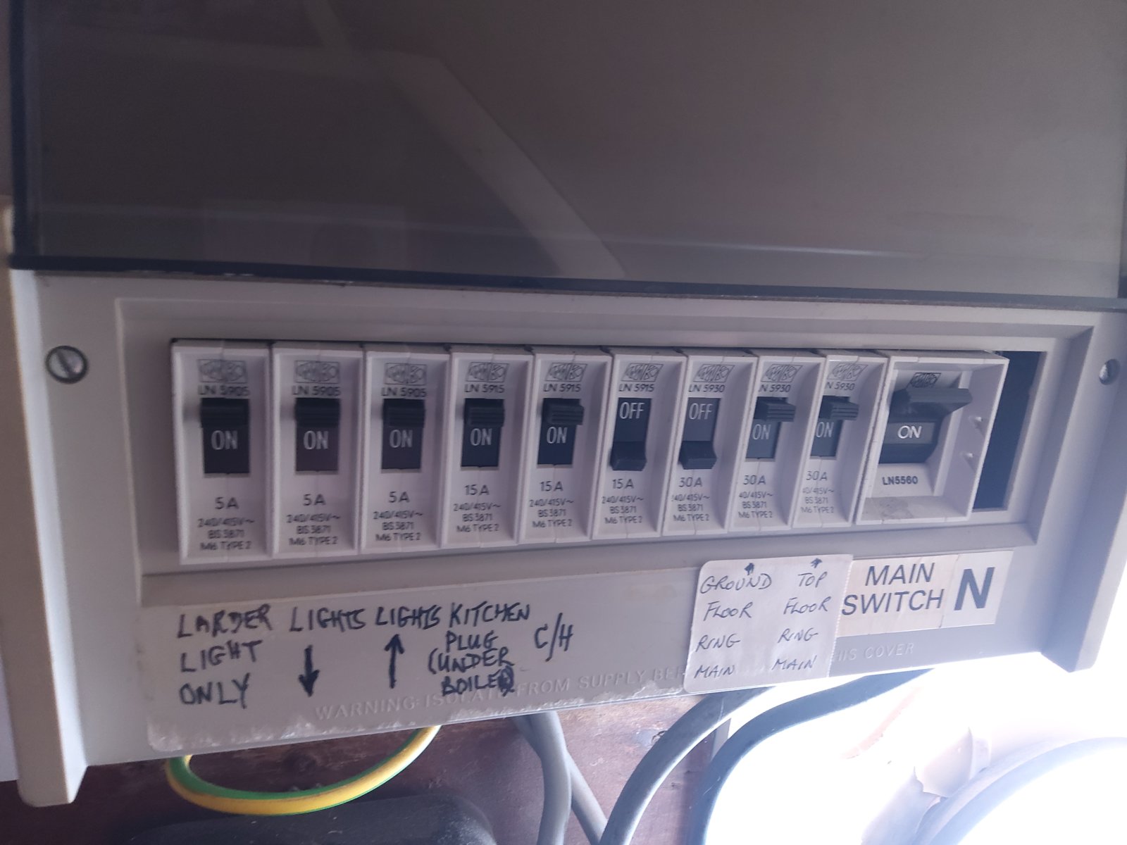

I'm like to know if this CU (installed 1985) can be brought up to current standards or is it time to replace it? As you can see there are a couple of unused slots.

If you read the best practice guides issued by the electrical safety council they still say if there is a warning sticker saying not earths on lights, it is considered as satisfactory. The rules changed on lights in 1966.
So if it complied when fitted, and has not degraded or been altered, then it's OK.
However that gap at the right would have never complied, seem to remember standard finger is 12 mm and a MCB slot is 12.5 mm so missing blank is a fail, so that distribution unit, (In 1985 we did not have type tested distribution units called consumer units) does not comply, as to blank, needs to be so can't be removed without a tool, if when removed a standard finger can touch live parts, there are some boxes where the bus bar fork for the MCB could be switched off, so the blank was only to look good.
If a RCD is added, it could cause tripping of items like freezer, which clearly costs, and the more the circuits are split the less leakage on each RCD so less likely to trip, so when renewing one everything needs testing first so any faults are dealt with before the RCD causes tripping, and second you need to assess the risk v cost around £250 for all RCBO protection plus fitting, around £60 for just two RCD's since the fitting will take a day so likely another £200 for labour to my mind better to play safe and go all RCBO protection.
So there was a problem fitting RCBO because they were taller, but there have been released some short versions now, to be called a consumer unit it needs type testing so to fit any RCBO into a consumer unit which the manufacturers has not tested in that unit means no longer a consumer unit as you loose type testing, but your box is not a consumer unit to start with, so if you can find RCBO units to fit, then no problems.
The operative word is "Fit" I have found the terminals slightly higher or lower make to make, so putting a RCBO of wrong make means poor connection to bus bar, but if you swap them all then bus bar will likely be OK, however what is the point, the box, (unpopulated CU) costs around £30 so it seems pointless trying to make new RCBO's fit an old box.
The main problem is registering the work and time taken, so needs to be done before freezer defrosts, and you need to pay some one be it LABC or a scheme member electrician over £100 to do the work, to be frank likely DIY using LABC will cost more than a scheme member electrician.

Since all new socket outlets or wiring does require RCD protection at some point it will need doing, likely you will want some new sockets at some time, but there is no rush, so do it once and do it right, using RCBO's. With that in mind may be a make which will take the RBCO needed for electric cars.
I favour all RCBO's. Prices are heavily dependent on make but ones from a cheaper established maker is probably a good idea. There are alternatives though. A mix of rcbo and mcb's with one or more rcd's. A popular one is 2 rcbo's for lights and mcb's plus an rcd for the rest. This way trips are likely to leave the lights on. Add another rcd to that and costs go up and all rcbo's may make more sense.
The need to replace your unit comes in when new circuits are added or a ring main altered. They are notifiable to your local building control. This just leaves spurs effectively and these days an electrician that will do this work may add rcd protection to them. Some might not do the work and want the lot upgraded. Some might even just fit a spur.

A RCBO is a RCD and MCB combined, but for a stand alone RCD it needs two slots in a consumer unit, so it makes the consumer unit bigger, in the main the single width RCBO only switches the line, neutral is only monitored, and they only detect overload on the line, double width RCBO's switch both line and neutral and monitor overload on both line and neutral, but rare to find them in a UK consumer unit, rest of EU seem to use them by not UK.
There are some single RCBO's which do switch the neutral used where there is a TT supply, but still do not sense overload on neutral.
Also RCD's do come in different flavours, AC, A, B, and F in the main we use AC, but for EV charging think in the main type F is used, as @ajohn says the cheaper RCBO are now down to around £10 each which is very little more than what you would pay for a MCB, but if you want other than type AC or want double pole switching then can't use the cheaper makes.
The regulations say we split the supply into circuits to among other things to (iii) take account of danger that may arise from the failure of a single circuit such as a lighting circuit. (iv) reduce the possibility of unwanted tripping of RCDs due to excessive protective conductor currents produced by equipment in normal operation. However it defines a circuit as "An assembly of electrical equipment supplied from the same origin and protected against overcurrent by the same protective device(s)." and it seems many feel that since a RCD does not protect against overcurrent line to neutral that a RCD does not form a circuit, may be using English they are correct, but if you look at why circuits are formed it clearly would not help "unwanted tripping of RCDs" unless each circuit has its own RCD.
Also although you can get a RCD at £17, getting one which will take the combined load of all the MCB's then price jumps to around £21, main outlets like Screwfix jumps to £30 and a MCB is not likely less than £3 so 30/7 = 4 approx so unless the RCD is protecting over 4 circuits then unlikely to be cheaper than using RCBO's.
Also if I fit some thing in the future which needs a type A instead of type AC assuming available then just £10 to upgrade, so not a big thing to change latter.

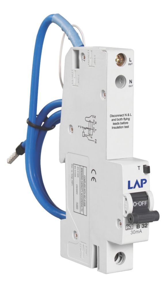

Old RCBO's were tall
60494_P
but many of the new ones are shorter
1959X_P
so may fit in your box, one shown is Screwfix at £24 likely you can get them cheaper than that, seem to remember that box is DIN rail so they may well fit, as to if strictly complying I am not too sure, and it may need some changes like the window cut for the switch section to stick out of may not line up, or the bus bar may not line up, so personally I would fit whole new box, I really don't care if Part P allows me to change the MCB to a RCBO but says I need a scheme member to change whole box, common sense says change whole box.
