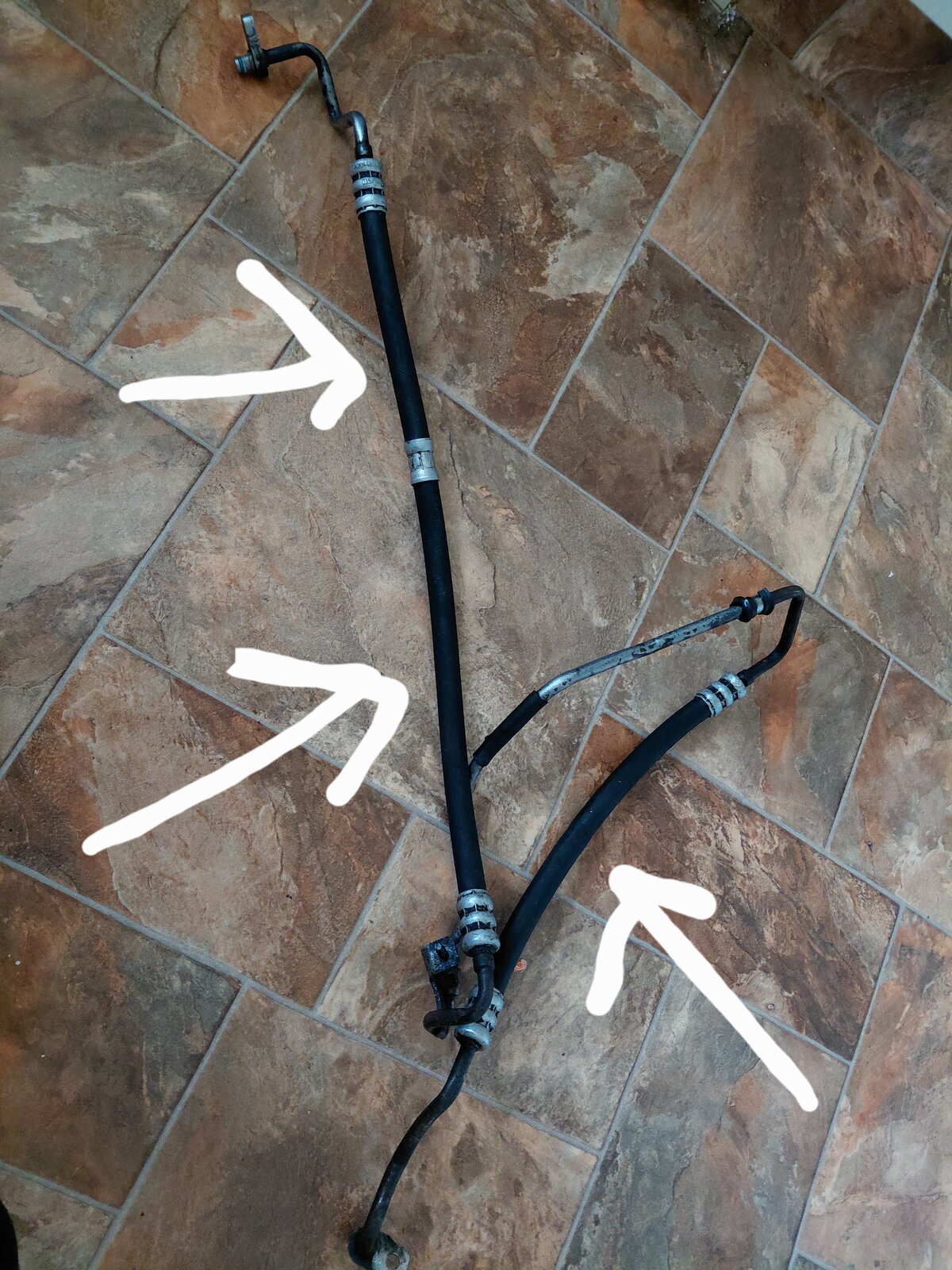

Can this power steering pipe be repaired ? Pics included
6 Jul 2025
56
Its a power steering pipe from my 2010 Mercedes-Benz e350 3.0 v6.
Its leaking from one of those sections arrowed.. can it be repaired or not ?

I had a pipe a bit like that, made up of metal and rubber sections, on an ac line in my van. One of the rubber sections had rubbed on an engine mount and worn a hole. It was going to be problematic and expensive to source the new line, so I sent it off to an ac specialist to get a new rubber section crimped in.
Maybe they can do PAS lines too. This was the company -
Any hydraulic hose company should be able to make you a new one, possibly even using your existing connections.

Thanks I'll check that out
