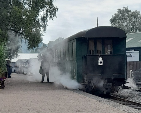

So this boiler 1663775568328.png seems to be wasting heat, but if it was not heating the carriages then the heat would simply be released into the atmosphere, so heating the carriages while at the station is not wasting a single Joule of heat.
