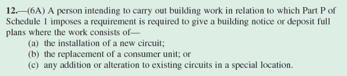

"regulation 12(6A) of the Building Regulations 2010 identifies notifiable work as comprising the installation of a new or replacement consumer unit, the installation of a complete new circuit connected to the consumer unit, or alteration work in and around a bath or shower."
Does that come from ADP? If the legislation said exactly that, I would probably have a bit more sympathy with your viewpoint but last time I saw the legislation, it still said ....
... stupidly, no mention of installing a new CU (only replacing one!), and no mention that a 'new circuit' has to be a "complete new circuit connected to the consumer unit"

yes, your 12 (6A) is the same one I looked at. The "summary" came from the a .gov guidance page. I later edited out the quote marks as it is not authoritative text.
12 (6A) does not define a change of OPD as notifiable work, therefore it is not notifiable.
As I said, some people would disagree since what the legislation actually says about "a new circuit" (in contrast to what your "non-authoritative text" said) is sufficiently vague as to allow various different interpretations.
To echo your words above, 12 (6A) does not define the installation of a new CU as notifiable work - so would you complete that sentence by writing "...therefore it is not notifiable"?

Consider a perfectly credible (albeit not very sensible) hypothetical scenario ... one has an old CU without any RCDs and wants to provide RCD protection for some of the circuits. One decides to install a new small CU, with RCD's, and transfers some of the existing circuits to that new CU, but leaving some (maybe cooker, immersion and perhaps one lighting circuit) still running from the 'existing' CU. One has not replaced a CU and, by your reasoning, has not created any new circuits - so, in terms of what the legislation actually says, the work would not be notifiable, would it?
However, this is a rather silly side discussion. I was merely trying to illustrate that this part of the legislation is badly written. They obviously should have (as in your other document) included the installation of new, as well as replacement, CUs. They also should have been far more explicit about what they mean by "the installation of a new circuit", so as to avoid uncertainties and discussions such as we are having. Don't forget that, as often discussed here, in terms of the BS7671 definition of 'a circuit', adding a FCU (and something it feeds) to an existing circuit constitutes the creation of a new circuit, and I don't think anyone really believes that they intended such work to be notifiable - after all, adding an FCU to an existing circuit was one of the few things that was not notifiable prior to April 2013 (and still today in Wales).
