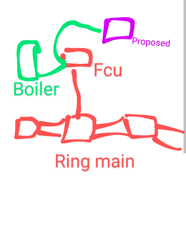

Hi guys. Got a fcu off of the ring main to then supply power to a gas boiler. Simple enough.
Im looking for a way to get an outdoor socket fitted in this area, and am wondering if i can put a cable from load side (so, along with the boiler flex) to the new outdoor socket.
I cant see a problem with it myself. Its protected by the fcu and the gas boiler hardly uses much leccy.
Tia
Is the fused connection unit a spur ,on a ring final circuit ? Is it part of a ring final circuit. Or is it a radial circuit dedicated to the boiler ?
A spur, off of the ring main.
Edit: ie see drawing

Likely the boiler - i.e. heating system - will have a 3A fuse; not much good for a socket.

Right! That makes sense, yeah. Would i be able then, to fit an fcu in the cable that goes from the existing socket to the existing fcu.
Edit:. Or. Probably easyer, to just cut into the ring main cables, fit a new fcu.

You can connect whatever you want, and as many things as you want, to the load side of an FCU, even if it is a spur from a ring final circuit.
However, as has been said, if it's currently supplying a boiler, it probably has a 3A fuse - so, unless the new socket would only be used for very small loads you would have to increase the rating of the fuse (probably to 13A) - and, as has been said, some people would probably believe/say that was 'wrong' (in relation to the boiler).

No, because you would then have more than one thing being supplied by one spur from the ring, which would not be acceptable if the spur was in 2.5mm² cable.
That would be the ideal.

Even with a total of 16A of fuses - which could be 26A in other circumstances?
Or you could upgrade the existing fuse to 13A to feed a socket and a second FCU with a 3A fuse for the boiler.
Or you could replace the FCU with a double socket and power the boiler with a plug containing a 3A fuse and plug the outdoor socket into the second socket.
Yes, I have to agree that such would be (electrically) OK - but., as you have said, it would certainly be at risk of resulting in "arguments discussions", particularly on the part of those who, obsessed with an ';informative' Appendix of the regs, believe/say that it is not acceptable for an unfused spur to feed two single sockets!
Good point. That would even satisfy those who like to argue!
Or you could replace the FCU with a double socket and power the boiler with a plug containing a 3A fuse.
Personally I don't see a difference between a double socket and 2 FCU's except the majority of double sockets are rated at 20A total and some only 13A.
