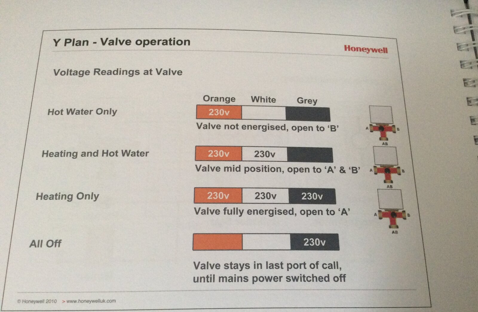

Hello,
Could anyone tell me if you can test a Danfloss HSA3 motorised valve when removed from the central heating system - by applying power to it? If so, could anyone advise how this can be done?
Thanking you in advance
Brown blue wires are mother grey and orange wires micro switch 240 to motor if arm goes across motor ok check other two wires if you get continuity they are ok. Bob
Sorry, bit of a novice and don't really understand. What do you mean by Mother? Thank you so much for your help-I hope I have responded correctly as I am completely new to writing on a forum and it is for my Dad!
What are you trying to test? Does this help at all? (Honeywell, but colours should be the same)
