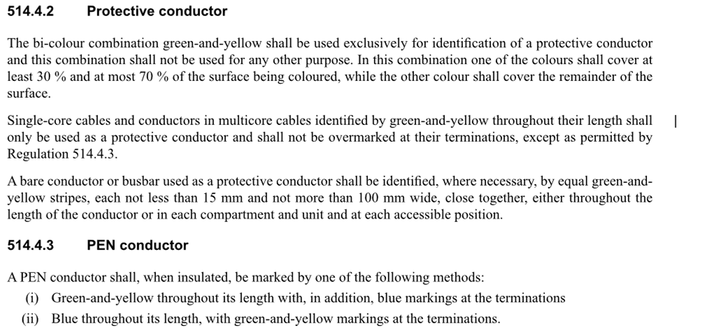

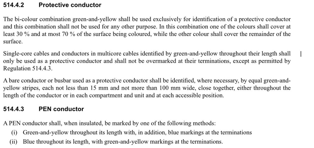

Just for you, to save you asking, I've included 514.4.3 too.
Thank you, I only hold 16th (2nd ammendment), in which the second para of 514-04-02 only mentions single-core cables giving rise to the ambiguous interpretation of the first para.
514-04-03 has slightly different wording, I wondered if there was more to it.

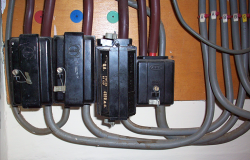

EDIT. Someone on here has phase markers at their cutout: Red, blue and green, it may be John.

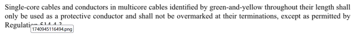

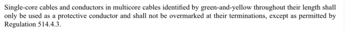

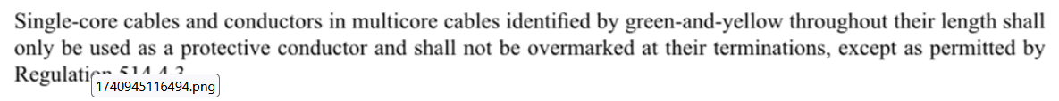

Thank you, I only hold 16th (2nd ammendment), in which the second para of 514-04-02 only mentions single-core cables ....
... and, as I've said, it remained like that up to, and including, the initial version of 18th (2018)
... as I've said many times before, in the many discussions we've had about this over the years, I personally see no particularly ambiguity. It would have made no sense for them to single out single-core cables for the statement prohibiting over--sleeving if their intention had been that it also applied to multi-core cables, would it? If they had intended the statement to relate to all cables (single- and multi-core) they surely would just have prohibited oversleeving of G/Y (without mentioing 'single core'), wouldn't they?
Yes, it is John :-).
Note the exposed inner insulation of the wrong colour in the neutral block (the evidence subsequently covered up with grey silicone by a meter changer :-) ). Nte also that when the tails get to the meter,they are labelled "A", "B" and "C" !! .... ....
