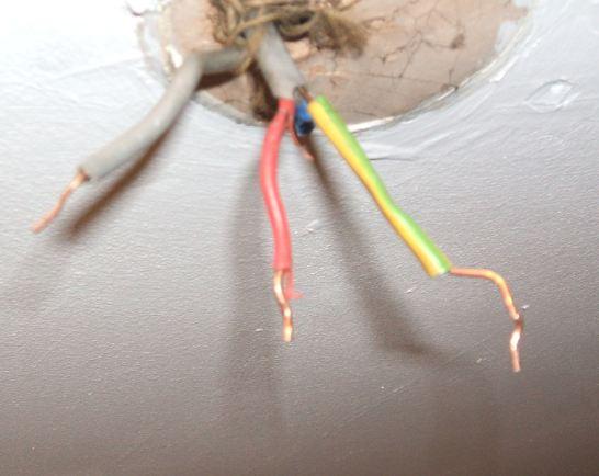

Hi,
I removed an ugly spotlight from my landing(which has a two waylite switch) the 3 wires hanging from the ceiling are earth, a grey covered one, and a red one. But on my new ceiling rose, the diagram shows I have to connect 3 reds,3 earths, and 3 neutrals!! Eh?? Thats 9 wires, but I only have 3 coming out of the ceiling? Cant put the old light back cos i dropped it and it smashed, and to make matters worse, my spare room light no longer works since I did this. PLEASE HELP IF YOU CAN!! x[/img]

Assuming this grey wire consists of just one wire, then this is neutral.
You may be able to see black insulation inside. This goes in one of the two holes along side the blue wire of the lampholder flex.
Red would be the live. This goes in hole along side the brown wire of the lampholder flex.
The centre terminal (loop) remains empty.
The earth wire goes to the earth terminal, usually a brass block near the edge of the rose.
Assuming I have understood your post correctly, and that grey wire doesn't contain any other wires, then I can't understand why the spare room light doesn't work, unless
you have the power off
have lost a wire in the ceiling space
have disturbed some wiring somewhere.
Work safely and make sure you isolate all of the power first.
Annette - you've got the opposite problem to the one most people face when going the other way, i.e. removing a ceiling rose to fit a light which only has L/N/E terminals and wondering what to do with 9 wires.
You've only got L/N/E, so connect them to the Live, Neutral and Earth terminals in the rose.
//www.diynot.com/wiki/electrics:lighting
You'll have to start tracing the wiring to the other light to find where the problem is with that.

There are no wires missing or disturbed,the loft is boarded and I only unscrewed the old spot
these are the wires on landing

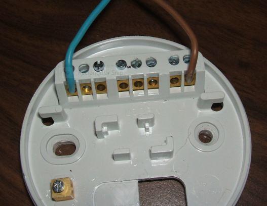

this is the rose

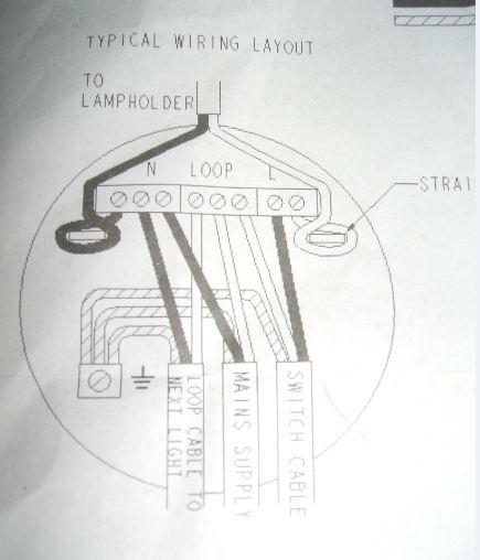

this is the diagram
it shows 9 wires to connect to the rose,3 green/yellow,3 black/ blue,3red/ brown. as i only have a grey,a red and a yellow, where do I put them?? :oops: I know the earth goes to the brass earth screw, but what about the others?
I tried putting the red in the middle of the rose,and the grey into the N with the blue rose wire, and the tried it in L withe the brown rose wire, but NOTHING!!
really appreciate any help. spare room lite not worked since I took spot down. DIY halted,feel like an idiot, :oops:
The diagram is not relevent to your house wiring.
With the wires you appear to have you do not connect anything to the centre terminal.
