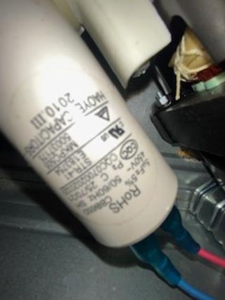

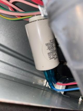

Hi, Im just looking to repair my Kenwood KDW60X13 capacitor which I'm hoping is why its only filling up with water and not starting. What I see inside is a CBB65D capacitor 5u 5% 450V. Not being able to find the exact match (CBB65D) I see CBB65 (metal) and CBB60 (pvc) mine looks/feels like pvc with a screw on the bottom for attaching (exactly like the CBB60 though else I would have jumped straight on the CBB65) .
Which one should I go for? Sorry for the blurry pics hard to get focus at the angle I had to take it at.

Not sure why it is labelled as CBB65 as
I would be going for a CBB60
For example one of these:
You need to see if your capacitor has spade connectors or wires.it looks like spades which will make it easier to remove and connect.
SFK
Ps. Orientation of wires (+ and -ve) on this type of capacitor does not matter. You can put either wire on either terminal.
