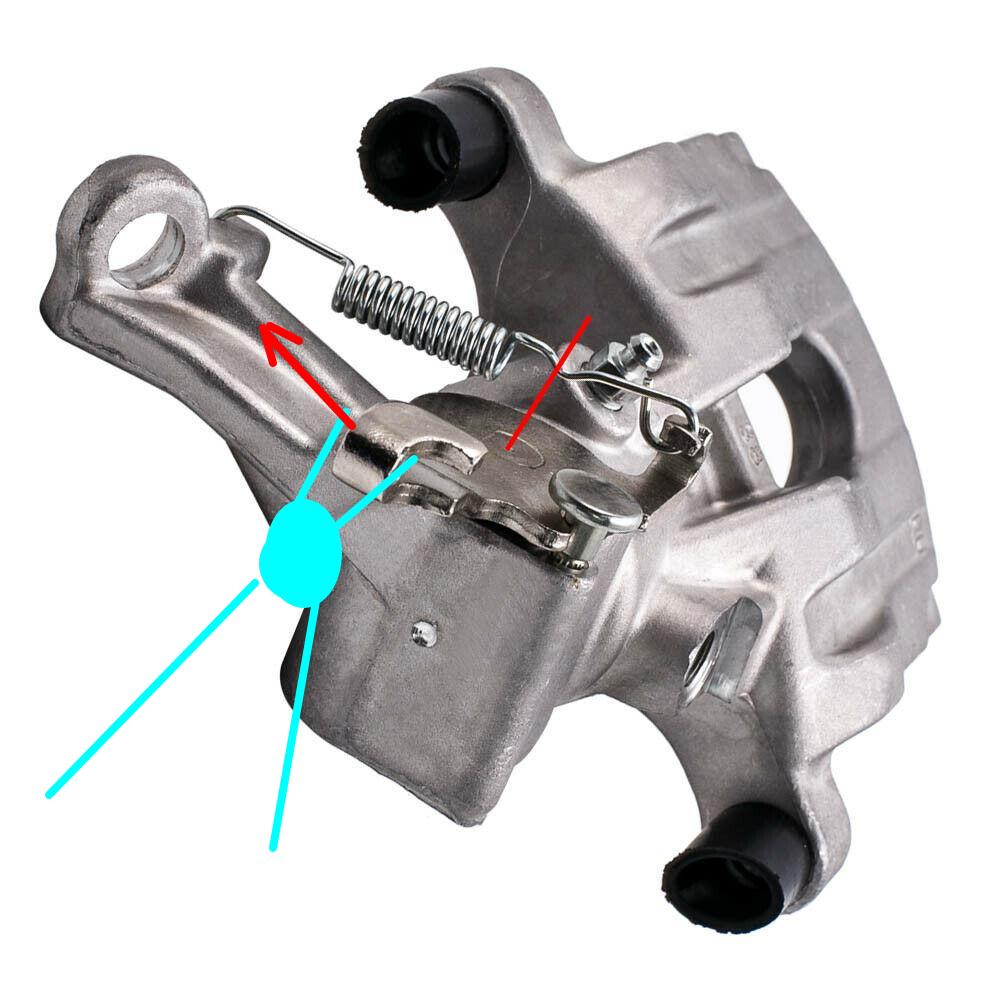

Car handbrake cable loose where it attaches to the brake caliper and not holding the car. video inc

Thanks, but I've replaced all the brakes almost a year ago and everything is absolutely fine with the brakes themselves. I'm referring bro the handbrake here

next thing you need to do is check how much travel there is between the pads and the discs.
if theres too much distance the handbrake will be rubbish......and tightening the cable will do no good.
the rear pads should just touch the disc when you rotate the disc. if they don’t , remove the calipers and unwind the piston in the caliper a small amount and refit them to check what it feels like, keep unwinding and checking until the disc just touches the pad on rotation.
If this is a foot/handbrake caliper, the adjuster mechanism in the caliper keeps the pads up against the discs. When replacing the pads, the piston has to be spun to retract it.
If the focus is on the handbrake and the cable specifically, then I take the cable off and inspect it. As for the caliper's handbrake action, work the lever with a set of grips.

Hi , the brakes themselves are fine they passed mot no problems, I drove after fitting new discs pads and calipers for months no problems with brakes , only after disconnecting the handbrake cables then attaching it again the problems started, the wheel would lock up and overheat but drove ok but the wheel wouldn't spin by hand
This is all after I disconnected the handbrake cable . If I hadn't disconnected the cable it would all be ok the cable must have seized and I only want to know can it be adjusted on these vectras with self adjusting Cables ?

When the cable is attached the wheel doesn't spin although it drives fine the brakes overheat badly. Even when the cable is attached but the handbrake is not applied the wheel still locks up.
One of the three cables [1], or the compensator is partially seized - thus holding the handbrake on once you release it at the handbrake lever in the cabin.
[1] Usually there is one cable from handbrake lever, to the balance pivot/compensator, then two cables one to each wheel. Sometimes the first cable it omitted, and the compensator is under the handbrake lever.

Wheres the return spring on caliper for handbrake lever[/QUOT
it's in the middle of the car in the compartment . It doesn't make a difference when it is attached or not and it sprung off a few times so I left it off.
it's in the middle of the car in the compartment . It doesn't make a difference when it is attached or not and it sprung off a few times so I left it off.[/QUOTE]
