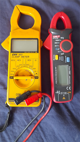

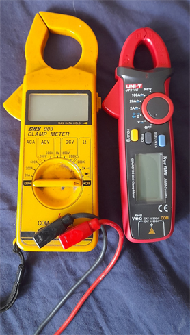

Can these be clamped to check leakage ,it's losing charge over a couple of nights
Do you know my wife? That's her all over, come and get these, and I have not a clue what these are.
My meter
will test DC current down to 1 mA, but to test DC it needs to be zero'ed, and that is only any good if the meter is not moved after being zero'ed, so not that accurate. These
also work with DC amps, 30 - 0 - 30 hard to read even one amp.
So a typical 40 AH (amp/hour) battery, as the name implies, can deliver 1 amp for 40 hours, assuming fully charged, so to last two nights, looking at 0.5 amp (500 mA) or less, the first meter could read that, likely could read 20 mA with reasonable accuracy, but the problem is to fully charge a lead acid battery to start with.

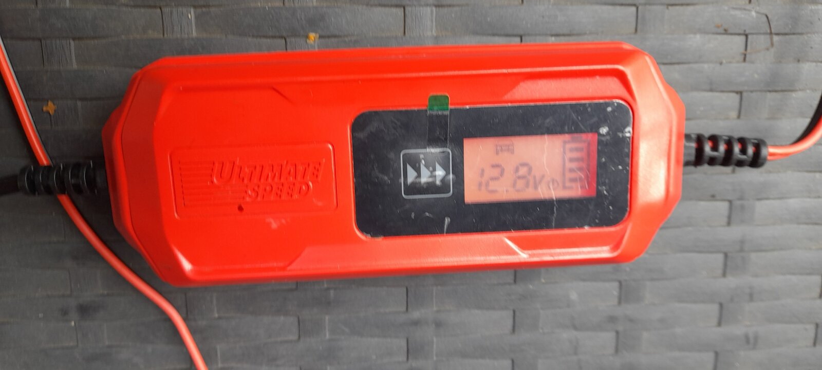

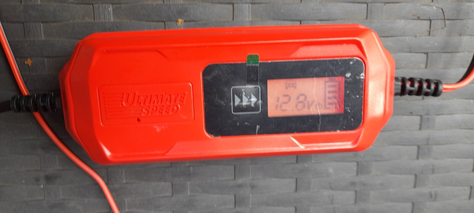

The special chargers Charger 5A.jpg will start at 5 amp, but will quickly drop to 3 amps, then 0.8 amps, and then 0.1 amps, and they tend to show charge complete when not really complete, when the battery has been discharged for some time.
Plugging one of those charges into an energy meter, it seems it uses plusses of charge, it will charge until 14.4 volts, then stop until 12.8 volts, then start again, and a fully charged good battery connected to a Jaguar XE when Colvid was with us, would switch on once a day at around midday, I assume it would send info to base at that time? So, fully charged will switch on around once an hour with a reasonable battery. It would need a day or two on charge to be sure fully charged.

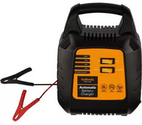

The standard battery charger 1767530553188.png found in Halfords etc, may say "Fully Automatic Charger" but reading further down the advert it says
so can't be used with VRLA or AGM batteries.
That to put it simple is a lie, it does not prevent overcharging, any way what are
The most reliable method, is using an amp meter, in series with one of the battery leads, and set on a suitable range. You should expect a discharge of around 10 to 40mA, 0.010amps to 0.040mA.
Much more than this, then you may have a phantom discharge problem, which needs to be traced. There is another similar, current thread, where this is being explored at the moment.
I have two clamp-on meters, Clamp-meter-small.jpg yellow one will not measure DC amps, red/black one will. I used these
for years, there was a version to measure start amps as well, but can't find it any more.
