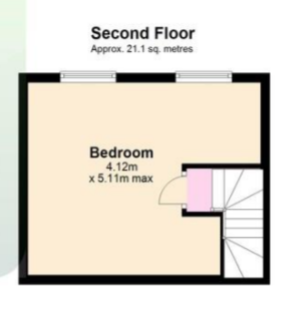

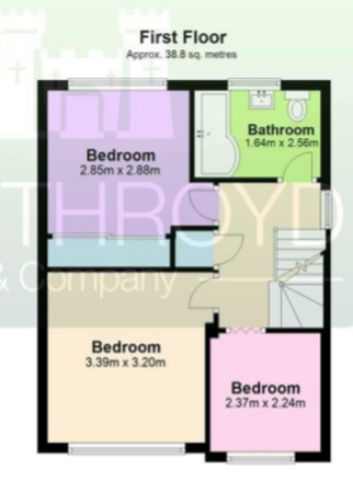

I've got a floor plan from when I purchased. The ground floor is laminate and won't be doing the bathroom. In the second floor bedroom that top right part on the picture is now an en suite so imagine there being a wall from the corner of the doorway along into the window (which i've shrunk down to a single window).
The landing measures 2.2m x 3m if you ignore the stair well. Both stair cases will be carpet.
The second floor max measurements now there is an ensuite are 4.67m x 4.25m.

Your floor plan, are you looking to measure St, Land, 3 Beds, Second Stairs and Top Bedroom?
Your brief landing size, does it allow for the drop over the riser?

I'll have a look at it a bit later for you, as you can see, there are no sizes for the landing or any of the stairs and you have a lot of winders looking at the floor plan.
As far as stairs go, whilst it's not unusual, it's also not a straight stair case. is the bottom step of the main staircase a bullnose step with one or two curved outside return edges of does the bottom step finish straight between the newel post and stringer?

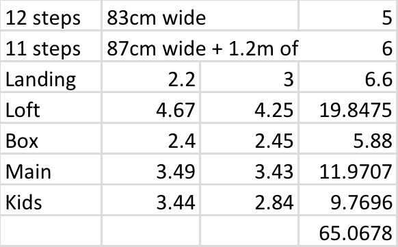

Interesting. I worked it out to be about 65 including the stairs. I wonder where we are different in the calcs. I added 10 cm onto each length from my laser measurer for cuts.
That is the net floor area, not the amount of materials you need to order.
As per my previous post, you have not taken into account the widths that carpeting is supplied in, the fact that differing widths will not colour match, pile direction, wastage allowance per cut and you probably have not measured the stairs and riser drops correctly or planned any of this out on plotting paper.
