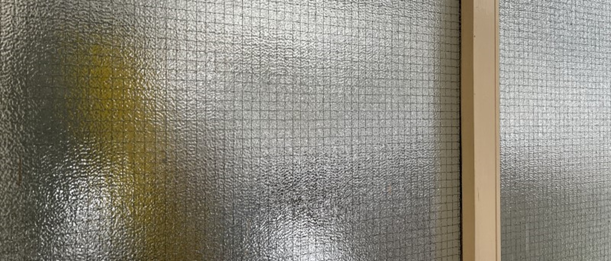

It's still being fitted as safety glass. However it is no longer considered suitable as fire resistant, so should not be used where that is a requirement.
Well seeing as I deal with glass every day
.. my glass wholesaler.
It is no longer a safety glass in obscure ( cast ) form, clear ( polished) is however . It is correct it also isn't a fire rated glass. A lot of misinformation regarding Georgian wire cast ( obscure ).... think I'd rather trust the manufacturer ! ( Pilkingtons )
