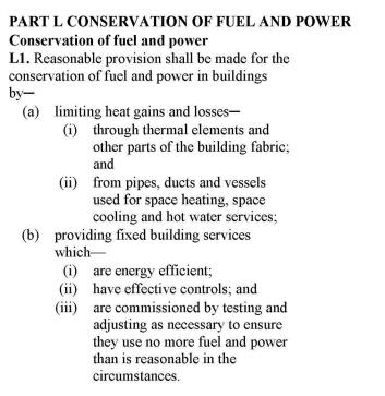

The section L part that Denso kindly provided definitely says "reasonable provision" so that one is not mandatory. Anyone who interprets "reasonable provision" as meaning "this requires" is wrong.
I'm all in favour of conforming with good practice, of course, but you can't be fined or imprisoned for not doing it.
Like i say, the wording makes it difficult, at the very least, with many of the various sections to define right and not quite allowed.
Had a situation on site today where three of us each had a different view on whether something was compliant.
Common sense prevailed when the Site Manager said 'Fck it, it'll do, we hand over tomorrow'.
Actually, this is part L in its entirety
I incorrectly quoted the approved document before which is for guidance only.

Correct. Also it does say 150W is the total allowed. But this is not being enforced unless on new builds IIRC.
Can you link to an official document that prohibits installations over 150W?
Since it isn't in Part L that Denso kindly provided. You must be looking somewhere else.
And since this thread is about an outdoor cctv system I take it you aren't referring to internal domestic lighting.
