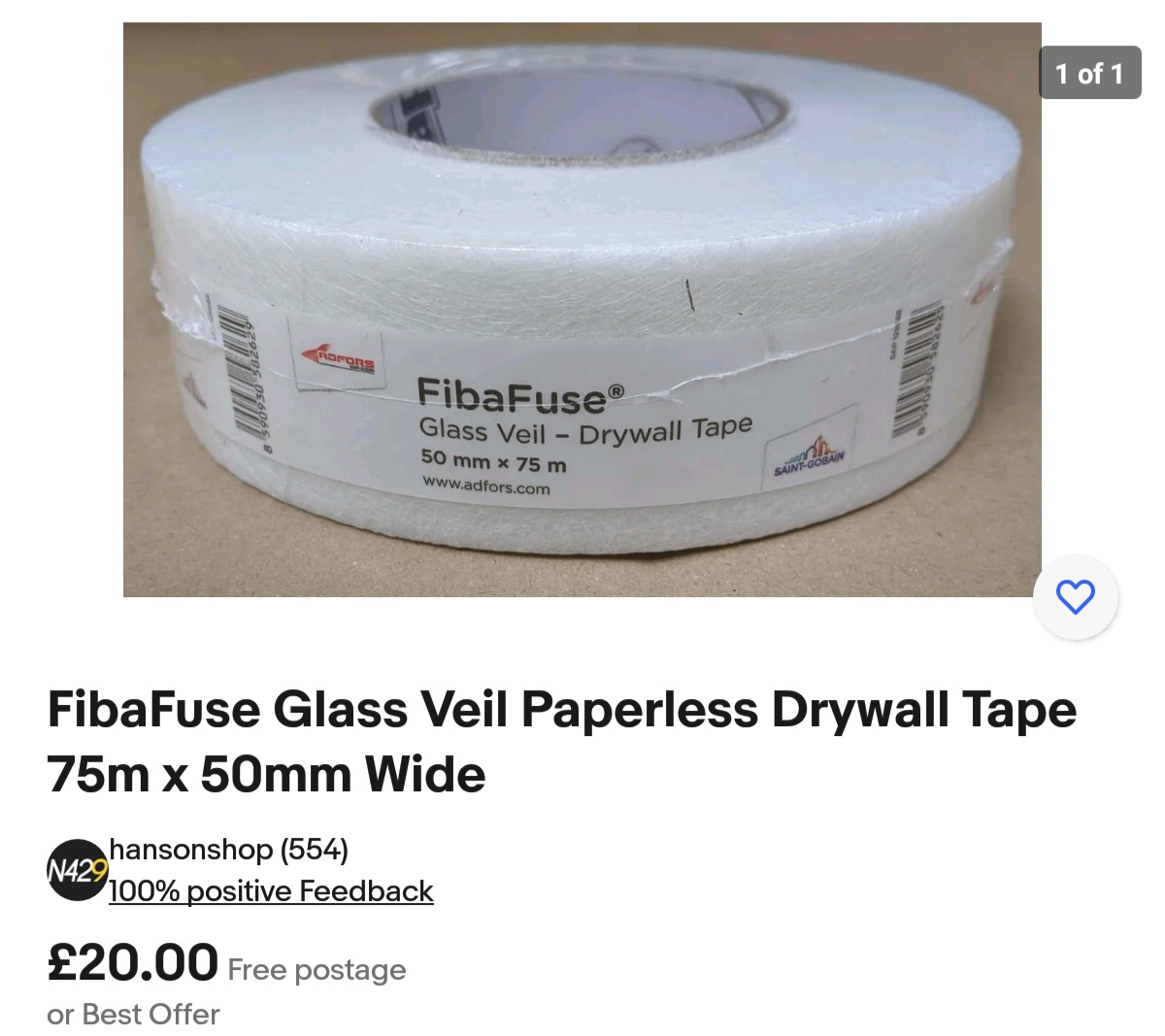

Hi Wayners! I'm getting the stuff together now for the crack (been busy with other things....) and you said "I use fibre fuse tape as yet to fail on me", well, do you mean this stuff called Fibafuse. as in the pic? Thanks again!
Yes. That's it.
I cut down to narrow the width.
Scratch back surface so tape sits below surface.
Set in filler

Rip the fibre tape out and replace it with paper tape look in my album there are some pics of me doing this about 8 years ago and no cracks have come back
Hi Wayners! Thanks for your advice! I managed to buy a scraper like yours from Brewers Decorators Centre, with a triangular blade, and fitted noggins and screwed up into them and into the joists. Used the fibafuse tape then filled with Troupret filler. Now a question about that filler: Can you 'polish' it similar to finishing plaster so you get a very smooth surface prior to paint or just rub it level and smooth with an abrasive, maybe wet and dry ? Thanks for your advice and pics! - getting that particular scraper locally was a bonus - all other scrapers were the 2 inch wide variety which would take an age to fill!
