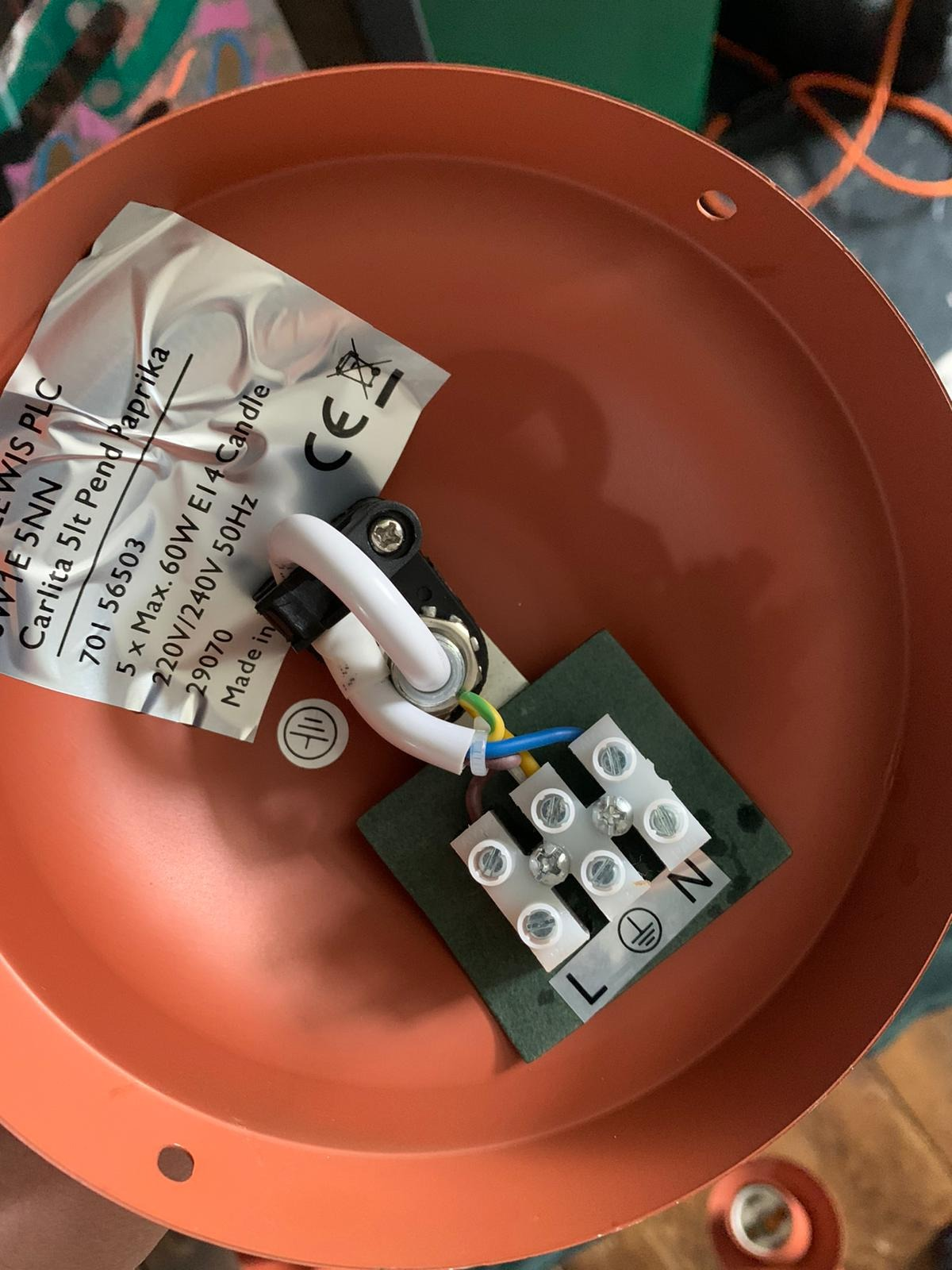

Replacing my ceiling light in the lounge and have taken the previous owners pendant down. to find that it has three sets of wires, like this:
My new pendant fitting looks like this:
Do I just bunch the 3 brown wires into the Live bit of the new fitting, the 3 blue into the neutral and 3 earth into the earth? I'm guessing so, but this has thrown me (particularly as one of the blue wires has a small bit of brown wrapping on it....).

You have in those three cables L+N+E in; L+N+E out and L+SwWire+E. The latter Switch Wire should be the one with the brown sleeving on it.
You will need an extra 5amp connector, for all three L (browns) to go into. All two N (blues, no sleeving) go to the N terminal of your fitting. The blue with brown sleeving goes to L in your fitting. The three E's (earth wires green/yellow) go to the E on your fitting.

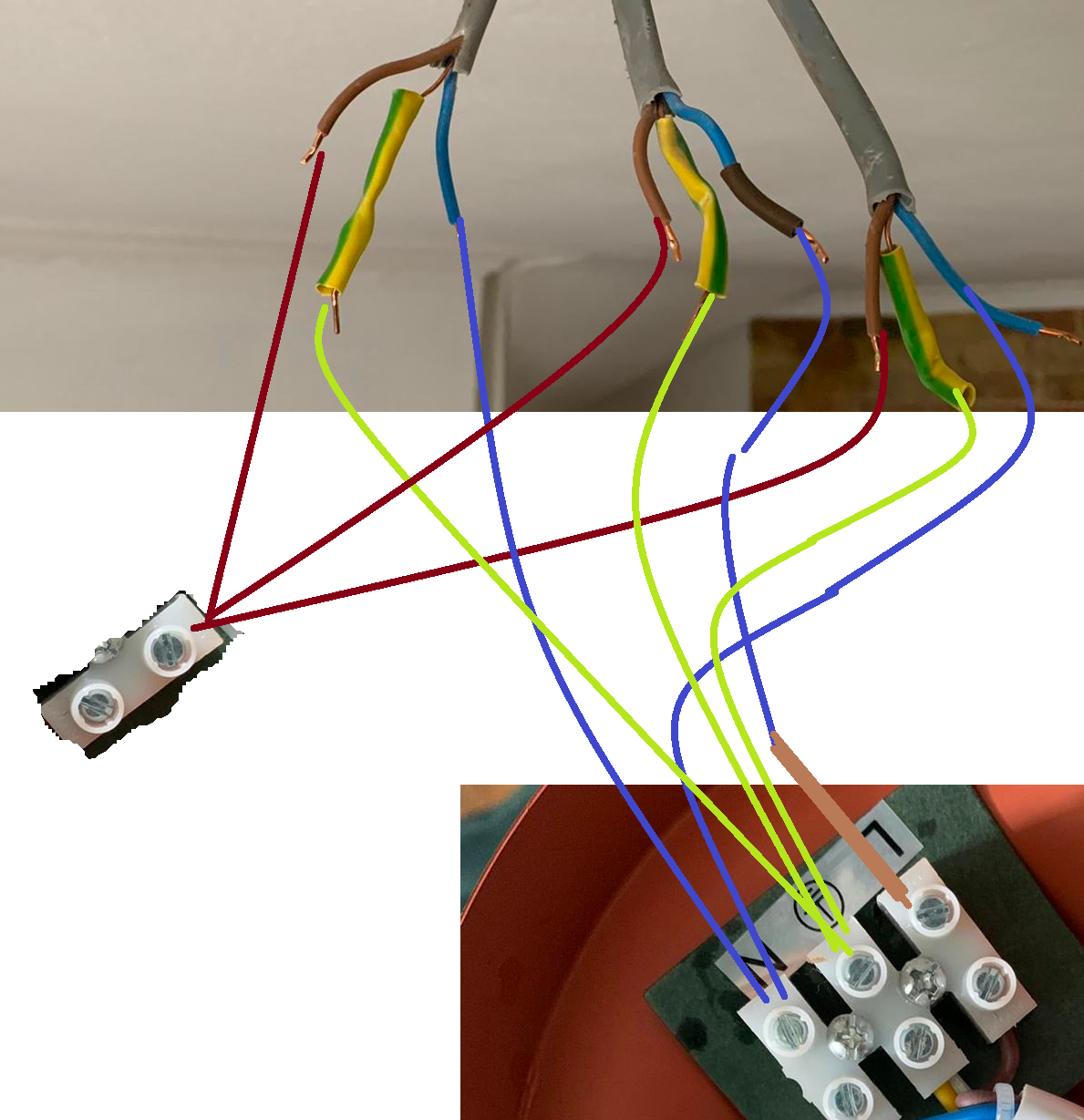

If you still feel you'd like to do the job the following 2 sketches show where the wires go. However I completely understand and applaud your comment about your skill level.
And excellent pictures, thank you.

You need to establish which of the three cables is the switch cable. Once you know that follow Sunrays diagram.
