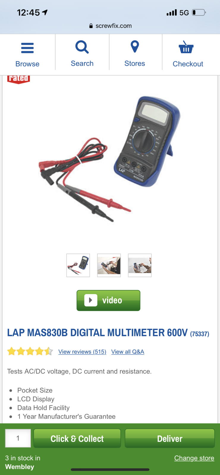

Does your meter have a continuity facility ,or any other functions ,or is it just a voltmeter ?
It is this one here
with the power turned OFF at the main switch, use the Ohms setting and test between brown and blue on each cable:
Before you take any readings, note what the meter shows when connected to nothing, and then touch the probes together and note what it shows when measuring a close circuit/dead short. It should show something like "-" or "-1--" when connected to nothing, and should change to showing a very small number when the leads are connected together.
Then you can test across the brown and blue on each cable.

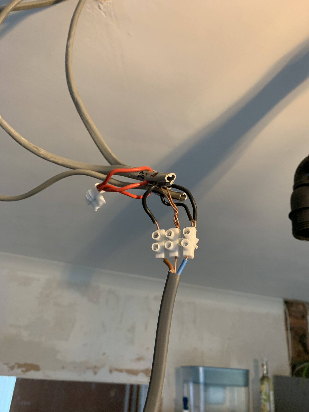

I have a very similar problem when i went to swap my main living room ceiling light. In total i had 3 wires. In each of those main wires i had 3 wires coming out red, black and green.
I had a spare bulb and wire connection so that i could check which one was live and which one was switch. What i found out is I had 2 live wires where the bulb came on.
Meaning i first connected the red and black from the main wire, the bulb came on. After that i connected the red and black from the second main wire and bulb came on. Later i connected the red and black wire on the last main wire and the bulb never came on, which means this is switch.
My only question now is why do we have 2 live wires in the rose ceiling outlet of a 1930 house ?

It sounds like you may have a LIGHTING RING CIRCUIT as opposed to a radial circuit.
One regular poster is likely to come on here and say they don't exist.
Well, I will not say they do not exist, rather that such a ring is entirely unnecessary and more likely to be an accidentally created ring by who ever wired it, or a later error.
It does provide single fault tolerance. One loose / broken connection can be tolerated leaving all lights functional.
People will say that a loose / broken connection should not be tolerated, provided it does not create a hazard it is preferable to the hazards of a house with some of the lighting not working
I'll agree they are generally not necessary but I've worked on enough to know they are not 'that rare'. The other thing of course is how many people actually test for and identify a ring? I know that I for one will ensure I can identify the switch cable, isolate and change a fitting without ever testing to see which of the loop cables is in or out. For that reason I reckon that 90% of the ceiling light fittings I've worked on could very possibly be unidentified rings and I imagine the same is true for many others on here.

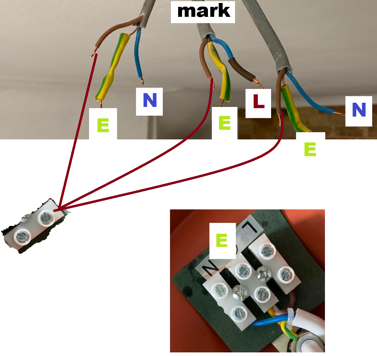

Can i suggest you mark the sheath of the cable with the brown sleeve before the sleeve falls off. Tape or pen or tippex etc will be fine.

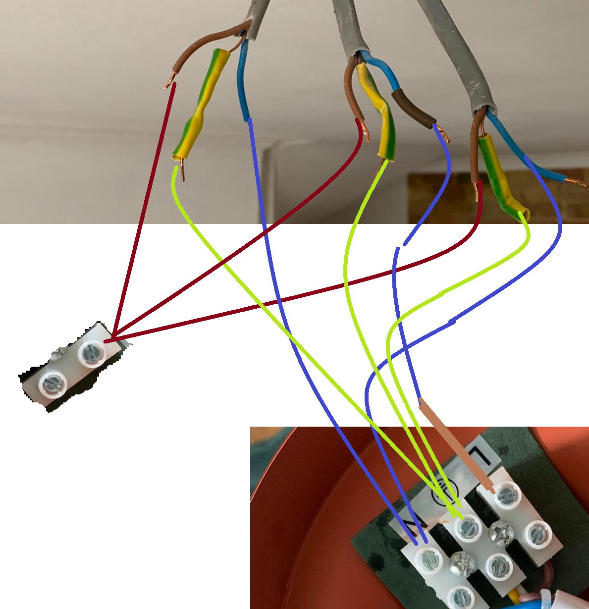

If you still feel you'd like to do the job the following 2 sketches show where the wires go. However I completely understand and applaud your comment about your skill level.
And excellent pictures, thank you.
OR
Thanks for the diagram. But where do the 3 brown (live) wires go to? What is the extra connector on the left?
