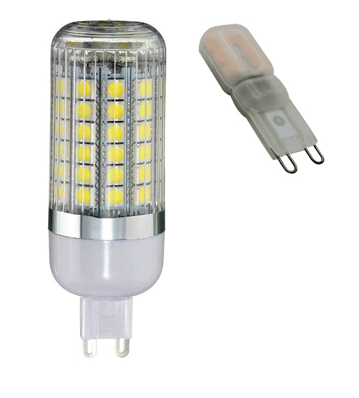

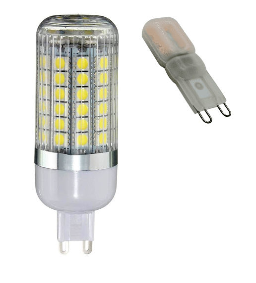

I have had problems with LED, but not failing these two G9-comp.jpg LED's are both G9 fitting, the large one has a smoothing capacitor inside nearly as big as the small one, so the small one flashed when switched off until a load capacitor was fitted, then shimmered when switched on, it was a well known make and complied with all regulations, and the glass cover would still fit when using the small LED. The large LED no flicker, brighter, did have one which had a dry joint it failed within a day, and repaired, they were cheap, no brand name breaks the rules by not showing wattage or lumen output, but work far better than the expensive smaller one.

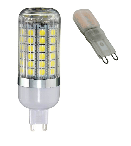

I have had problems with LED, but not failing these two View attachment 241588 LED's are both G9 fitting, the large one has a smoothing capacitor inside nearly as big as the small one, so the small one flashed when switched off until a load capacitor was fitted, then shimmered when switched on, it was a well known make and complied with all regulations, and the glass cover would still fit when using the small LED. The large LED no flicker, brighter, did have one which had a dry joint it failed within a day, and repaired, they were cheap, no brand name breaks the rules by not showing wattage or lumen output, but work far better than the expensive smaller one.
