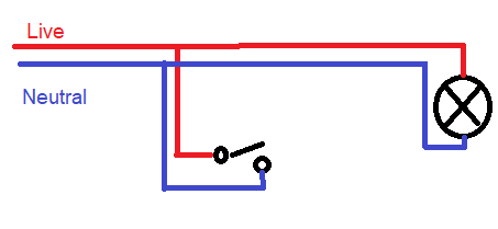

You have probably wired it like this
Neutral does not connect to the switch
post some images of switch and rose

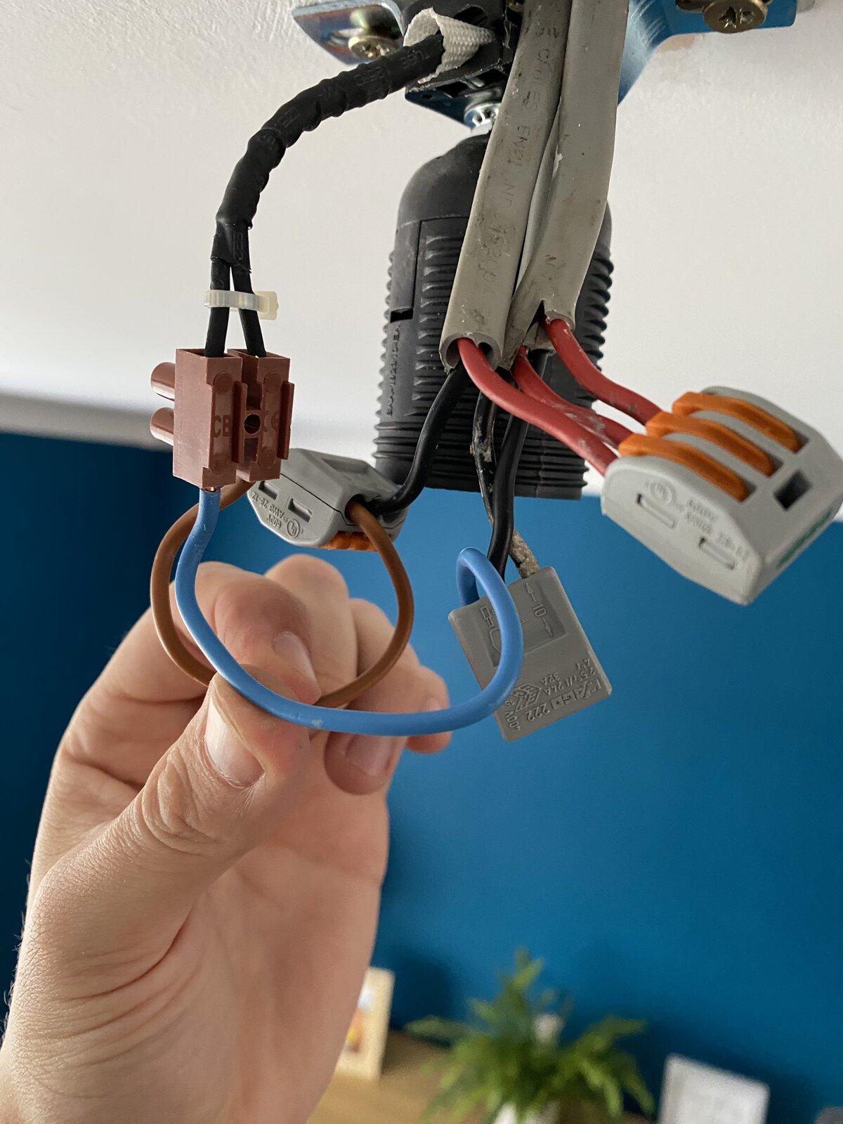

I have a picture of the light fitting but not of the switch at the moment. Had to improvise with wagos as cabling was old.
I have a multimeter yes and have used it before but was a long time ago so would need to refresh memory.

did you take a photo of the old wiring at all

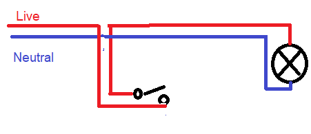

this is what you have - the switch colours could be changed for all reds and not 2 reds 1 black

I think the cable supplying the light isn't the cable feeding the switch. It must be One of the other two cables - which is what Bernard implied.

No - one of those Reds feeds the switch - if you've mixed up the one feeding the switch with a Feed that's why it's going pop when you short it out. You need to remove them from the Wago and find out which of those three wires is feeding the light switch preferably with a meter. Then the relevant switch live feeds the light. Have you got at least a voltstick?
The black on the right looks a bit 'manky'
Switched live should have a red marker on it. Is it the remnants of red insulating tape?
