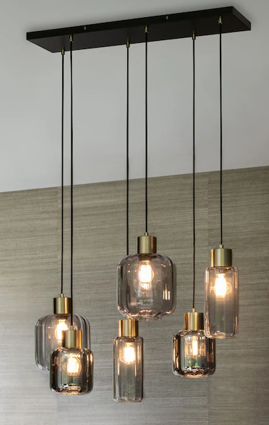

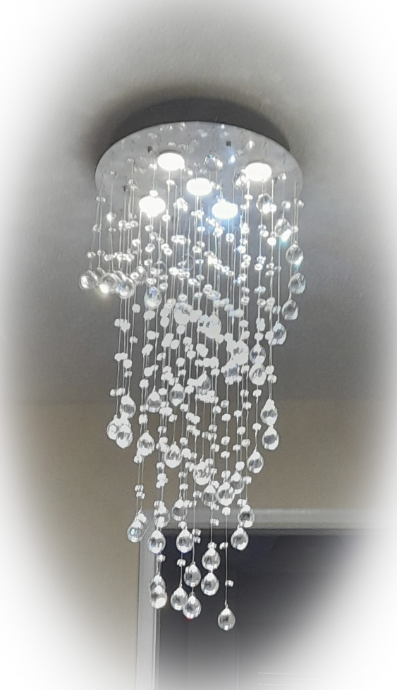

lamp-landing_1.jpg I have centre independent to the 4 outer lamps, so 1, 4 or 5 lamps on. Easy enough centre lamp a smart lamp outer on the light switch.
When my grandson was tiny, my daughter had a multi dangling light on the landing, very loosely following this sort of description
It was something like 12 SES fittings on a large rounnd chrome plate, rather fortuiticely one fitting had been dameaged during fitting (my son in law at the time could f++k any thing he touched) and the wire had been pulled right up tight (they were designed to be adjustable) leaving the broken bulbholder. Once removed it left a hole about 10mm in the plate. She was very happy with a pull switch mounted in the hole controlling one pendant completely independantly of the rest
