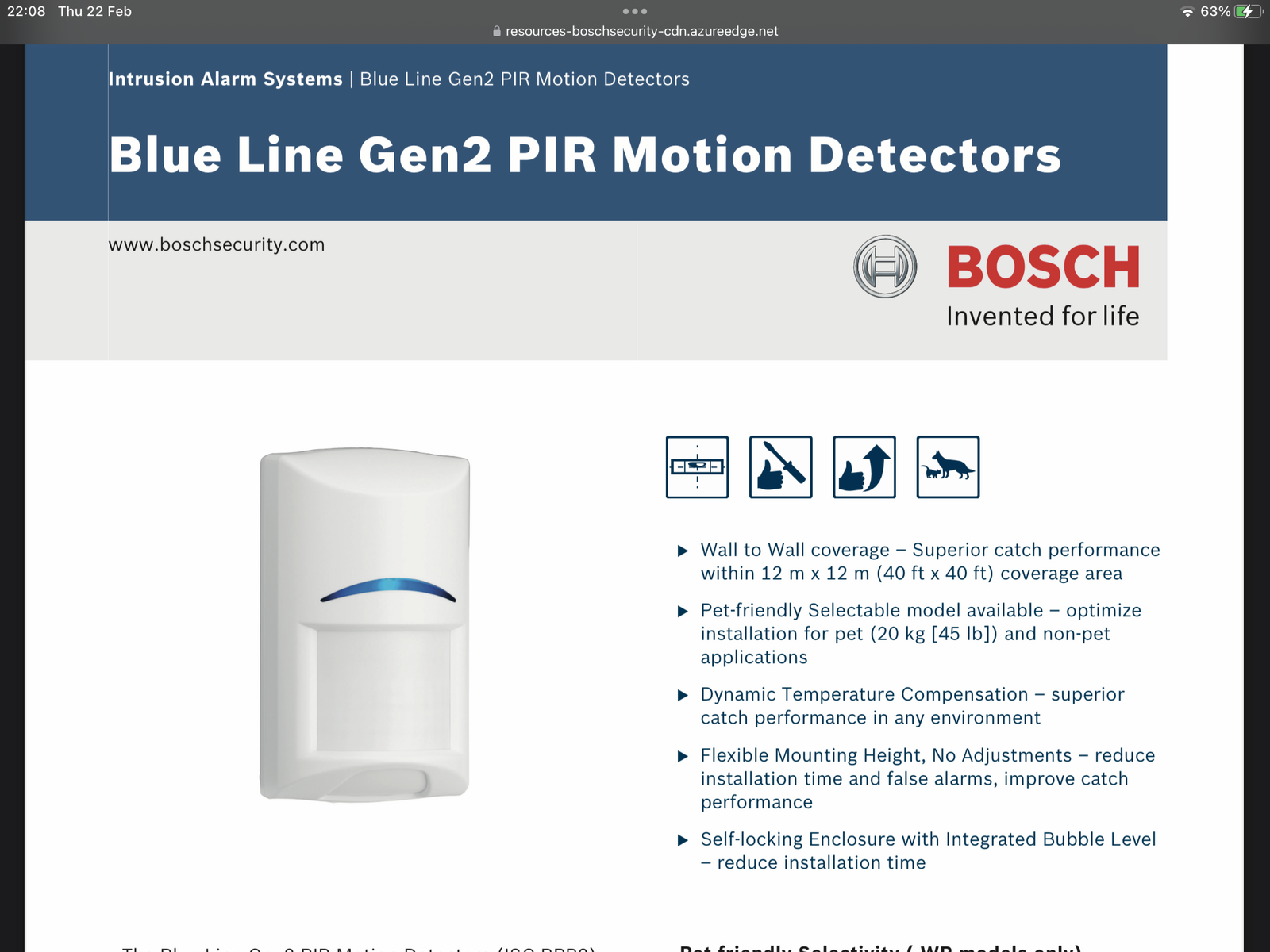

Anything better for pet-proof PIR that we could recommend here? I guess it doesn't have to be Texecom right?
its hard wired so you can pick anything.
we dont recomend pet tolerant sensors but see above for the recomendation.
From my experience these or the RX40 pt are the only ones I would recommend ….but again correct position is required and masking of areas can help , without seeing the layout of the room it’s a guessing game

By the way we had 2 cats now 1 and the RX40 Pt ( now not made but still available in limited numbers ) have been faultless and still give good coverage unlike other devices eg visonic and texecom older pet pirs , have fitted many of the Bosch piirs and had no major issues
