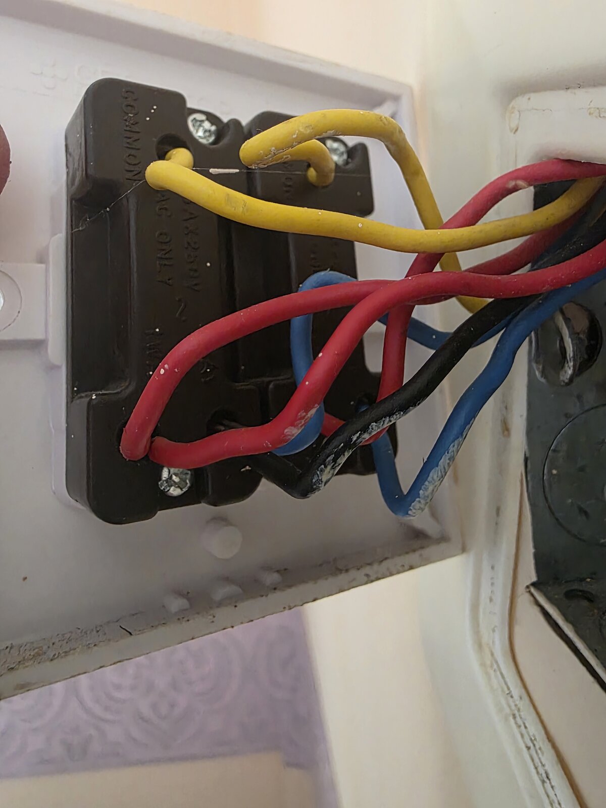

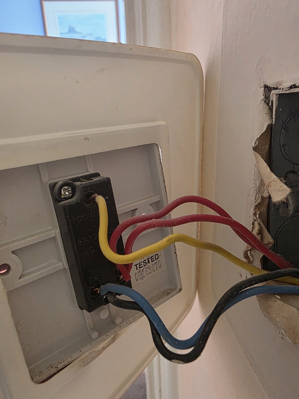

Ceiling rose wiring
As you have noticed, we could start an argument in an empty room on here!
I would identify the supply red and move the strapper red to COM in a direct swap with yellow and do the same downstairs, then disconnect the other switch and test.
I know the OP doesn't want to try and fix or make any changes, however this is incorrect advice for the record.
The downstairs also has 2 way switching. Yellow is being used in the COM terminal for the 2 way switching and yellow should likely remain there.
Upstairs light is being feed off upstairs circuit. It is a little dangerous, as it sounds like the upstairs and downstairs lighting MCB circuits can be linked when switches are in certain positions.

Fair point, I was going on the basis of a straight forward but mis wired two way switch. Slut made an assumption that we wouldn’t need to see the wiring at the ceiling rise so was never going to get a resolution to the issue.

The whole reason for this post was because I couldn't remember 100% how the wires were originally connected in the rose. My suspicion was the reds were connected together and the blacks fed the light. This was confirmed and this is how I have left it.
