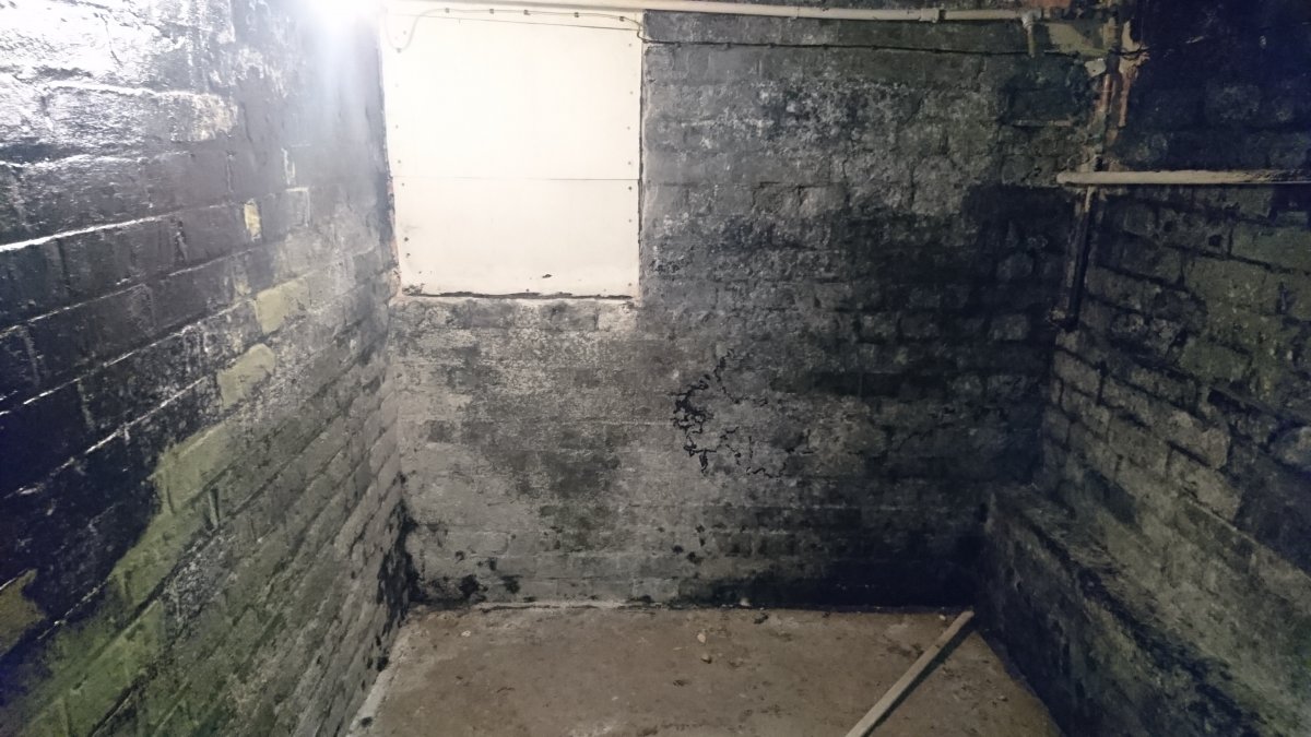

Hi

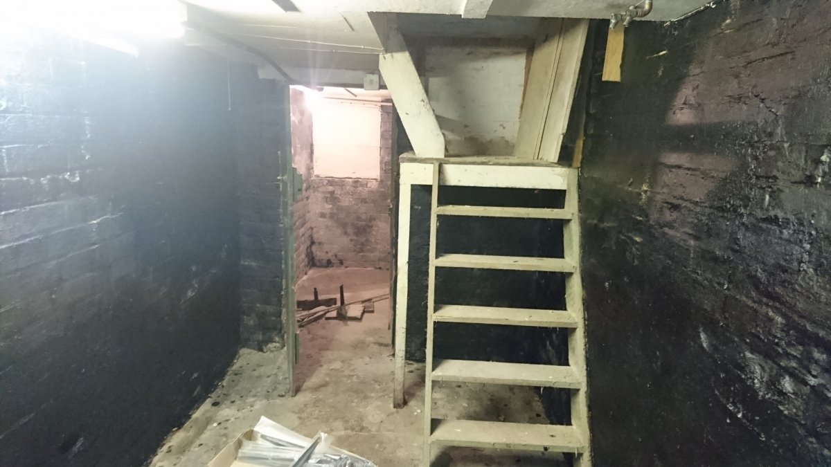

Short version - moved into new house with a cellar (one main section and then a small further section with outside wall). I believe it was an old coal a cellar.
Upon purchasing house appeared fairly dry. Took advice and bitchumen painted the walls to hopefully create a dry usable space. This was approx 8 weeks ago.

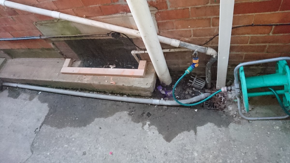

Since then there has been a lot of damp especially on the smaller section with the outside wall. In there the room has gone really mouldy on all walls but not the ceiling. There is some drains on the other side of the outside wall but

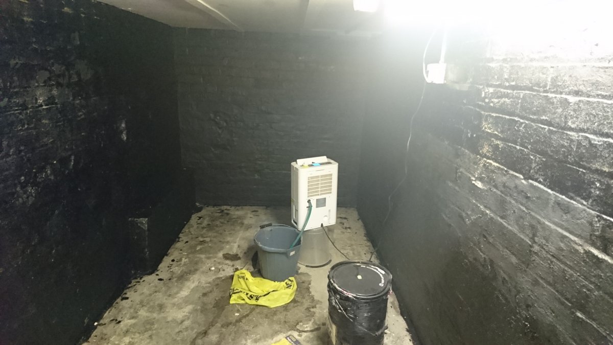

I left a dehumidifier on and it filled a builders bucket in 2 days and was still going.
There is no ventilation as the original chute has been boarded up so I was thinking maybe condensation could be an issue but seems an awful lot of water?
I have added some photos.
If anyone has any ideas or advice that could help, that would be much appreciated.

Painting walls and running dehumidifiers in a underground cellar will achieve nothing.
All cellars are damp and mouldy.
There are ways to convert them into usable rooms, but this will be thousands of pounds at least, five figures would not be unheard of.
Most people have better things to spend their money on.

The waste pipe for the sink was leaking causing the water on the outside on the photos. Fixed that but still have approx 2l every day from the dehumidifier. Seems very strange as it's been so dry.

2l of water per day from any above ground room would be about average.
Run your dehumidifier in an average above ground room for a couple of days for comparison.

Unfortunately, you've painted the bitumen on, so you can't determine if, or where, the damp areas are. The floor very likely doesn't have a dpm in it, and the walls will have earth behind them, but if you're lucky, it's dry earth, and so will the walls be.
The cellar will be colder than the upper floors, so the 2ltrs per day may well be normal, and you just need a low power fan at one end to take create an air flow, and take the moist air out.
But if the floors and the walls are damp, then you'd need a liquid dpm on the floor, and a simple screed on top of it, and another coat of bitumen on the walls, then sharp sand on top of it before it dries, then you can put a couple of coats of waterproofed cement on top of it.
