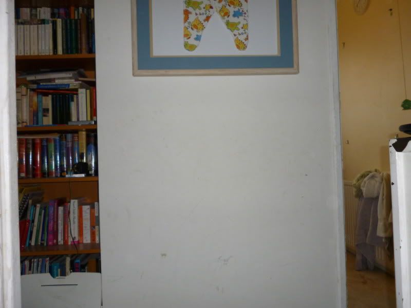

Want to alter a wall made of this, but not sure if it is load bearing at all. If I remove it, will it affect the ceiling?
I guess the ceiling is supported by the external walls and hangers in the loft. All my internal walls upstairs are dry wall or cellular, no solid walls at all.
Want to fit bigger bath in: this is what is under one end of the bath (the other is on a solid wall).
Trouble is, to the plasterboard behind the wastepipe is 1800, so need to extend the wall onto the landing, I think...
Also want to move the door:
Inside bathroom:
Outside bathroom:
The sink is coming out, the doorway to replace it. A shower is going where the door is at the mo.
If I alter this wall, will it cause any structural issues?

The plasterboard you see under the bath is the divider between the bathroom and the landing.
In the picture, the bath is on the other side of the plasterboard behind the bookcase.
I could build out the wall and lose a fraction of landing and the bookcase would not encroach because it is in an alcove.

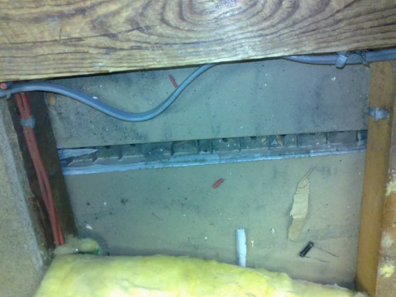

OK. Have now taken a couple snaps.
The first one is of the bathroom/landing dividing wall, looking down from the loft.
The second is a shot of part of the loft, giving you an idea of the construction of the roof.
I have consulted my book of construction techniques and it seems my roof construction is not in there, or rather it is, but it looks like an amalgamation of several techniques.
In the first shot, you see a timber across the picture. That's a binder running the full length of the loft, from front to back, one of several. There are purlins, too and a ridge board. My book illustration of a double roof is similar to what I've got, but in their picture, the binder is supported by a load-bearing (solid) wall.
My roof also has several A frame supporting structures in the loft, which don't appear in any of the illustrations in the book.
Are these cellular walls load-bearing or not?

What's the gap between the plasterboards, look like egg-box type ?
Similar.
Here's a piccy of a section of the filling of the plasterboard sandwich:
Look back at the picture looking down on the wall in the loft: those holes in the carboard squares are what you see.
Ahh! not seem them for a long time, called Paramount dry partition and some of them are called honeycomb partition mostly for office/banks room dividers.
Plasterboard panels (Paramount partitioning) are slotted over timber framework. The panels consist of two wallboards bonded to a cellular core of resin-impregnated card. The timber uprights are likely to be about 3ft (910mm) or 4ft (1 .2m) apart and about lin (38mm) wide. The wall is 2in-2in (50-65mm) thick, lightweight and non-load-bearing.
More details here which will answer your question> http://www.insulationireland.net/hollow_walls.htm
