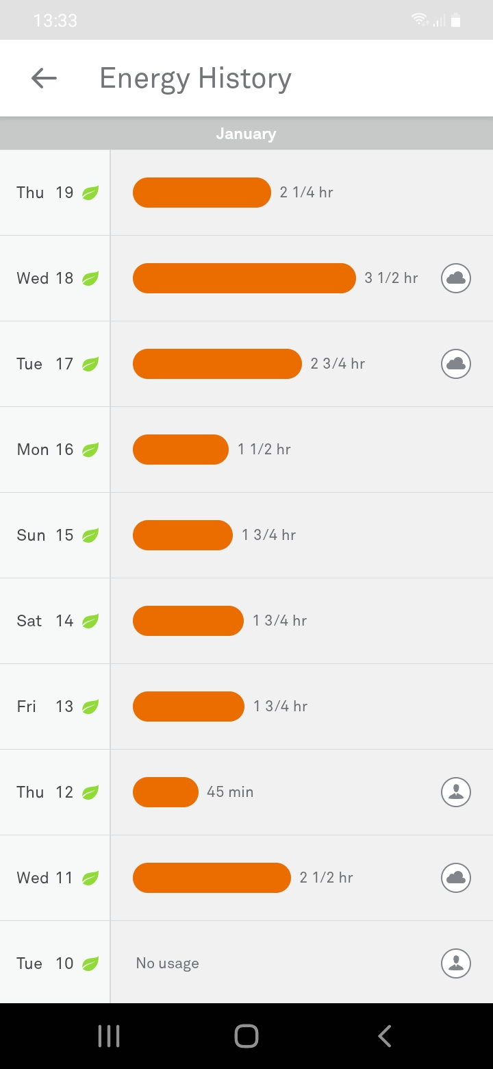

The problem is we get poor information. This report 1674176752835.png seems good, but it shows when my thermostat called for heat, not when the boiler was running, the same applies with a modulating boiler, it tells you how long it was running for, but not at what output it was running at.
Thanks Eric - just for comparison my call-for-heat time is substantially less:
But I have a non-condensing, non-modulating boiler, set continuously to 18°C. My boiler may be running continuously on full power for the entire time, whereas yours is modulating away happily!
As you say, these reports don't give adequate information.
