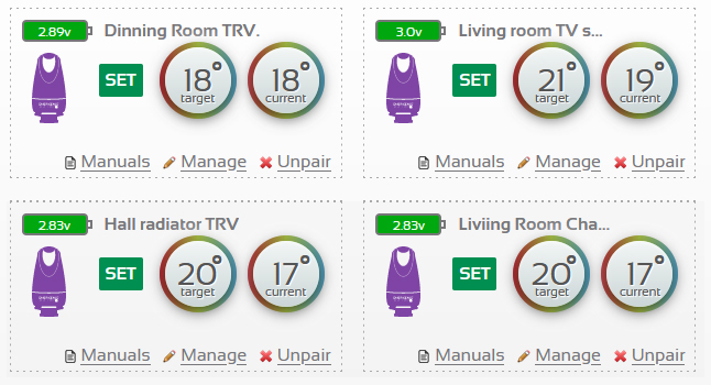

I found setting the TRV's in sequence can speed up re-heat, but it depends on timing, with my oil boiler if the on time is staggered on each radiator by 10 minutes I can get kitchen first, then dinning room, then living room, then hall, and a bigger gap before bedrooms, office and craft room is heated. And the hall has started to heat before the boiler starts to cycle, but increase the times to 15 minutes, and the boiler starts to cycle before hall starts to heat.
My pump is on the return, and I have no by-pass valve, it would not work with pump on the return, and I have found with micro bore piping there is no real need to trim the lock shield valves, the heat is reasonably shared between radiators, and closing the lock shield means more water thermo-syphons through the domestic hot water so boiler turns off early.
However this was not the case with mothers old house with a gas modulating combi boiler, once set radiators never got stinking hot, the boiler modulated to maintain the water flow at a temperature which maintained all the rooms at the temperatures set on the TRV's, the only problem I had was the anti hysteresis software on the TRV's was OTT, so set the room from 16°C overnight (it rarely cooled that much) to 20°C in the morning at 7 am, it was 11 am before it reached 20°C, so I would set to 22°C and then at 8 am down to 20°C and the room was at 20°C by 8 am. However this means geofencing would not really work with the TRV heads I was using.
I note the Drayton Wiser TRV head is claimed to have algorithms to work out how long it takes to heat the room, so with those TRV heads goefencing would likely work.
Without electronic heads the rooms can only be set to maximum temperature, on leaving mothers house the electronic heads were removed and the mechanical put back, however by this time the lock shields had been trimmed using the temperatures reported on the PC, 4 TRVs-1.jpgwith current and target reported it is easy to turn down the lock shield a tad if the current exceeds target, which with 15 mm pipe work it did to begin with, once set the rooms were spot on, except when the sun through bay windows caused the temperature to raise, and when the mechanical TRV's were put back on, the rooms continued to be spot on with temperature. Though of course took longer to heat up, as heating all rooms together.

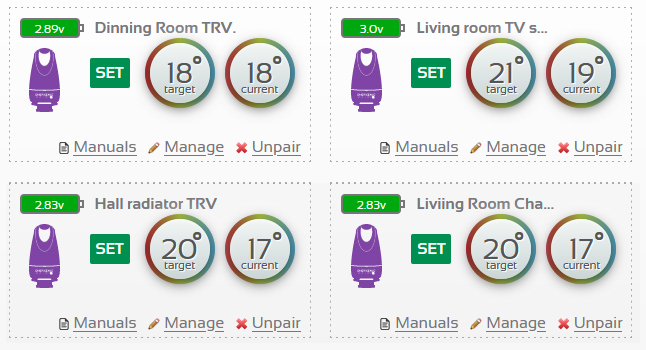

I added a further 5 electronic TRV's in this house, cheap enough at £15 each in 2019, I do change batteries annually although they will last two years, but then I forget, with a discharged battery they are designed to open.
I keep pointing out in last 10 years I have lived in three homes, and each one was different, so to say the answer is electronic TRV's may work with one home, but be useless with another, the did work far better with the gas modulating boiler to with this on/off oil boiler. But also moved from 15 mm pipe work and by-pass valves, to micro bore and thermo syphon. And with three floors, and 14 rooms, turning off rooms not being used is far more important than with mothers house with only 6 rooms, where the kitchen had to double as a laundry room. Here the laundry room is not heated except by the washing machine, dryer, and press.

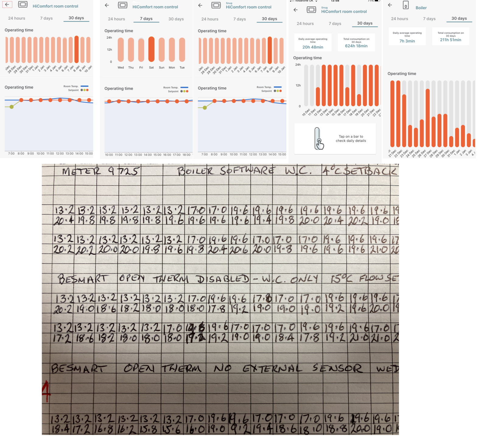

This is a rehashed post from a gas group I belong to, I did this from the 7th Jan to yesterday. might be of some interest. Using the new pre-production server and wi-fi gateway but the old BeSmart room control.
Control system comparisons​
There are often posts from customers and installers showing a snapshot of the performance of their new boiler and or controls system and sometimes a comparison of the fuel consumption of the previous system to that of the consumption of the new boiler or controls combination.
These are all well and good but they’re either a moment in time showing textbook settings to praise or criticize a new or favourite boiler, heat pump and control but omit other details so it’s of value but certainly not definitive. In all fairness is they’re not claimed to be, just customers or installers showing the results or favourites.
Here is another non-definitive showcase but it’s a comparison of control regimes in the one property with the same occupants the same boiler and across several days of similar weather but with different control regimes to illustrate, or try to, the performance of different control systems.
Once installed a heating system has two main items of importance, comfort and cost so I recorded each
Each configuration ran firstly for two days then the following week the same configurations for 24 hours as a sort of double check to see if there were anomalies.
The actual amount of natural gas consumed is unimportant as that would change from property type to property type but the percentage increase of one configuration to another from the lowest is the best comparison.
Also comfort levels; each hour the target and actual temperatures were compared and recorded.
Configuration 1: Weather compensation using internal boiler software only operating at two temperatures, a comfort and setback, the setback being 4°C lower than the comfort level.
Configuration 2: Weather compensation using an OpenTherm control with no internal reference so the OpenTherm WC software was the WC control, not the boiler. The setback was not a room temperature target but defined by the reduction in the boiler flow temperature of 20°C (I had tried a lower reduction in the first two day trial of 15°C with little effect).
Configuration 3: OpenTherm control using internal reference plus external sensor with three temperature levels.
Configuration 4: OpenTherm control, three temperature levels but external sensor disconnected.
Configuration 5: OpenTherm disabled and disconnected, the control operating as an ON/OFF control across the same three temperature levels.
I had to cancel option 5 as the ON/OFF relay in the prototype control wi-fi box was sticking and it was 24°C in the bedroom at 2am each time.
For comfort weather compensation was the most consistent unsurprisingly but also the most fuel intensive.
Most consistent was WC from boiler software but also most expensive
WC but from OpenTherm Software, less fuel intensive but very consistent
OpenTherm with WC combined, less consistent due to temperature changes and reduced fuel use.
More cost effective was OpenTherm alone by a margin but weather did ease slightly over the two days and consistency less than WC due to three temp change levels.
Frankly my choice, unless I care to do this again to confirm, would be OpenTherm with external sensor but limited to two temperature levels setback 4-5°C below comfort. The reasons for this are twofold, slight overheating of our sitting room with WC in the evening when doors closed watching TV, room control would negate this, something an external sensor and boiler software located elsewhere would find problematic and I would want to limit inconsistency caused by temperature changes to just two and not three.

Have you thought about getting smart TRV’s to control the heat in individual rooms? The Drayton Wiser, Hive and Tado control systems will allow a room by room level of control.
I have used mechanical TRVs for years with a oil fired boiler and they certainly do control the set temperature within quite reasonable limits as long as the boiler is firng "continuously", I can see where they may not work well with gas boilers that can't modulate (down) to the heat demand. A oil fired boiler cycles all the time but the flow temperature will allways be within the boiler stat hysteresis of say 10C, gas boilers on the other hand have a anticycle time which has to be long enough to get the flow temp low enough so as that it doesn't exceed its SP by more than 5C on firing up as all gas boilers to my knowledge fire up at ~ 60% output for stable ignition and must the be able to modulate low enough fairly rapidly to avoid reaching SP+5C and again recycling, Vaillants are or were even worse, they maintain ignition conditions for 60 secs bvefore allowing any modulation so the boiler temperature has to be very low to avoid recycling. Oil fired boilers fire up obviously at 100% but the Hx acts as a quite usefull 20/30 litre buffer. Gas boilers generally IMO havn't kept up with improved insulation, and zoning etc where the heat demand can go well below the minimum output of most boilers which is still ~ 5 to 8kw.
