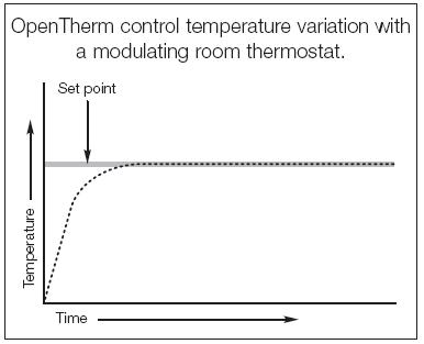

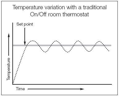

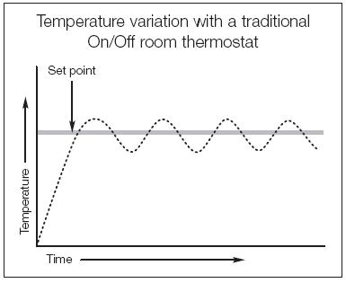

We can get modulating thermostats, as with the OpenTherm option, but in the main we use the TRV (thermostatic radiator valve) these do not switch on/off, but slowly open or close, these two graphs are to show advantage of OpenTherm Temp_variation_on_off.jpgTemp_variation_OpenTherm.jpg but the same applies using the TRV instead of wall thermostat, if the boiler is allowed to modulate, it will use less fuel.
Your boiler can go down to 8 kW it seems, so as long as you need more that 8 kW the boiler should not switch off.
As the TRV's close, first they force more though the ones still open, and then it opens the by-pass valve, and as the warmer water returns the boiler reduces output.
However this means timing the time between cycles tells us nothing, as we have no idea how much the output is, with a well insulated home likely heating 24/7 will not cost much more than for 16 hours, but a poorly insulated home it will, so all down to design of your home, not the central heating.

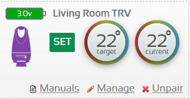

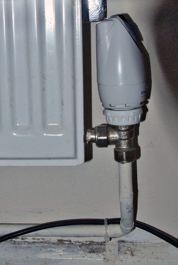

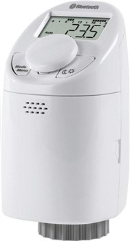

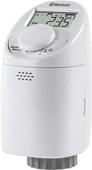

I also need the warmth for medical reasons, but find I simply can't sleep if too warm, so boiler does turn off over night. I have tried to limit which rooms are heated with programmable TRV heads EQ-3 Bluetooth Smart Radiator Thermostat.jpgthey were cheap enough £15 each in 2019, but cau'r drws (shut the door) seems to fall on deaf ears with my wife, and since I heat with oil, the boiler does not modulate, and once the boiler is not running, the TRV does not work. But with gas modulating boilers they work very well.
As to hysteresis the main control is the lock shield valve, any TRV takes time to open and close, and if the radiator gets stinking hot before it closes you will get more hysteresis, so it is important, but to be frank I used the other TRV heads IMGP8041.jpg far more expensive, although do the same thing, but link to the PC and shows TRV_report.jpg and if the current exceeded target I just closed them a bit, and in mothers house with a modulating boiler rooms were spot on.
However the higher you are in a room the warmer it is, so a thermostat on the wall at 1300 mm from floor will show higher than the TRV at 100 mm from floor, so often the TRV needs setting lower than a wall thermostat.

Many modern thermostats use an algorithm called TPI (or similar) to provide more accurate room temperature control. This means that once you get close to the set temperature, they start turning the boiler on and off in short bursts of a few minutes several times an hour, to keep the room temperature steady. I know from personal experience that this can sometimes be confusing. Do you know which brand and model of thermostat you have?
