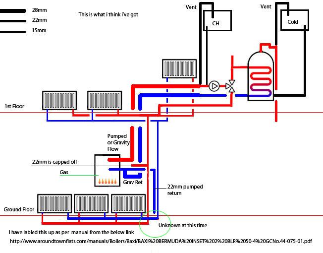

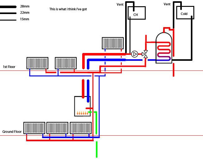

Hi all, back again, i called out an engineer to service my boiler, he took one look and said erm i think i will call my boss and get him to ring you, that was the last i heard from that company which i got from yellow pages. After doing this for over 4 months i was ****ed off so ive had a break, back now and have been over a load of tests and have done a proper diagram to the best of my knowledge of what ive got and what i think it should be. What i need to know is will what i think i have cause the boiler to shut down when CH only is selected.

The main question that has been asked is where is the return, if the 15mm pipes are swaped then there is the return. i have based most of the diagram on which pipes get hot 1st with pump running, so how far off am i or am i right?
Hmm, this thread is now 21+ pages yet it seems we are starting again here, you say you have done many tests but not told us what you tested or the results, then provided a very different diagram of what you think is your system :cry:

Bonkersbill, your first layout on the left appears to be wrong even if you traced it as best as you could, as it is, you are not going to get heating on with your hot water, which infact you said that you get your heating on when you run both Ch+HW. Secondly , if you said you have drawn it as best as you thought it was, by feeling where the hot water gets to first, then again it is wrong as we had already determined that your flow and return were cross wired/plumbed, whereas you have drawn them as if they are now what it should be. (all in yout left layout)

Hi, i have managed to get the fore off the boiler and as some of you have been wanting to know, the pipes arnt connected as i thought, but they appear to be connected like the baxi bermuda inset 2 manual shows.
The only part i cant confirm at the moment is what the 3 pipes are conected to under the grounfd floor, ive had 2 carpets up but brick walls have prevented me from getting to the underside of the boiler.
As for the tests, i have just retraced my steps to make sure which pipes are getting hot 1st, the pipe to port ab definatly gets hot before any other pipe including the pipe from the cylinder, so unless it can be explained how this is happening as a return, this must be the flow.
I have also tried my best to answer as many questions as i was able to in the best possible way i could, i have never thought that the 28mm pipes were the wrong way round though i have not discounted it.

He is almost there and the latest layout he posted on here reveals that a possible problem could be under the floor boards which he had circled, the 22mm pumped return should be connected to the return from the GF rads, and thi9s is where his problem may be, now all he needs to do is to lift his floor boards and get underneath to see what may lie there waiting for him.
until he can do this, we can all speculate, so its now better for him to first get some fresh air, take a little rest, start with a fresh clean head and remove all that is in the way, and check what is underneath as circled in his drawing.

Because it will tell you which pipe is connected to the boilers designated flow outlet as that will always get hot first on gravity circulation
