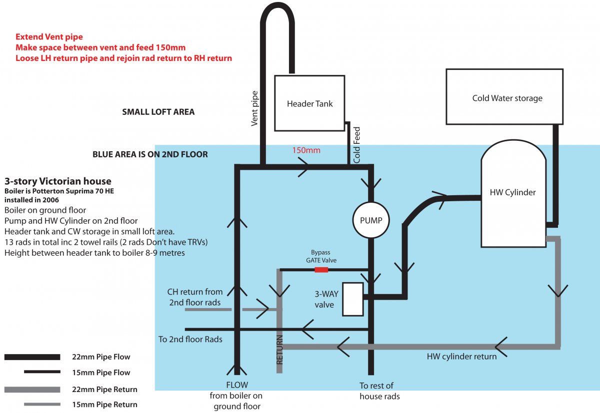

Hi There
I have had ongoing issues with my central heating since moving in 18 months ago.
The main issue was the ground floor rads being luke warm at best - particularly when the HW was on. Balancing didn't really help much!
Since Christmas we have been having boiler lock out issues that are 'ignition faults' and so with the numerous engineers that have tried to help and provide us with quotes - we keep getting different answers and suggestions to our problems. We are now not knowing what to do, other than try to understand out system and understand it for ourselves.
I want to get to the route of the cause and not just fix the symptoms - I think with some research I have done (and an engineer who is willing to try and help us through this), that it may come down to the pipework design up in our airing cupboard.
My notes below give a brief description of symptoms and what has been suggested by engineers and how to fix it.
We believe our system is fairly old and has lots of isolation valve scattered around so we are a bit nervous about doing anything too harsh to it.
Symptoms
A. Boiler is sporadically/regularly locking out
B. When pump turns on - vent sucks in air
C. When pump turns off vent spits small amount of water
D. When CH or HW on the cold feed gets very hot and
header tank water turns warm
E. 2 Rads on ground floor never get as hot as others
Obvious Issues
1. Vent and Cold feed too far apart
2. Vent pipe not 450mm above water line
3. Poor pipework design after pump.
4. No Balancing valve on HW tank
Other possible issues
1. Sludge in system - (Thermal image
suggests otherwise) Have tried Fernox F5
2. Cold Feed Tee blocked
3. Pump not large enough
4. Unbalanced system - have tried this
previous to Fernox F5 without much success.
I have drawn a diagram of the pipework - can anyone see anything glaringly obvious which could be causing lock outs with the boiler or flow issues to the ground floor?
Any help would be greatfully received.
Marrianne
Obvious Issues

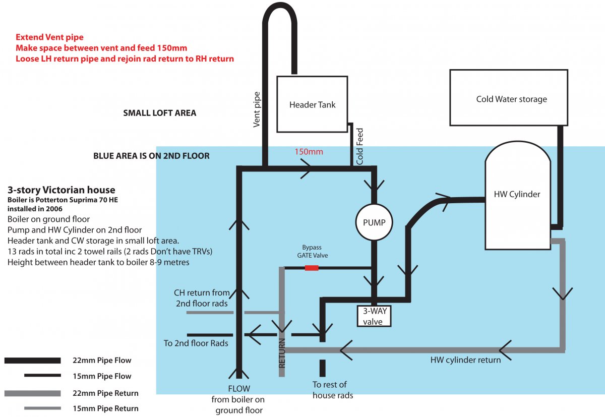

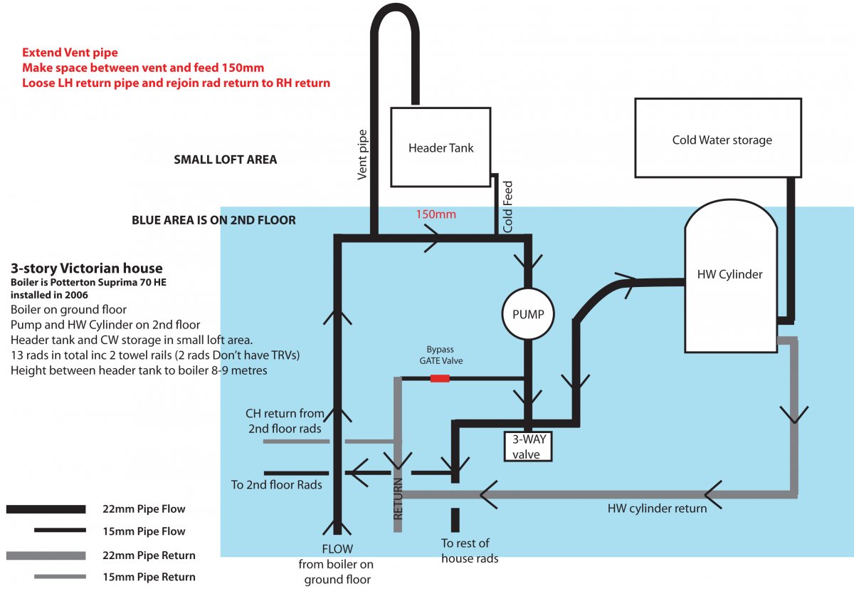

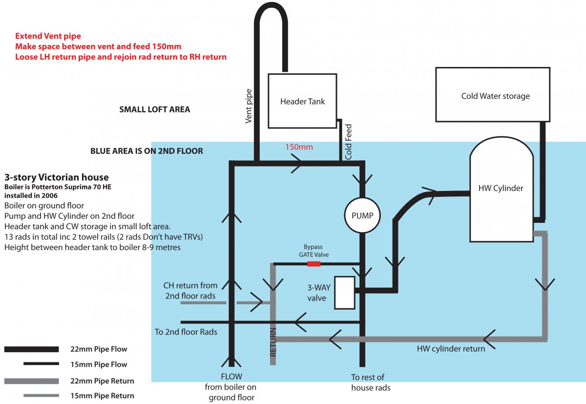

  1. Agreed. They should be not more than 150mm apart. Move the vent pipe connection nearer the feed, so it is teed of the horizontal pipe.
  2. It's the top of the bend which needs to be 450mm above water line.
  3. One of the arrows is pointing in the wrong direction! I have corrected it in red. The "isolation valve" is a manual bypass. This is not needed as you have a mid-position motorized valve, so it should be closed.
  4. This would be a useful addition.

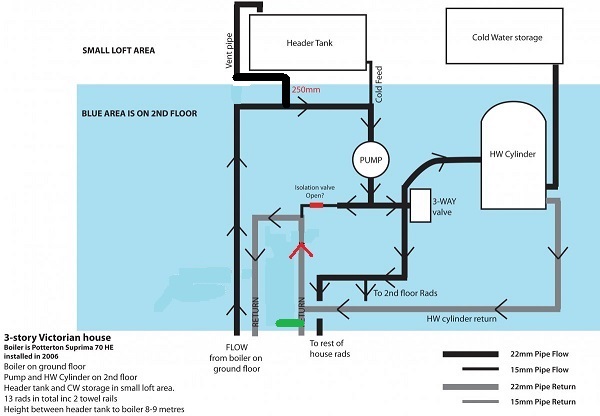

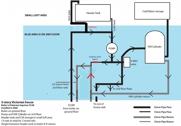

Thanks for your reply.
Do you think your suggested changes would fix the issues with the header tank?
I am still wondering if there is anything else stopping the flow getting down to the ground floor. Do you think a balancing valve on the HW cylinder and making sure the bypass is shut would make much of a difference?
Also the way the pump is plumbed to the system seems a bit odd to me. Having such a short flow pipe after the pump logically to me must be slowing the flow down - what do you think? Could it benefit from reconfiguration?
Attached a couple more diagrams of possible re configurations...
It will stop the over-pumping (water coming out of the vent pipe) provided the pump is set correctly.
Yes. As currently configured the bypass is a a direct short cut back to the boiler, so water will prefer to go that way, not through the rads. When HW and CH are both on, the cylinder will also act as a short cut, reducing the flow through the rads/
Also the way the pump is plumbed to the syste m seems a bit odd to me. Having such a short flow pipe after the pump logically to me must be slowing the flow down - what do you think? Could it benefit from reconfiguration?
That's not important - the T junction below the valve just provided a little bit of extra resistance to flow, which the pump can easily handle. If you want to change it, your diagram 3 is the better way. Don't forget that the feed from the pump must go to the centre connection (marked AB on valve); radiator circuit connects to connection A and cylinder to connection B.
What is the distance between the pump and the bottom of the header tank? If needs to be at least one metre.
What is important, and I should have picked it up earlier, is the connection of the return from upstairs rads, which is wrong. The last connection, before the boiler must always be the return from the cylinder. If it is not, as in your original diagram, you can get reverse circulation, i.e water travelling backwards along the return pipe, making the rads heat up when they should be cold. This diagram shows, in green, where the return should be connected.

The bottom of the header tank is about 1.5 -2 meters away from the pump. It's not directly above but slightly off to the right as it has all been wedged into a tiny space in the eaves of the second floor and the header runs up the roof line into the tiny roof space. It's pretty hideous on space which is what is putting off most engineers from doing anything to it.
In my original drawing the return seems to do some sort of loop at the top of the system is this normal? I am also not sure of which direction it currently flows around the loop - I only guessed that they were both going south since they are returning pipes to the boiler, therefore it could be flowing anti clockwise meaning the rad returns are in the right place?
