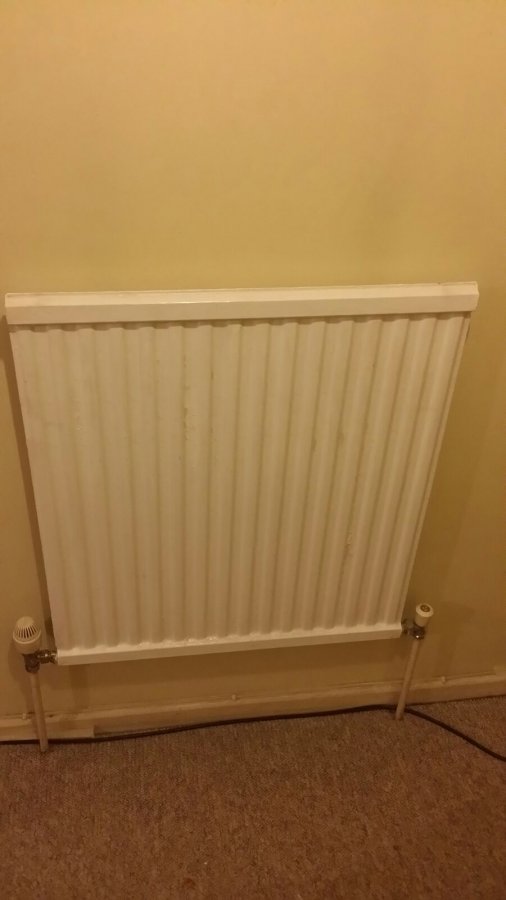

In my apartment the boiler (a Vaillant ecoTEC plus) wasn't working and someone came to fix it.
He opened the valve to increase the pressure and now the boiler is working again but the pressure is always on the "red" region.
Is this safe ? I do not see any radiator air vent to open (see image).
What should I do ?

Reduce the pressure out of the red zone by opening a radiator bleed valve - it may take a while, and catch the drips!
On this rad, the valve maybe at the back but its standard size.

Ask who? The person that came ? He wasn't an expert, but only a friend of the house owner and when I saw that the pressure was too high, he didn't know what to do either.
The pic of the radiator is to show that there seems not to be any valve.
I do not see any on the back either. Is it possible that these radiators do not have a valve? They seem pretty old.

There is also a valve at one end of the radiator.
Andy
It will have a bleed nipple. On one of the ends or possibly at the back in that top panel about 4" from the end.
Bleed from the highest rads on the system - you'll get any air out that way too.
