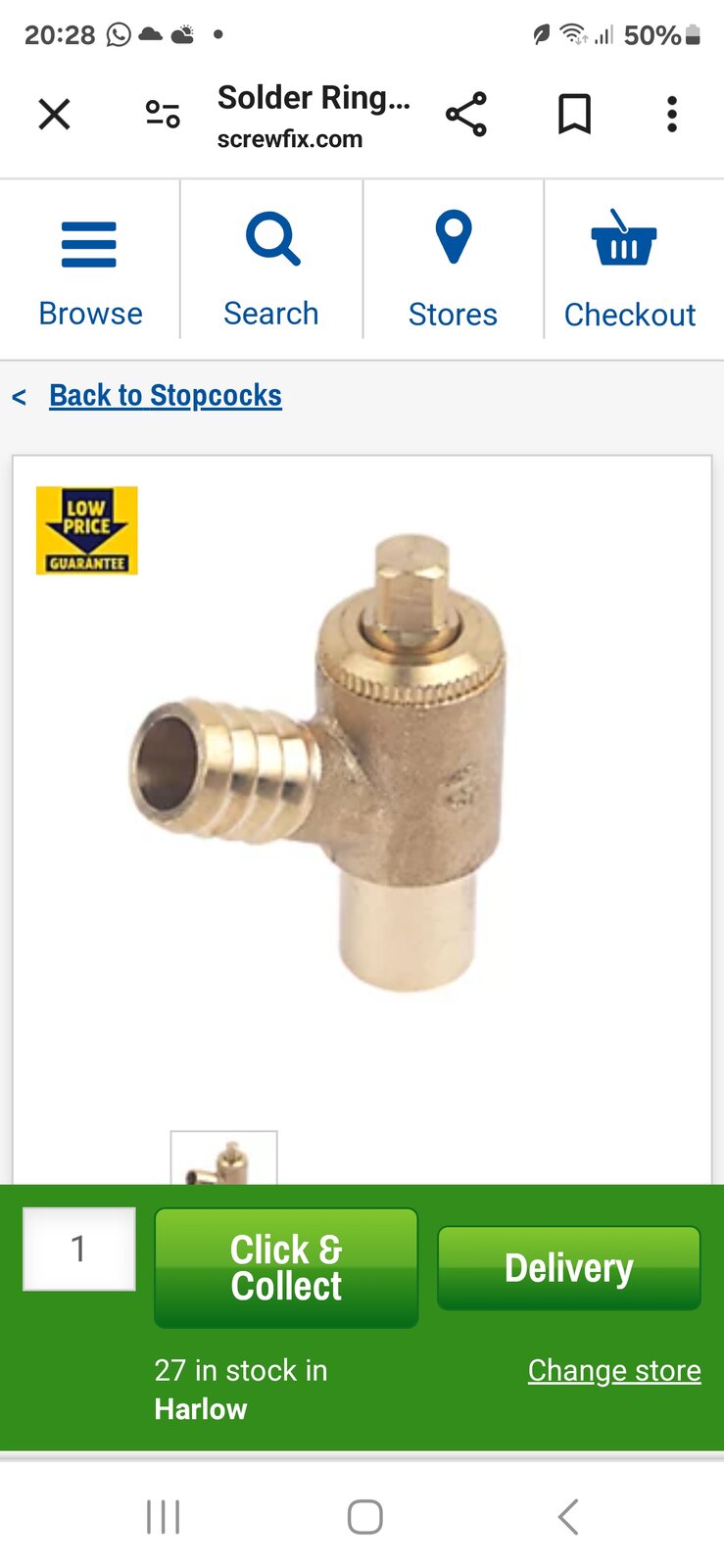

The Pressure relief valve is inside the boiler and you shouldn't be opening the lid.
However releasing the Pressure via the PRV will give you another problem in that they generally need replacing afterwards.
Best thing to do is to run a garden hose to a drain cock on the ground floor.
They can sometimes stick.
Should look like this.
Turn anticlockwise to open.
Do be mindful.

No idea what a PRV is? I’ve turned it off at the wall until I can get an engineer tomorrow.
What bit do you turn, the little bit at the top?
Turn the square part, with a spanner, ant-clockwise. The water will flow out, so have something to catch it.
Before doing that, we need to work out what caused it to pressurise in the first place. Has someone been opening fill valves, or was there some other reason?
