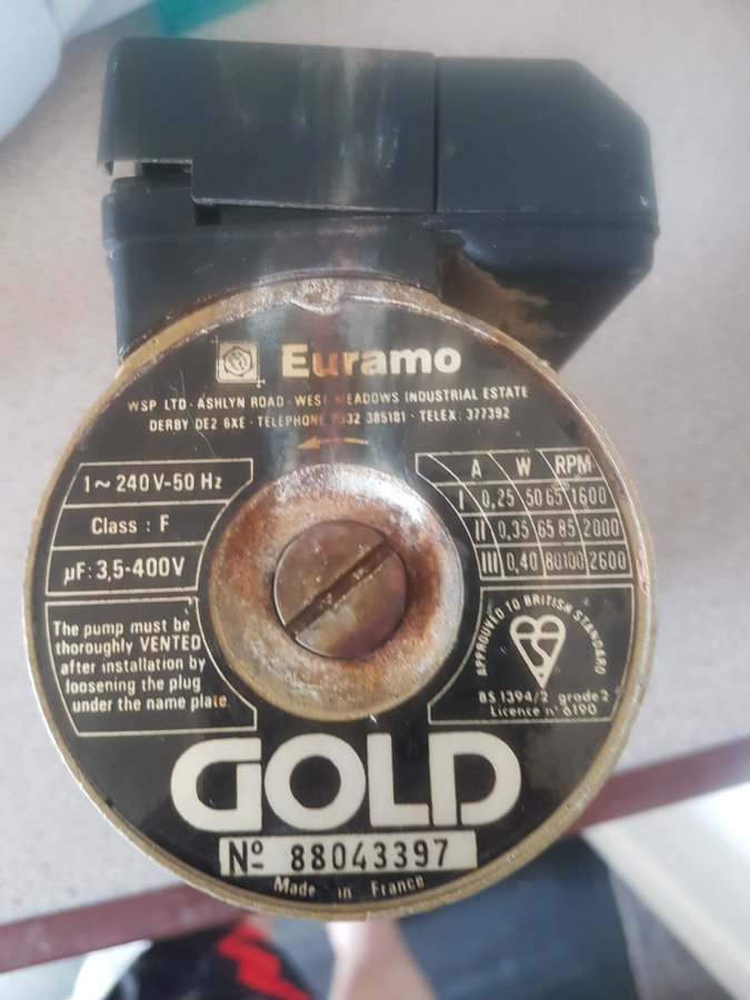

Hello everyone.
What's the most compatible replacement for the that pump?
Grundfos 15-50 or 60 will be ok?
It all depends on the application and the kind of boiler.
Tell us the boiler make and model and the number of rads and we can advise.
A 15-50 will probably suffice.
But energy regs say you should be using a smart pump as a replacement.
My heating system is so old (still with hot water tank) :) need to be changed soon but at the moment it is Mexico slimline rs445 or cf440 (I'm not sure which one but maybe these are similar) with 5 radiators.

The circulation pump I posted up will do you just fine.

Well the OP should just fit the Grundfos either way. Should be able to obtain for £60 to £80.

Exactly, it's of no benefit to him as an installer other than replacing it in three years. False economy when the Grundfos typically lasts 15-20 years.
