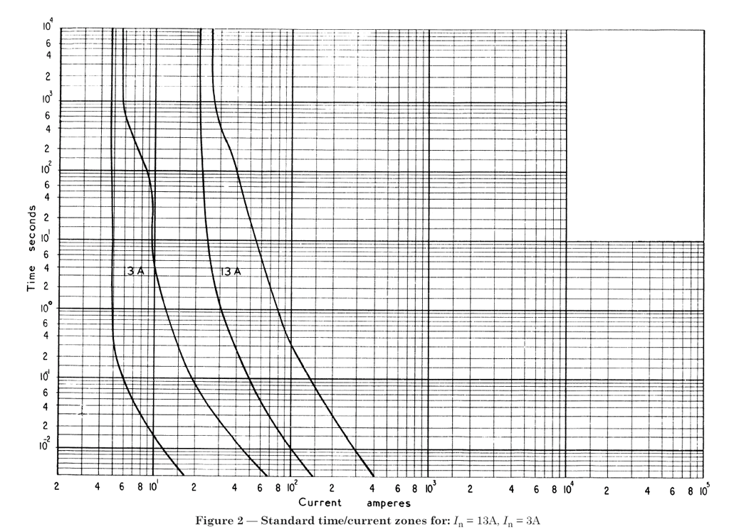

A 3A BS1363 fuse will carry 6A indefinitely. That's 1.3kW - plenty to start a fire. Maybe you've not seen any catch fire because you've fitted ones with all the appropriate approvals and not a cheap Chinese import.
