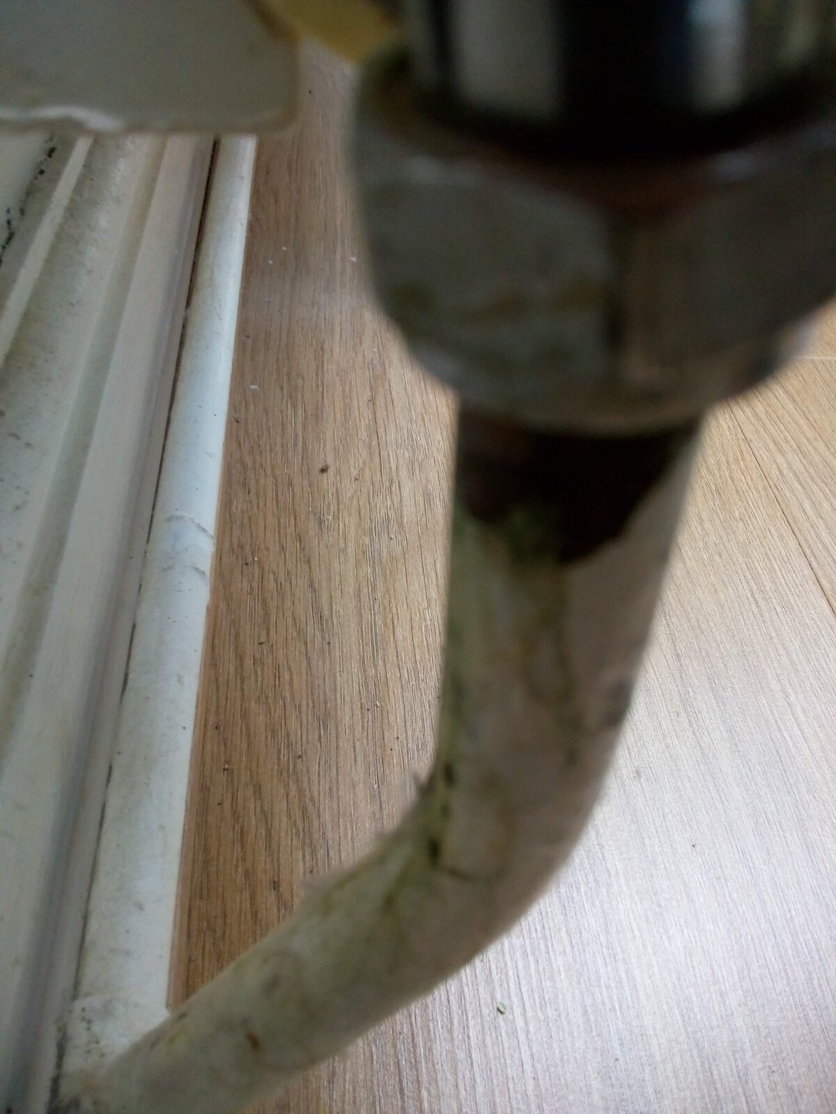

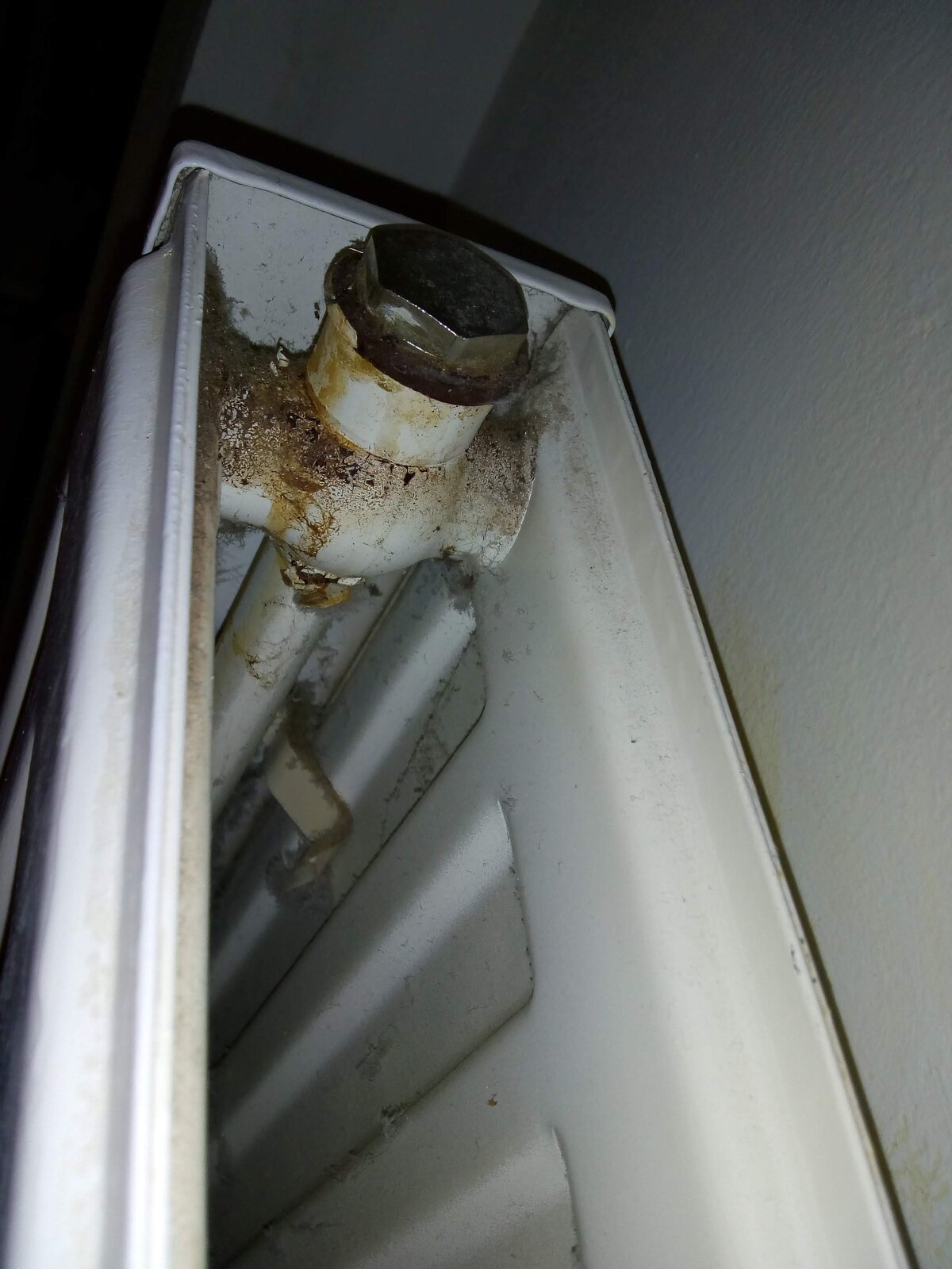

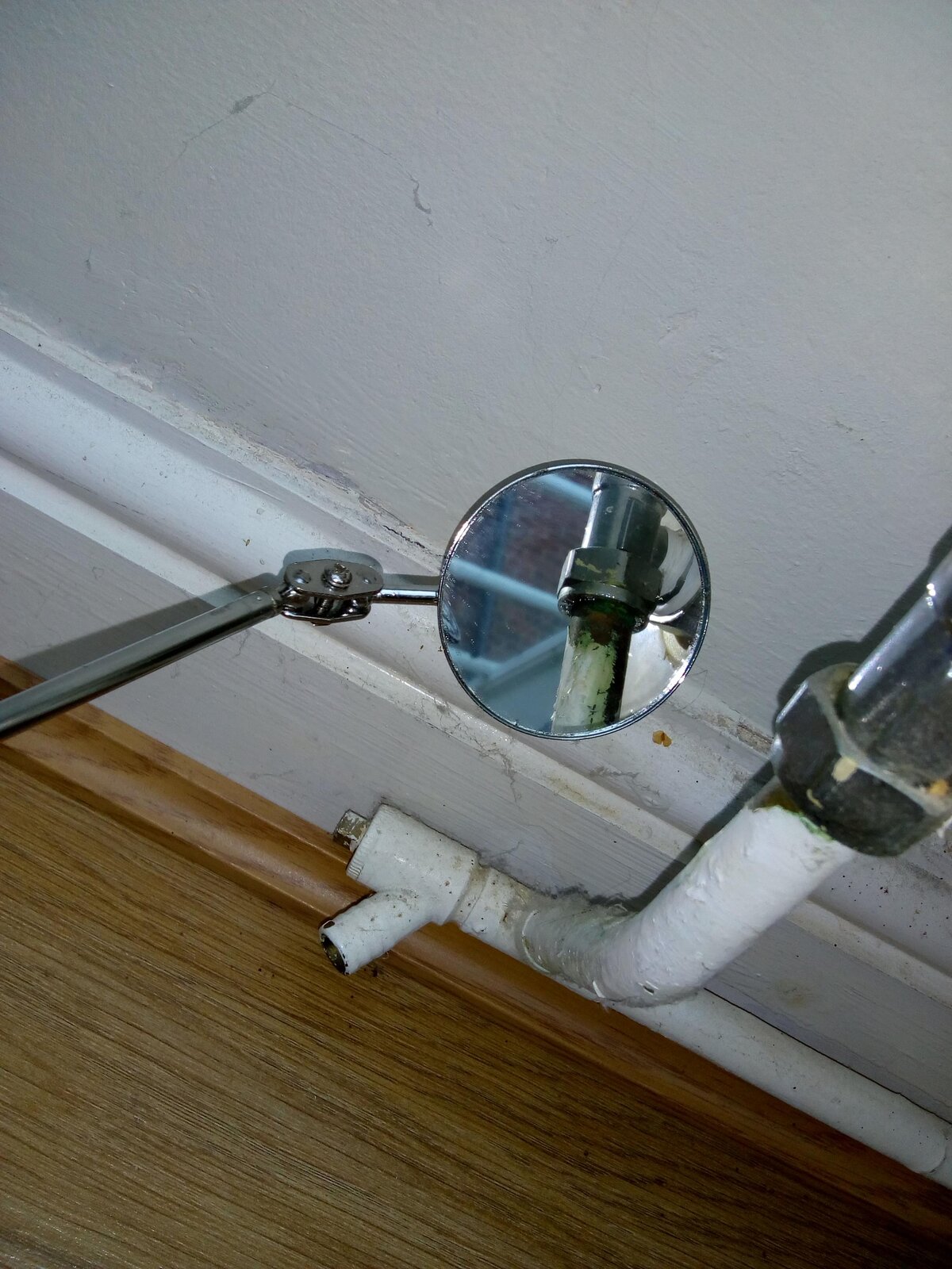

I think I found two candidates, though currently neither is weeping.
1. The tall radiator in the hall is rusty at the top, see first photo. It's on the flow side and the bleed valve on the other side but without any air, so maybe it's not that.
2. A lockshield valve at a downstairs radiator (that looks like a rough install prior to our ownership of the house). The copper pipework is (poorly) painted but there seems to be some corrosion, 2nd and 3rd photo.
How likely are these the problem, by themselves or jointly? And if I get the second radiator changed, should I as well change the first one?

Obviously been leaking at some point ,but could be historic. Are either positions damp ?
No, everything seems dry, both before putting the heating on and now that is running. I will keep an eye on them. If it is not one of these, then I really don't know.
