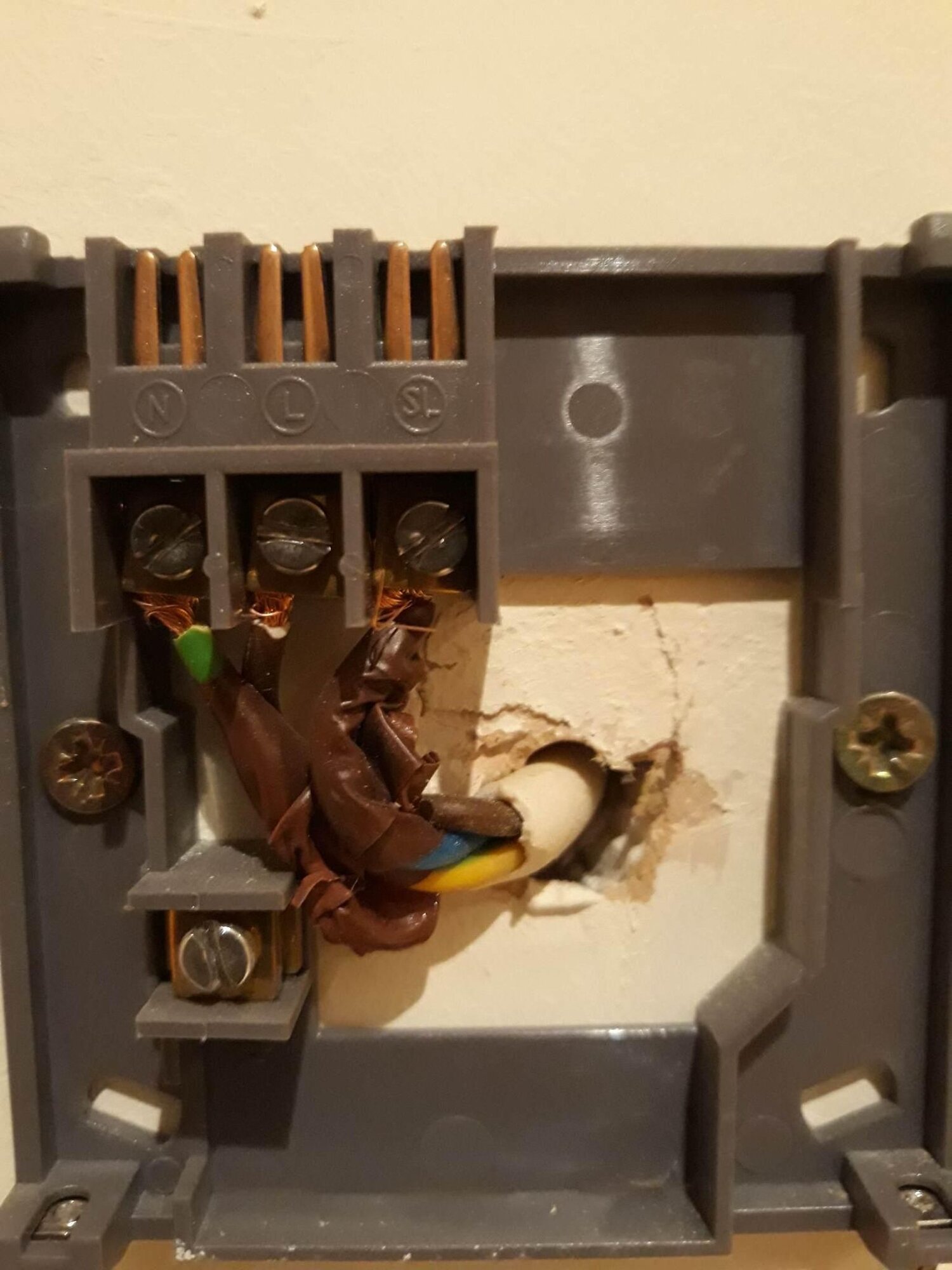

Moved into a new house last month (10 year old new build)
One of the room thermostats is not working correctly. (initially thought it was the motor in the zone valve.)
However opened the thermostat up and there is no "SL" wire attached . All it has is brown,blue and yelow/green wires.
Its a salus rt200 , the blue wire is attached to neutral , earth is on earth terminal and the brown live. Soon as the boiler is turned on the motorized valve opens. If the stat is turned up full or at lowest setting it has no effect. If the power is turned of the valve closes.

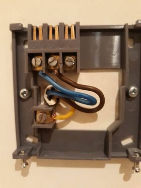

The wiring is flex, in the main wiring a house we use twin and earth, they use the green/yellow as a neutral, and over sleeving is done with tape, I am not saying this is wrong, but it points to being wired by a non professional, so one has to try and work out what his aims were.

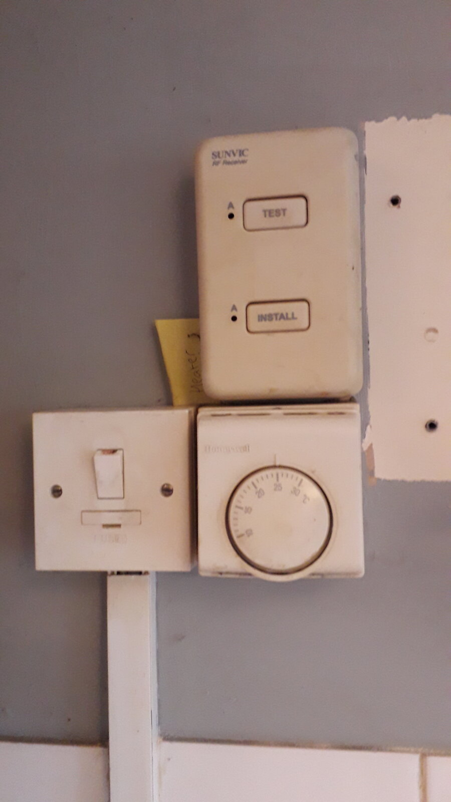

You can by using battery powered wall thermostats use the wires to do what you want, I found this 20190619_063642.jpg in my house, above the thermostat is a receiver unit for another thermostat never did find the thermostat. I found three fused connection units and it was to put it simple a mess, I used the wires, but completely altered the wiring adding too zone valves and came to the conclusion the central heating could have never worked since the garage was converted into a granny flat and they must have used the wood burning fire.
I like you to start with thought well it must have worked for them, but come to conclusion no it didn't.

Your wiring is not suitable for an rt200 room stat.
It would work with this Honeywell stat https://www.screwfix.com/p/honeywell-home-dt90e-digital-room-thermostat-eco/41365
But it may need a small modification to the wiring at the main wiring centre to make it work. Simply connecting the new stat may irreparably damage the new stat and also blow the supply to the rest of the heating.
Also the wiring in your other room stat which is working is not compliant with wiring regulations.

Yes i made the assumption the wiring would not work with rt200(even though it lights up ). For some reason the stats or wiring for the stats have been changed at some point.
So do i just choose any SPST thermostat and it should work?

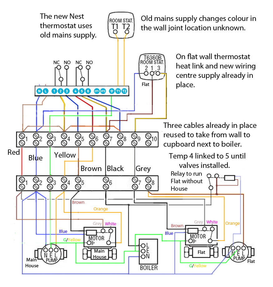

Even with non modulating boilers you get some odd ideas, when I moved into this house to put on the central heating in main house I had to walk outside down to the flat which was originally a garage under the house and plug in the pump, but turned boiler on/off with a time switch in main house, with no thermostatic control for main house other than TRV's only the flat had a thermostat and that was in kitchen. Both DHW and CH went on together, the time switch showed them separate but there were only two wires main house to flat, so no way it could have worked.
So I had to design a system that would work with only two wires, I used Nest as I could keep it powered and control both CH and DHW with two wires using extra low voltage. Not for any of the geofencing features but because it would work without fitting extra wires. And in the same way you will likely need to use battery powered thermostats because you only have two core and earth cable. And it will need some sort of as built plan to work out what does what.

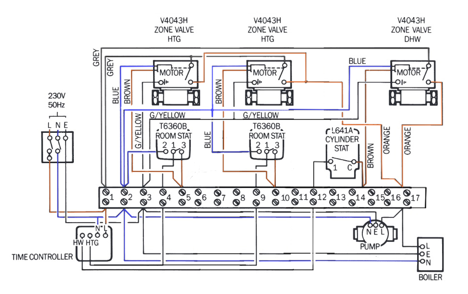

I sat down with my house and worked it out C_Plan_My_HouseD-relay.jpg likely you will also need to work out some plan, this is a standard S Plan zone plan
clearly yours is more complex, be it a block diagram or wiring diagram you will need to work out what you have. Mine was made complex due to two pumps, but there is no way I would have sorted it without drawing at least some of it out and doing a lot of testing, getting some one in will likely be expensive, as it takes time to work out what some one else has done, which is why I drew a plan of mine, as when I am older I may not be able to DIY so need to tell some one else how it is wired.
