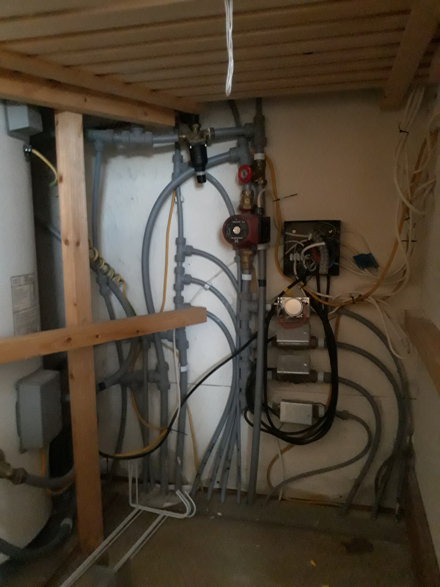

The "Faulty" stat makes the motorized valve open permanently and request heat. Downstairs under floor heating does not seem to request heat from the boiler, so only works if the water is hot or the upstairs is requesting the boiler to heat up. (strange be cause the underfloor heating has a separate junction box and there is a space for wiring to the boiler, but its missing lol)
if there is no request for heat upstairs from the room stats then the under floor heating does not seem to heat up downstairs.

that was my first thought, and did attempt to look at wiring center. However it looks like **** in the wiring center. Ill post a pick maybe i am being too critical lol
THe wiring for the stat in question has probably got a join in the attic somewhere.
Under floor heating normally has a second circulating pump and a load of valves the wiring centres are rather special and the pump and valves are really independent of the main central heating what it does is maintain water at 29°C by adding more hot water as the circulating water cools, however there are other methods, you say 4 motorised valves, and I wonder why so many, one for domestic hot water and three for central heating seems a little OTT, so wonder if your talking about an actuator looks like a TRV with wires to it. They are I supposed motorised valves so are programmable TRV heads, but we don't tend to think of them as motorised valves, this
is typical with under floor heating, but also seen so cheap methods, one is to use the return from the radiator to heat under floor, so in that 4 motorised valve count how much is for UFH?
Under floor heating normally has a second circulating pump and a load of valves the wiring centres are rather special and the pump and valves are really independent of the main central heating what it does is maintain water at 29°C by adding more hot water as the circulating water cools, is typical with under floor heating, but also seen so cheap methods, one is to use the return from the radiator to heat under floor, so in that 4 motorised valve count how much is for UFH?
ill get a photo of the underfloor heating. there is a motorised valve for that
there are 4 motorised valves upstairs (one for each radiator in bedrooms) one also upstairs for indirect? cylinder. There is a 1 motorized valve downstairs for the underfloor heating.
