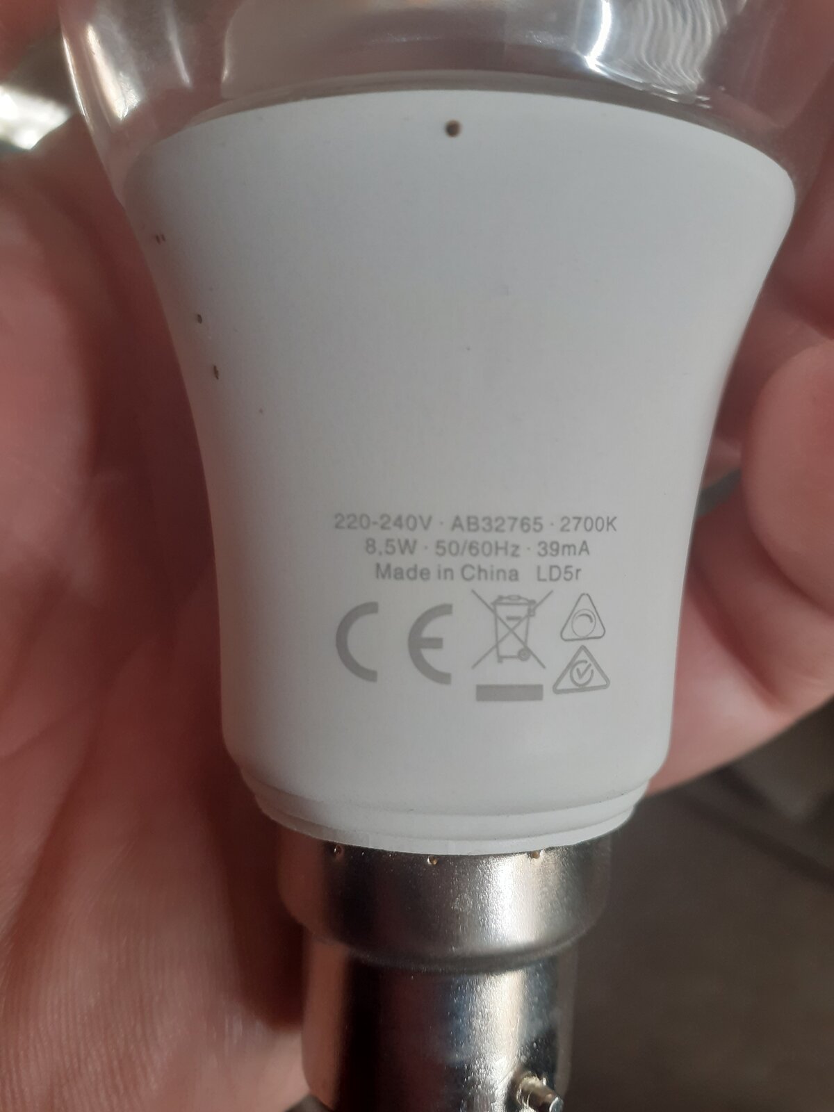

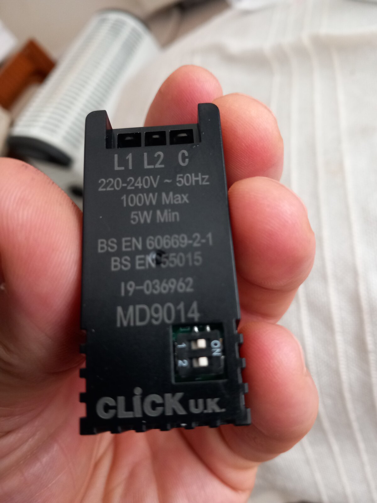

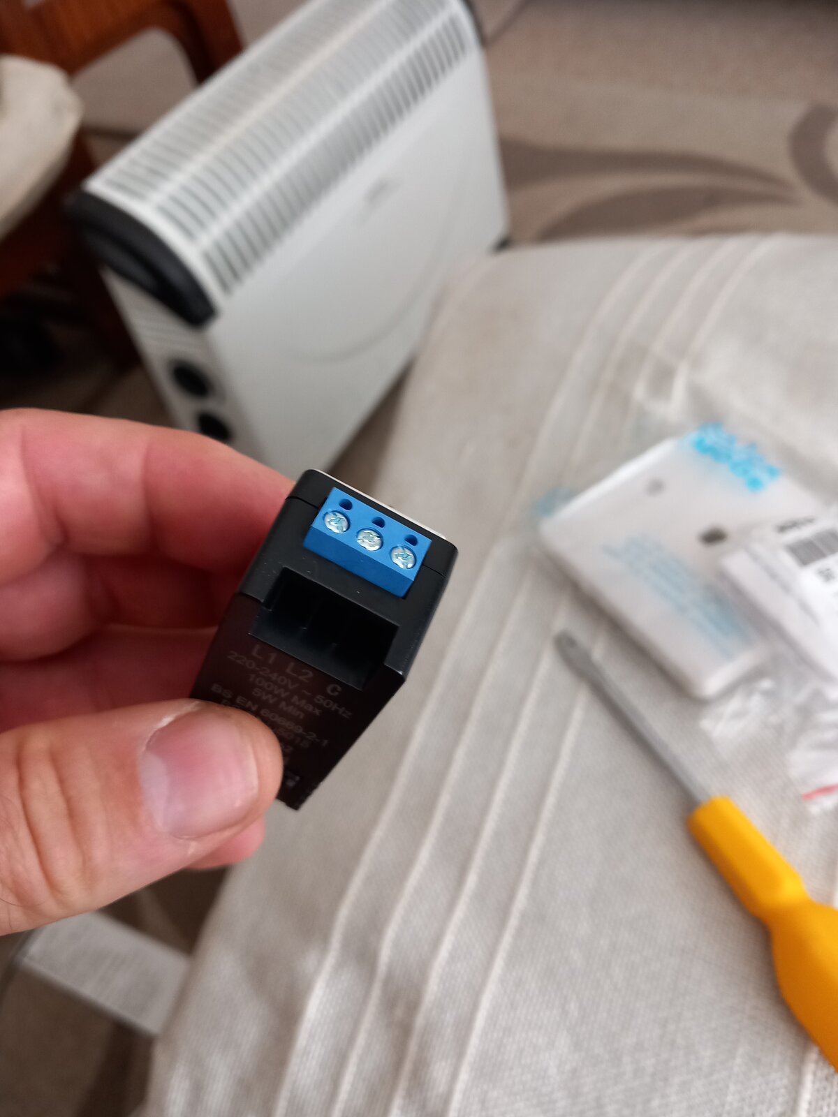

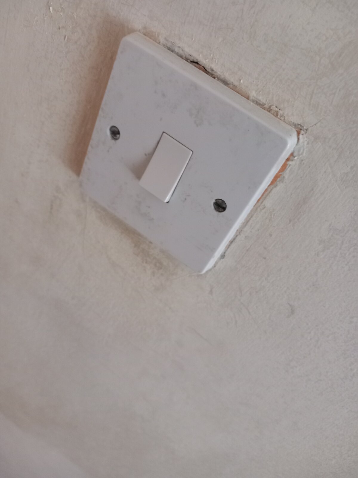

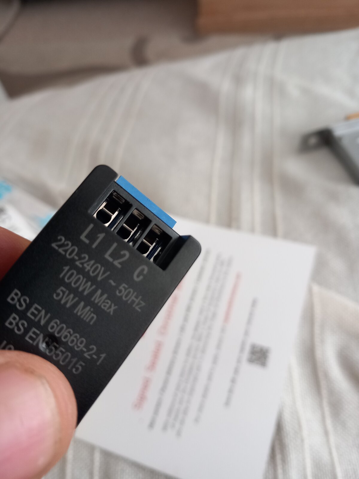

Wanna change my normal light switch for my LED light (8.5W) to a dimmer switch. I believe the L1 terminal takes the neutral (black) and L2 the live. Correct? There's no earth. I'll leave the C terminal empty.

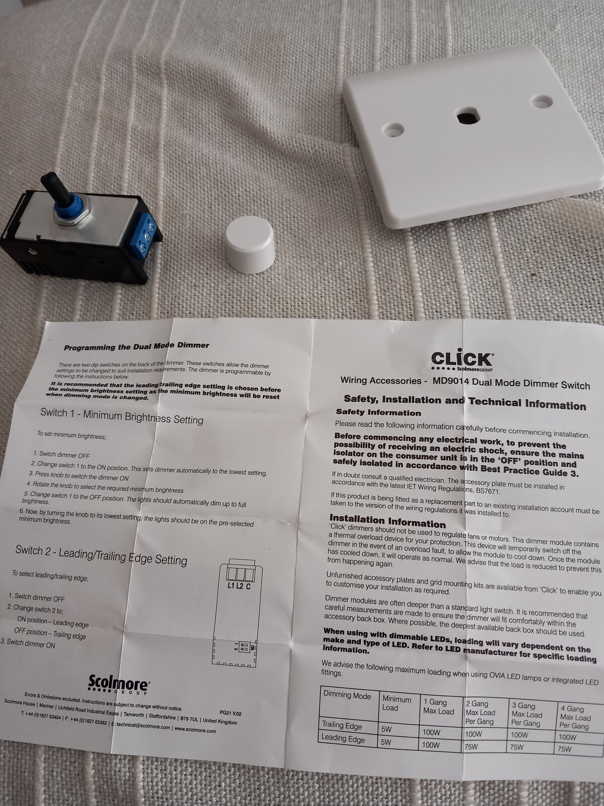

Can't get white plastic knob to stay on either. Won't push on. Anything obviously wrong?

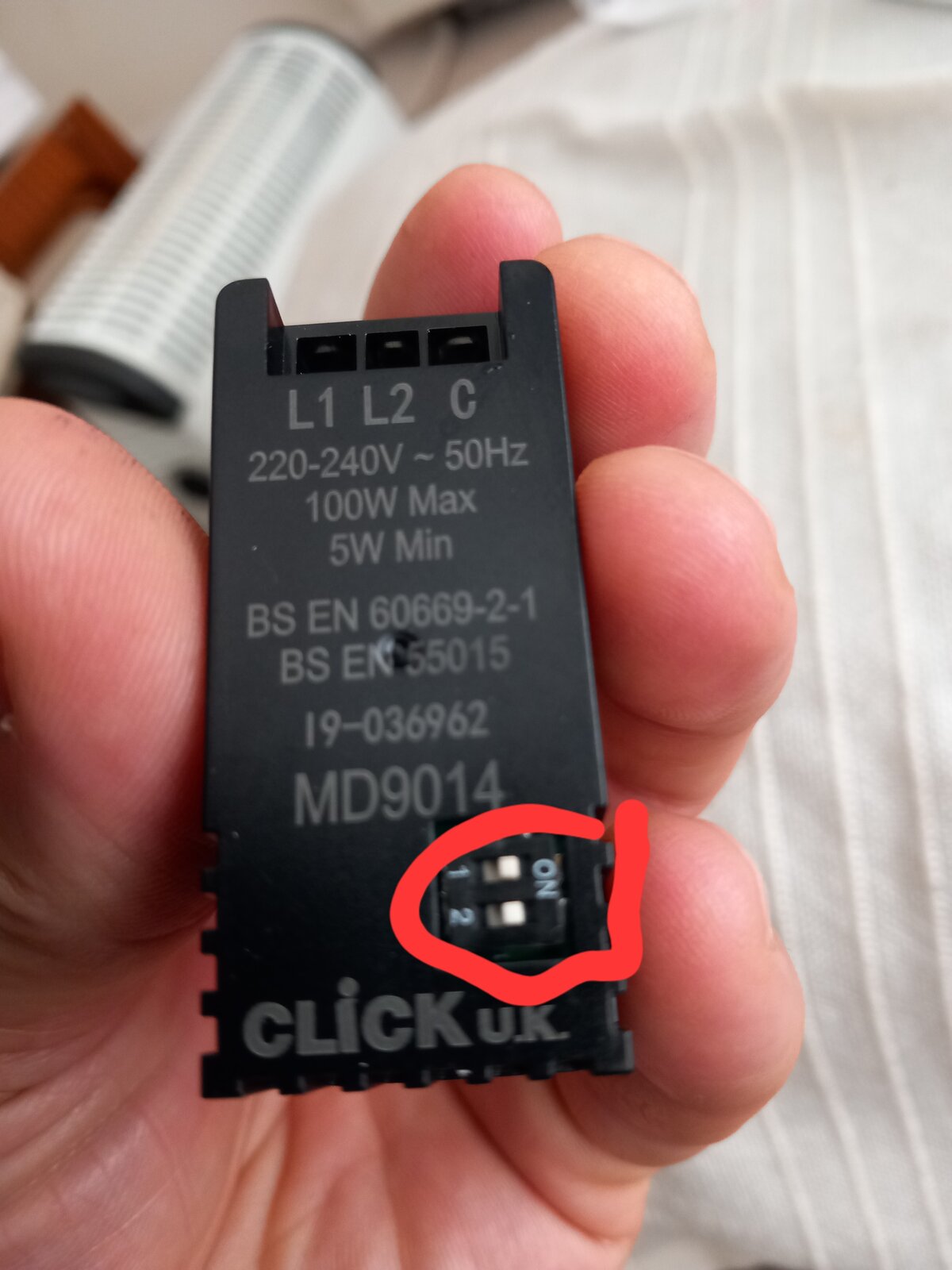

You can programme the dual mode dimmer, by switching 1 and 2 on or off. I've left them on

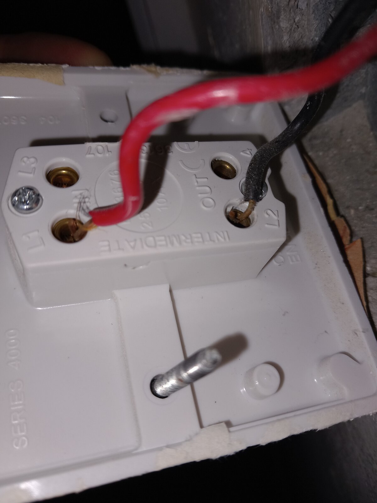

As above not correct. Think, if your red and black were L and N operating the switch would short the supply.

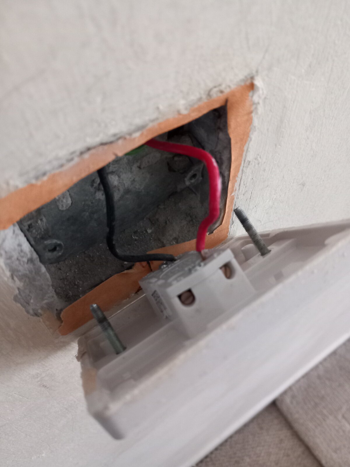

If you look at the back of the old switch, what are the markings next to the points where the red and black wires connect?
I think that I can see a green/yellow wire at the top of one of the pictures, is that wire connected to the metal back box?

Black is not neutral, it should be the switch wire. Connect red to C, black to L1, though it should work equally well with black to L2.

L1 is red, L2 is black in old switch.
In the bottom photo there's the option of setting 1 and 2 either on or off

Ok. My post wasn't much help to you then, sorry about that. As Harry suggested above connect red to C, black to L1 in the new switch.
Switch 1 sets the minimum brightness, follow the instruction.
Switch 2 sets leading or trailing edge. Set it to off for trailing edge.
Nothing blows up if you get these switches in the wrong place.

So I need the trailing edge setting.
I'll connect red to C and black to L1.
Oh, yeah, why can I not push white plastic knob on ?
