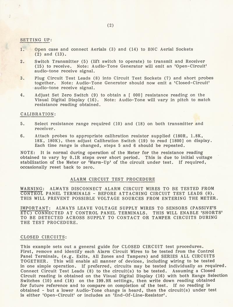

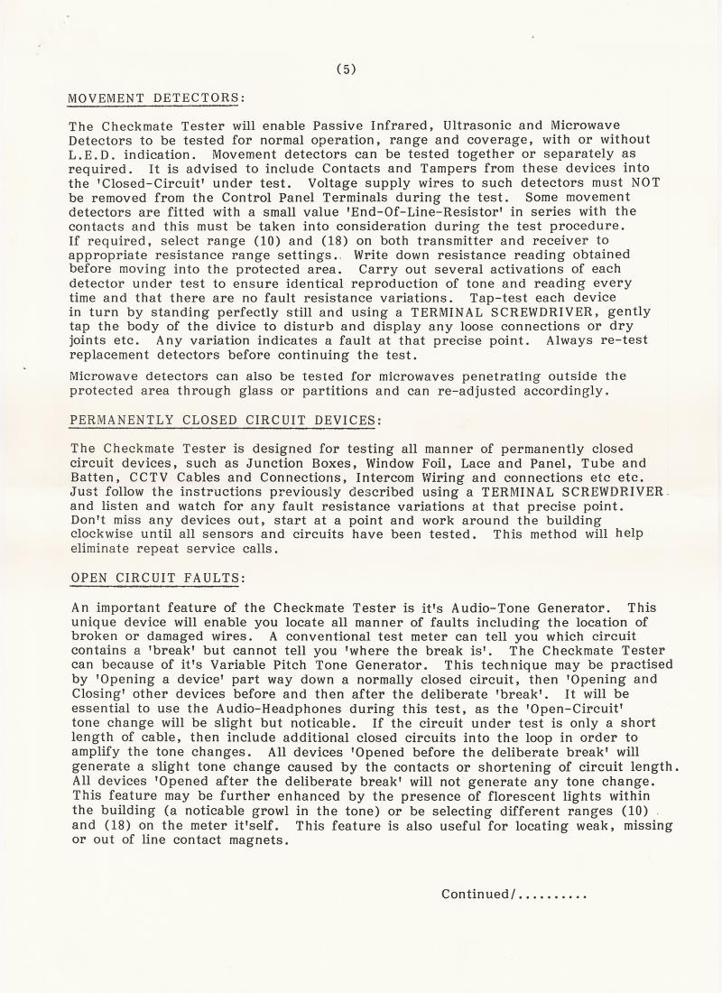

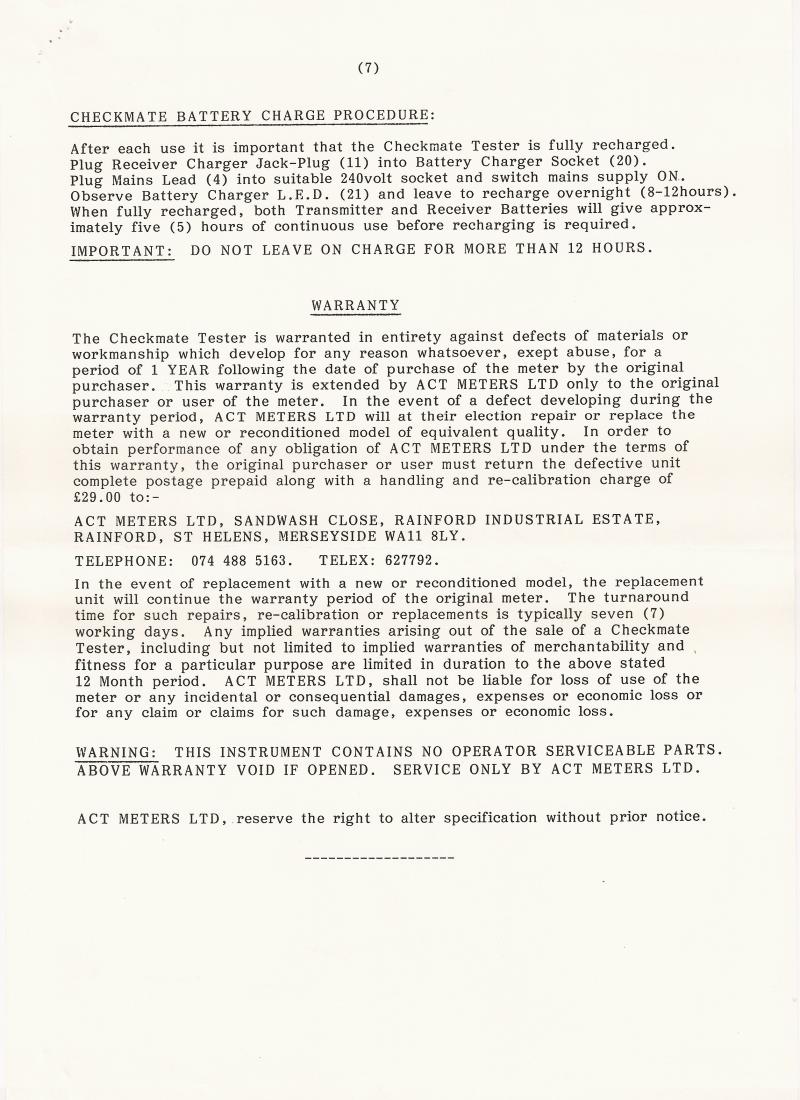

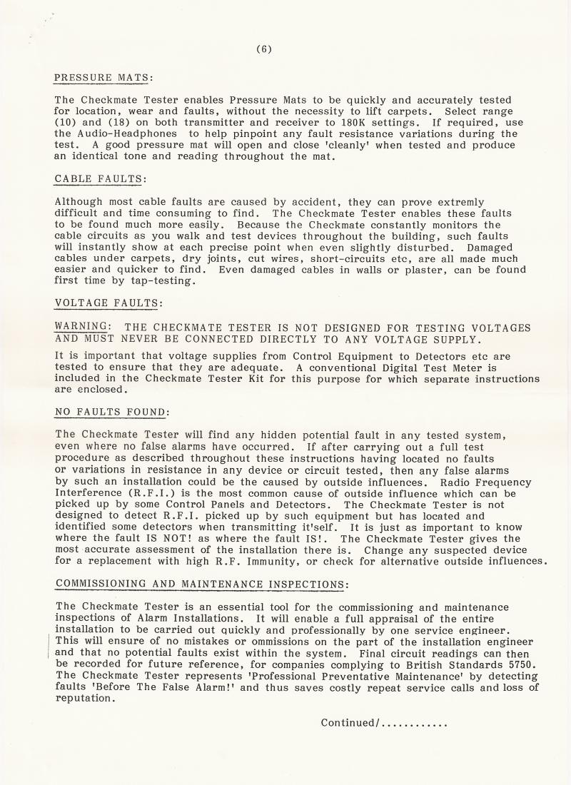

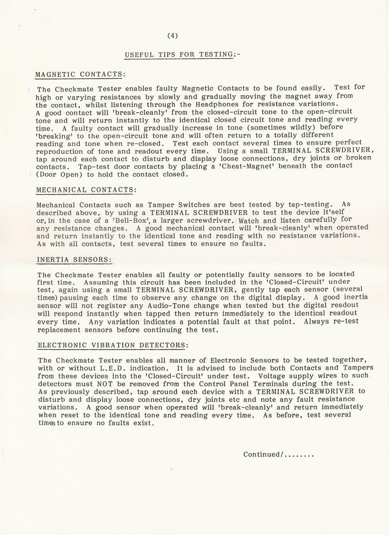

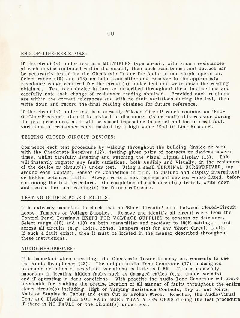

I've had mine since 1988 and not used it since 2004, still keep the batteries charge though, anyway, I'm sure I have still got the instuctions, I'll have a look when I get in from work tonight and PM you.
Didn't realise that their wasn't a PM facility :-(
Thats outstanding, thanks for taking the time.
Even ACT don't have any instructions to hand for these meters. Although they have offered to do a full service on it for what I thought was a very reasonable £93. I will no doubt take them up on that in the future. :)
I've converted it to PDF just in-case it should be required by anyone else in the future and posted it HERE http://www.multiupload.com/7ISKSIT6OJ[url]
