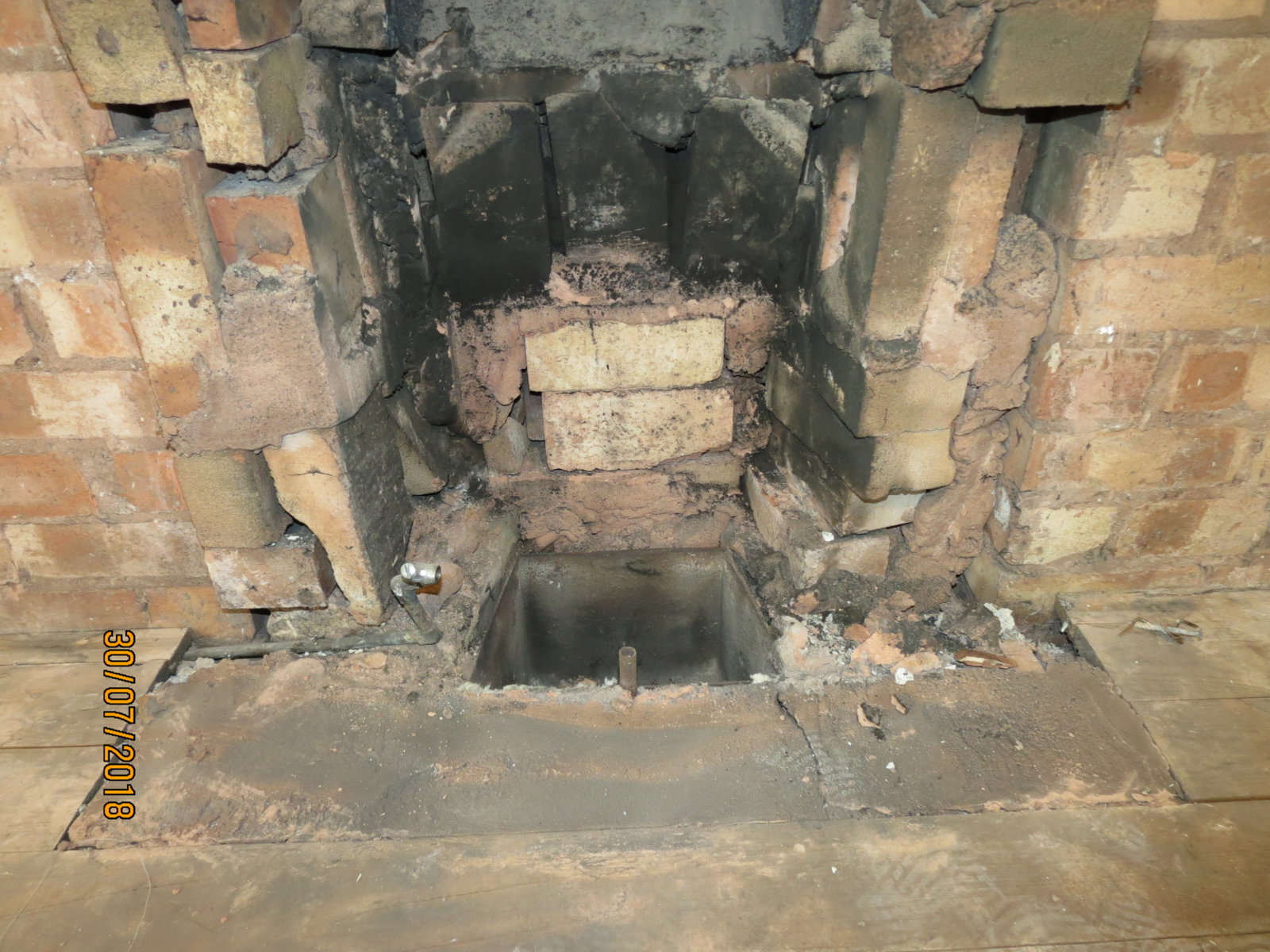

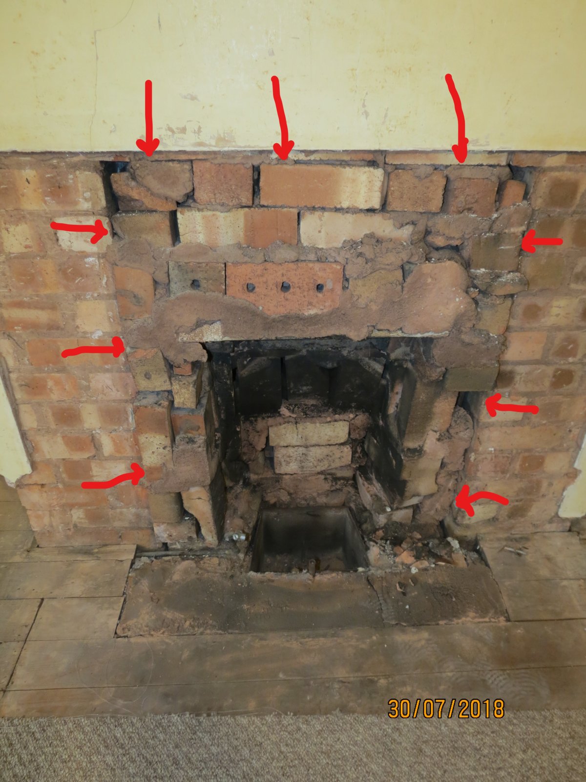

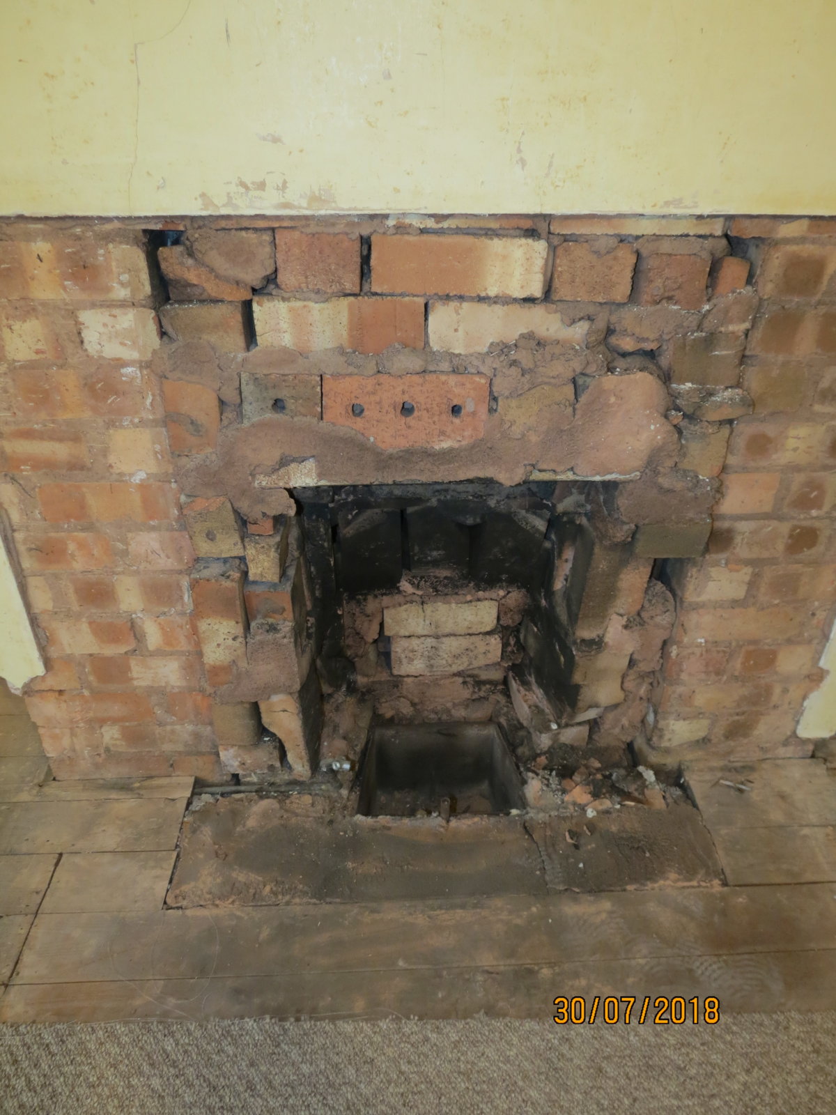

Hope you can help me, Ive removed an old gas fire and Tiled(glazed) fire place that was probably fitted in the 50/60s?
I am left with this as in the photos...its looks like someone has thrown odd bits of brick and mortar into the fireplace opening...…
Can I remove all these bricks up to the red arrows without supporting chimney?
Cheers for any help....

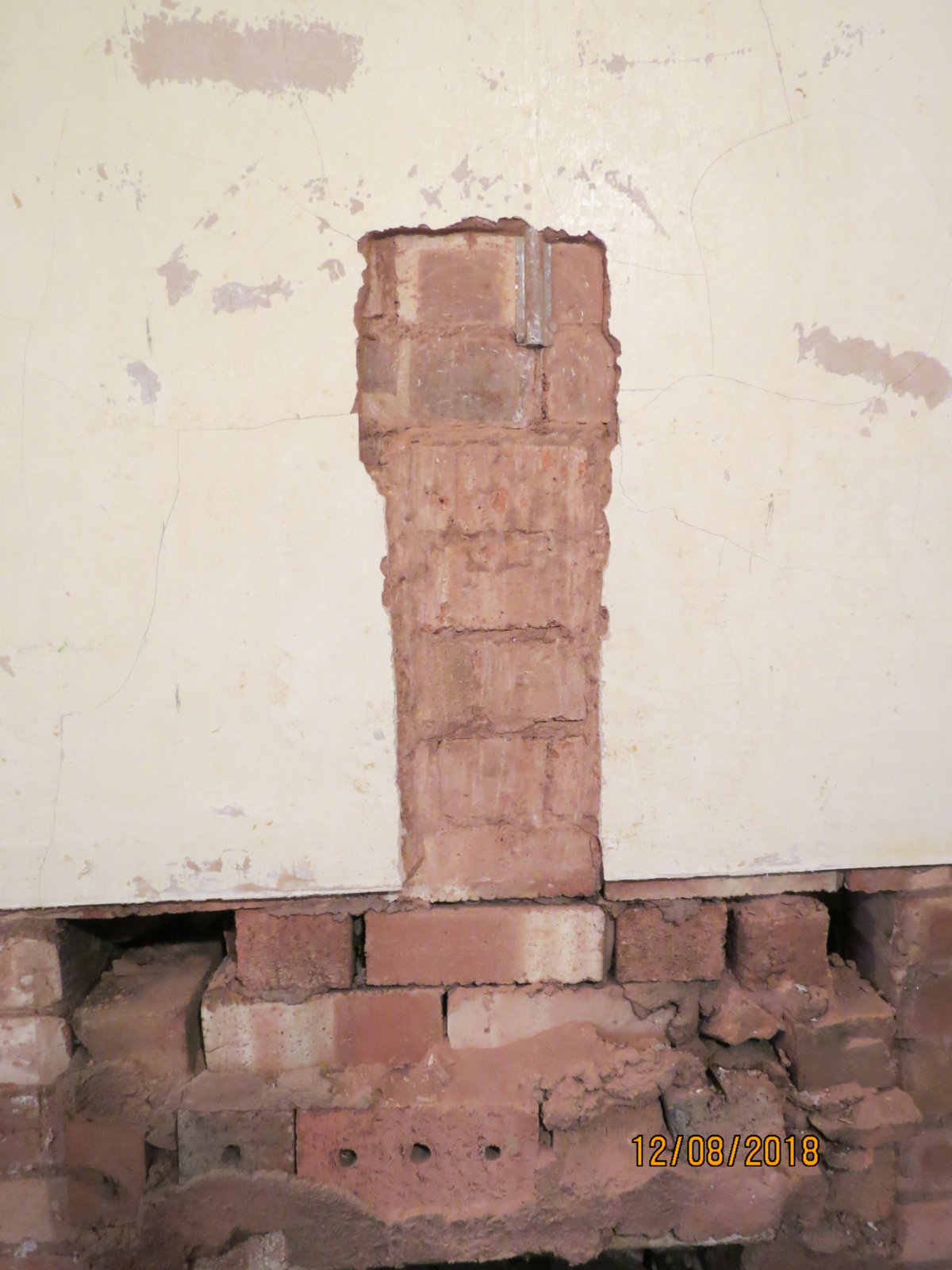

Just knocked the plaster off to a height of 5 foot from the floor....and cant see anything apart from normal rows of bricks :-(
You could fit a catnic above to give the correct support to the brickwork, then a decorative oak beam below it.

I would remove the bricks you highlighted, the chimney won't collapse.
the original brick arch was taken out when the opening was made smaller - probly because the whoever couldnt infill below the arch curve.
thers a metal lintel holdin up some bricks but when youve got your correct height then insert a concrete lintel and only then remove the metal lintel an infill below.
probly safe to remove now but why chance it before fittin a conc lintel?
