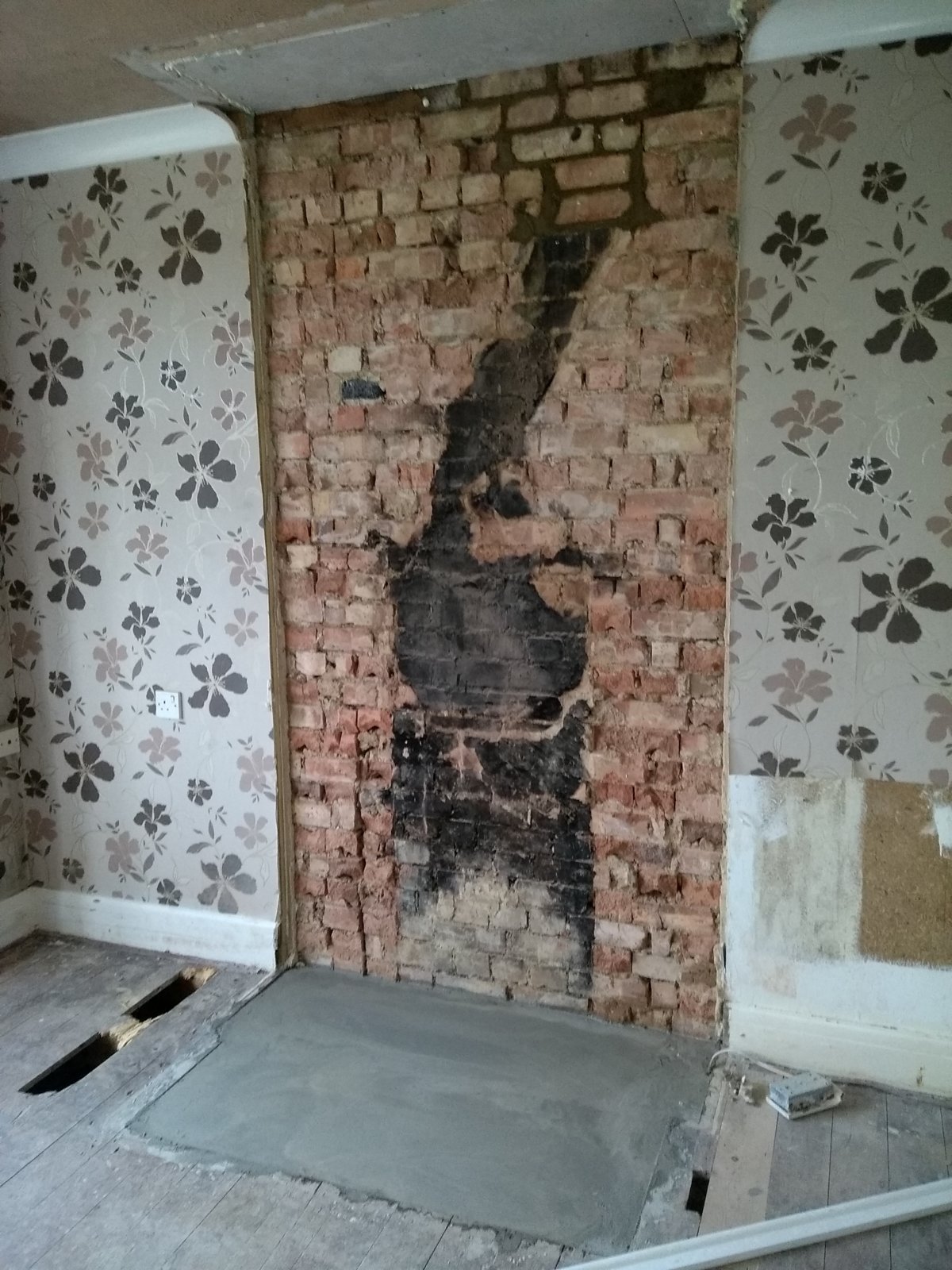

Is this ok? I questioned it with my builder, who said damp course in place and latexed over.
But surely damp could penetrate from the wall, if it got damp? And, now not possible to insulate that bit below. Is this ok? More concerned about damp than cold, but a big cold spot could get damp in winter...
you will possbly/probly get damp coming up through the old hearth an fireplace.
it should have all been dug out to below hearth trimming plate level, about400mm - 500mmdeep from FFL.

ive no idea what damp course in place an latexed over means?thers no signs of a membrane bei in place under the new work? an no injection holes in the back wall?
youve gotto wire brush the soot off the back wal and render with sand an lime not gypsum.

The floorboard was eaten by woodworm by the looks of things, others seem ok but I'll take them out and put new in after treating all woof down there. Really it's just that hearth I'm worried about. Although, why does the wall need to be wire brushed?
It looks as if the top few inches of the hearth were removed and screeded over, after application of a liquid dpc (if that is what meant by latexing). If so, it is not clear what, if anything, has been achieved in terms of preventing the return of damp as a liquid dpc would not be retained by the broken up base of the original hearth, and likewise the vertical edges.

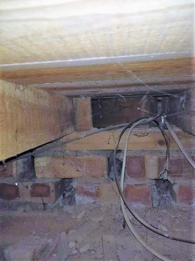

Can you post pics of the hearth from under the floor on the left side?

soot penetrates most everything, remove it an render.

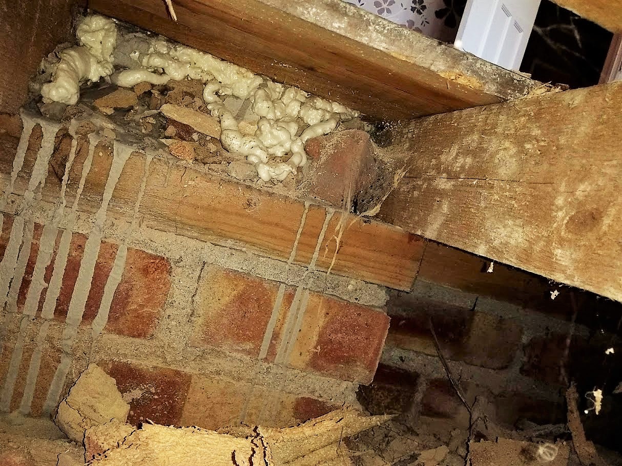

not sure what this shows.... some pics from below.
Looks like the screed has percolated through the expanding foam.
First time I've seen expanding foam used as a damp proofing material but others may differ.

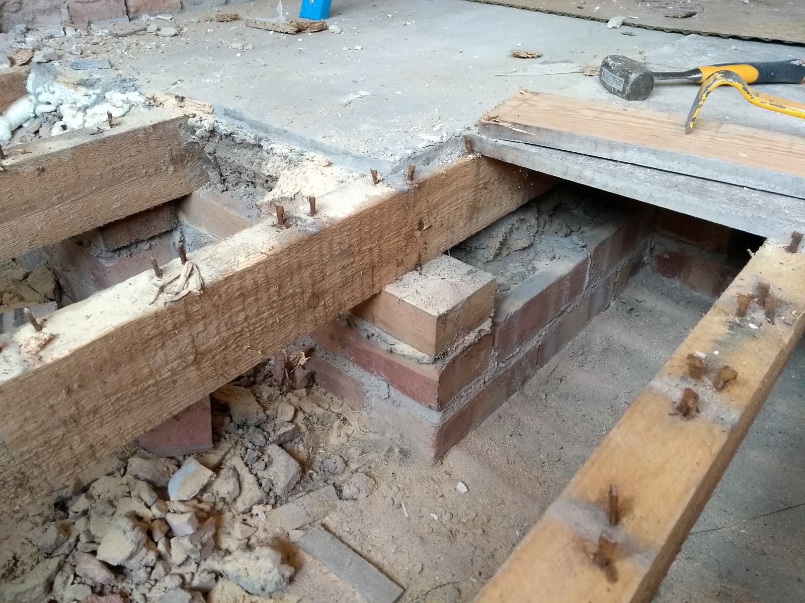

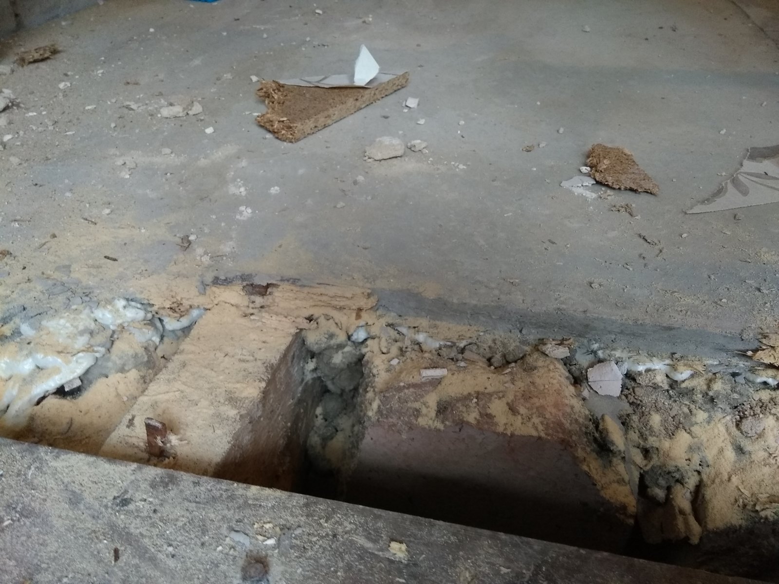

Have removed someb boards. Screed looks thin. Guess it needs to go down to dwarf wall height fit wall plate them new joist over. Will get them back to do this as they are coming back anyway for other work.
before liftin any more boards dig the hearth out as above.
the rusted cut nail in the photo shos damp is present.check your other nail heads surroundin the hearth.
or even check around the whole floor. rusted nail heads are a quick sign that damp is present below a suspended floor.

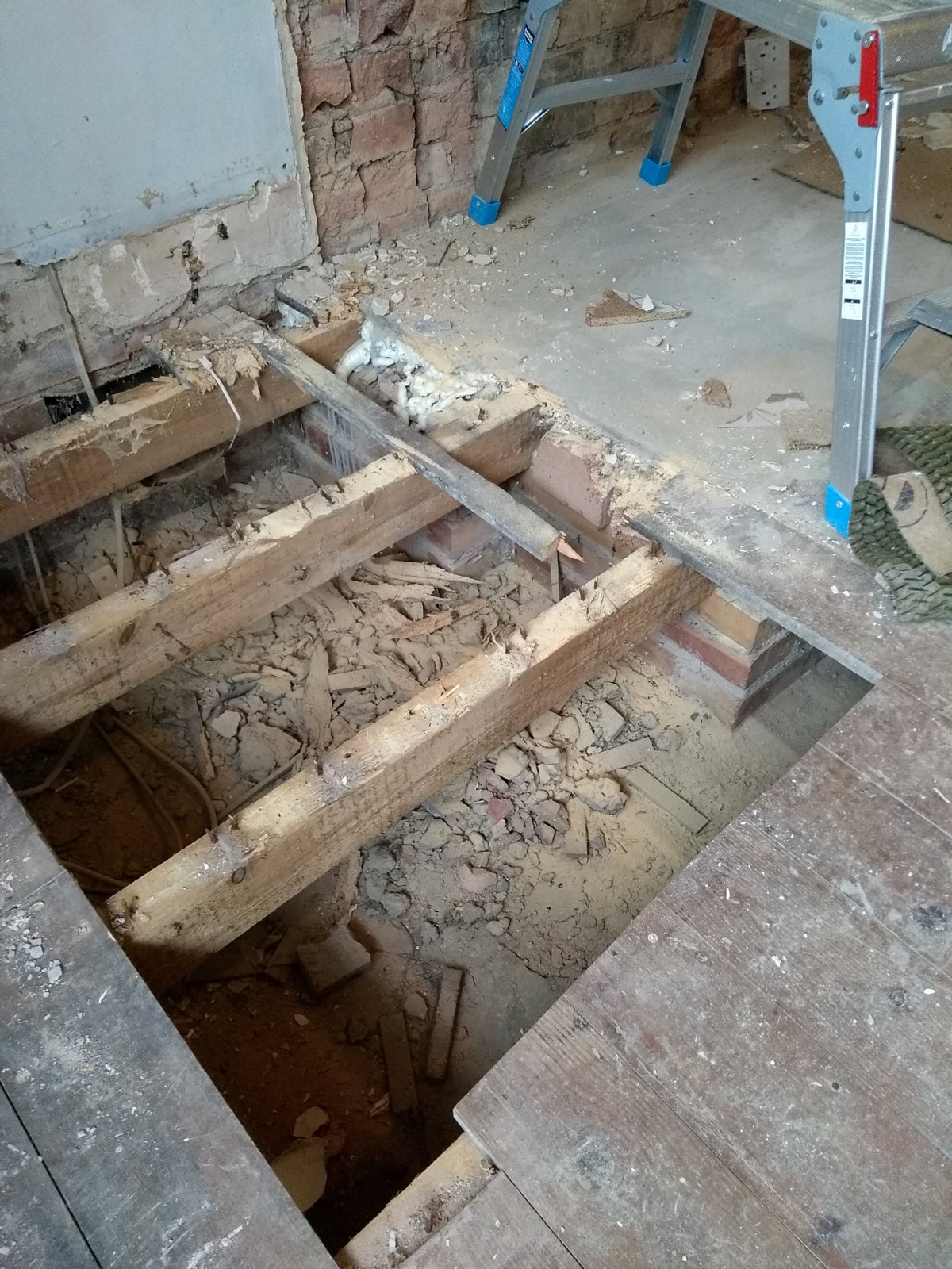

Still lifting floorboards, riddled with woodworm, will probably replace alll
Bits of particle board from wall.
By plate meant 2x4 on dwarf wall, which joist sits on.

Floorboards now have few bore holes, joist along hearth looks good.
