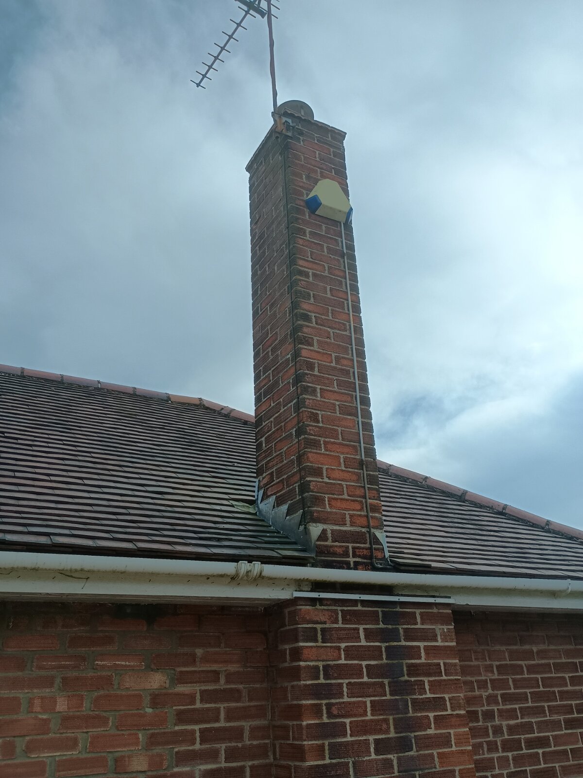

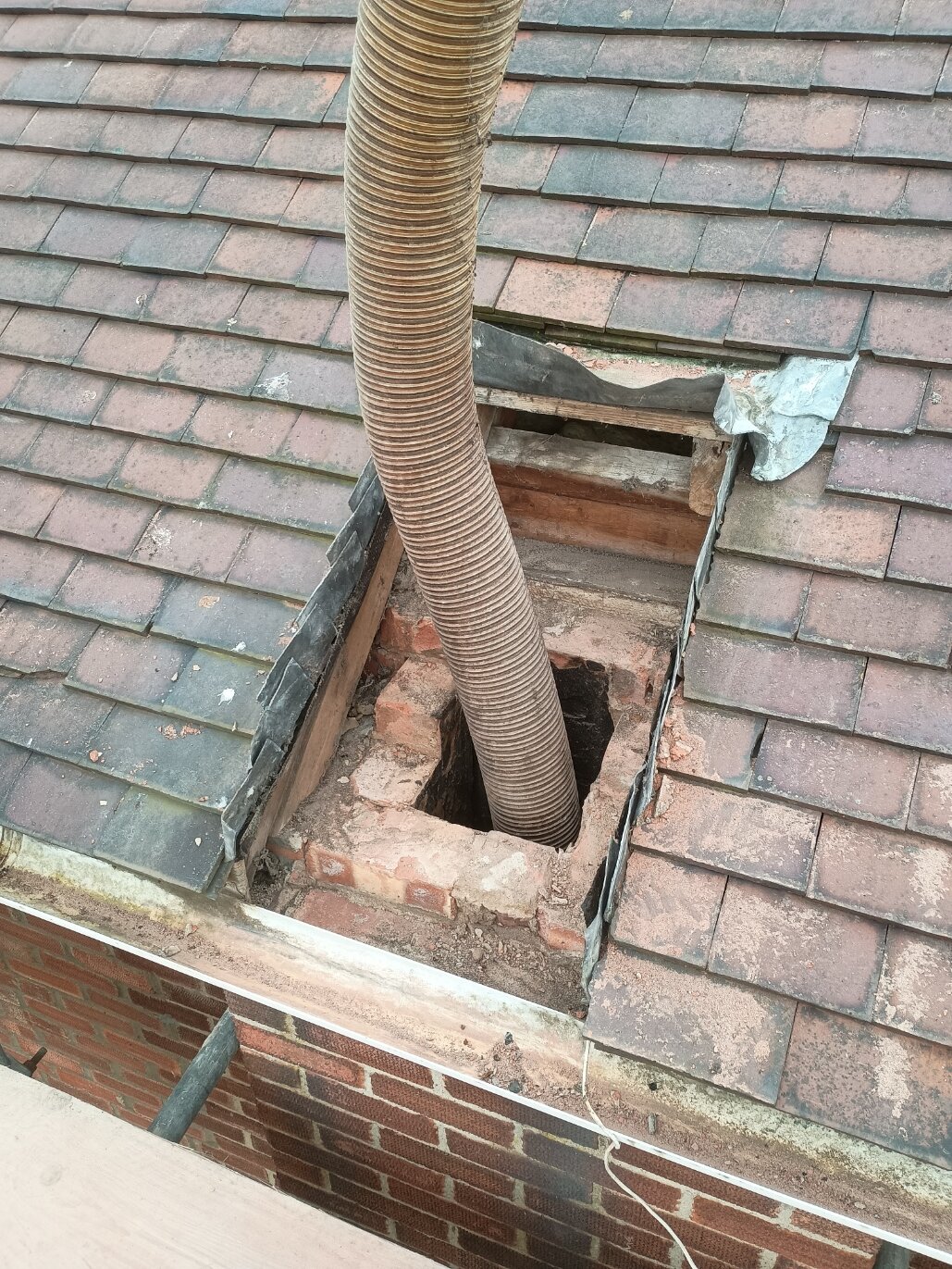

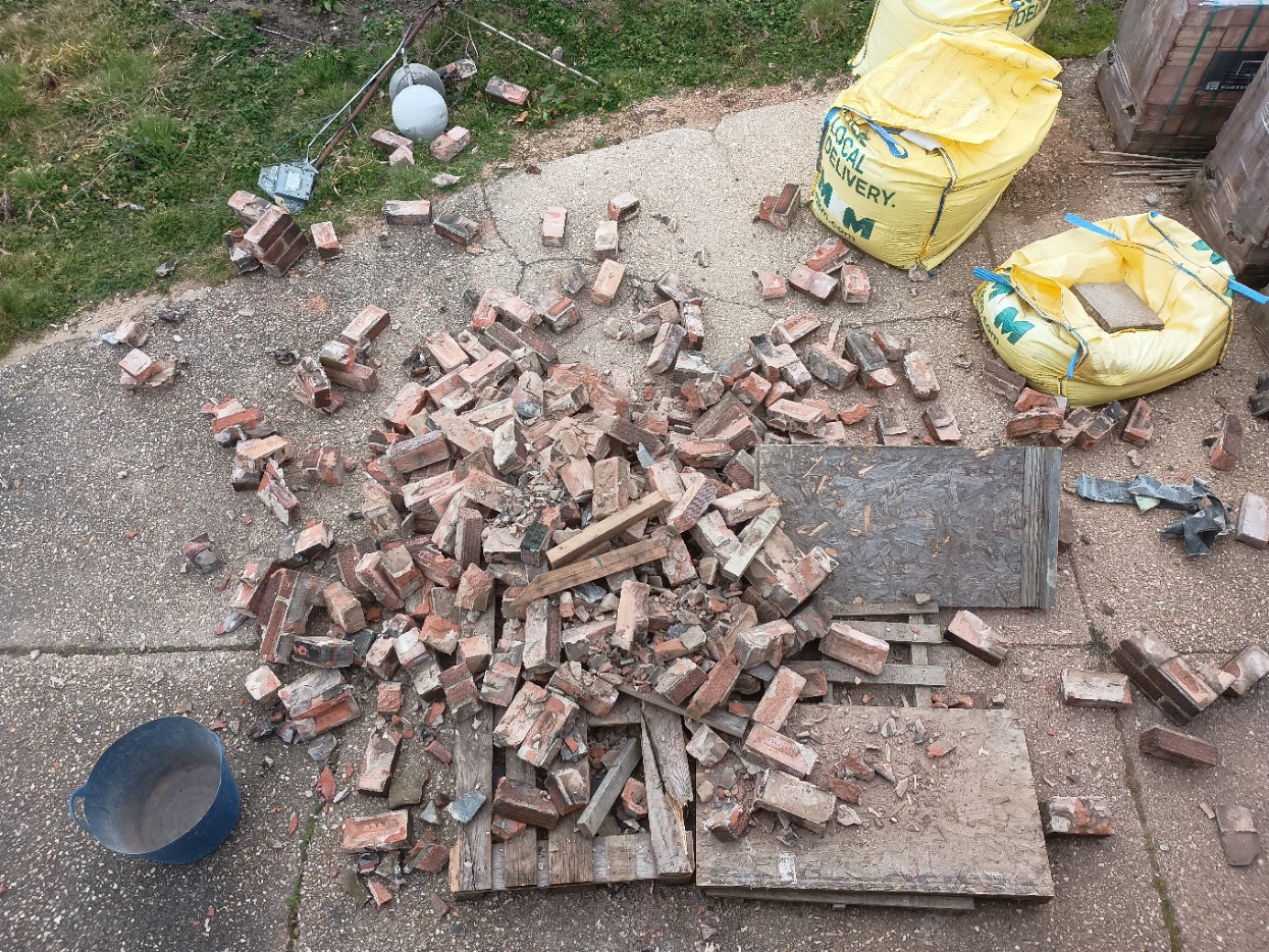

My before, during and after 2 weeks ago...
From 1950s to the modern world in 3 days. And I got £20 for the lead!
I doubt that anyone would have believed that it was still functional. The night vision cameras with glowing red rings should scare the baddies away (or at least tell them to put their hoods up!).
