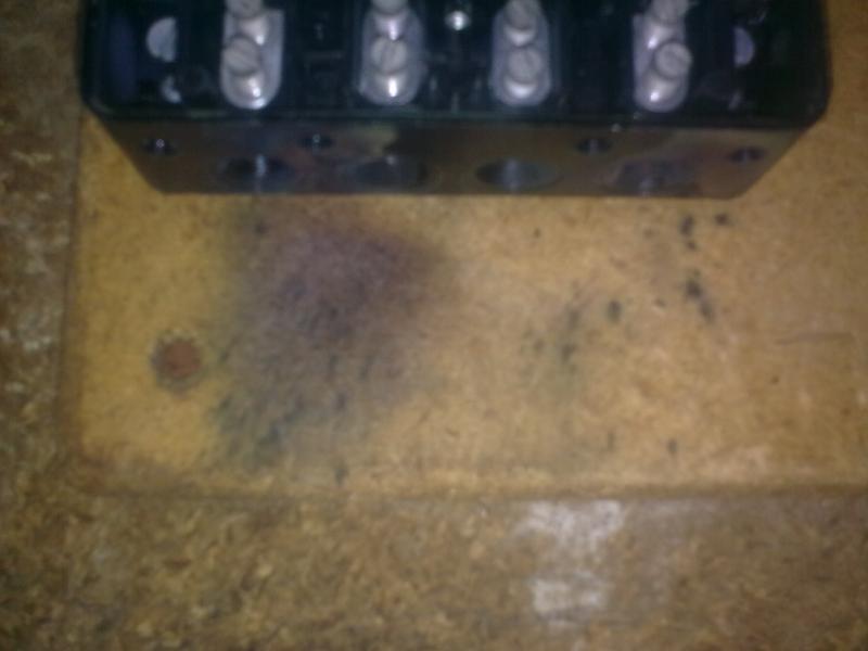

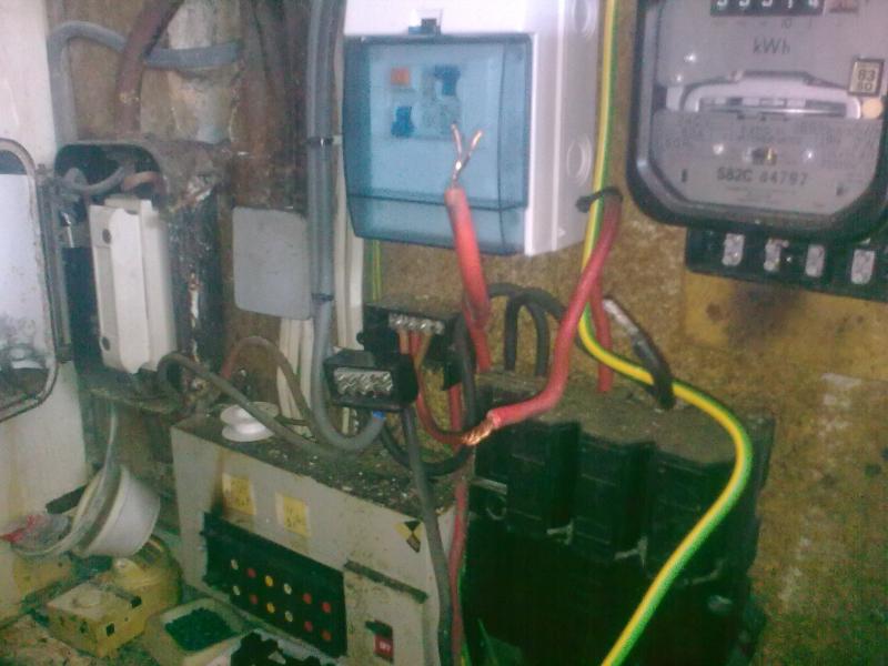

Just got back from an rapid response job, customer called there supplier as there was a loud bang from the meter cupboard and a smell of burning.

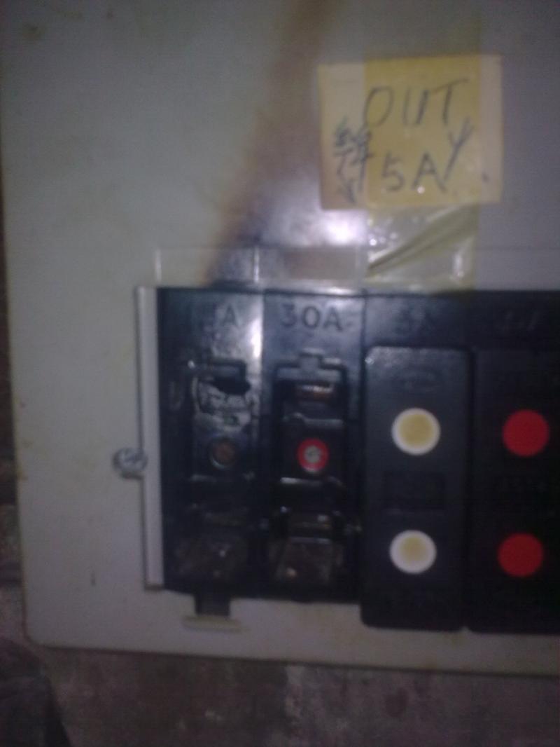

Got there. It was a Chinese Take away with living accommodation above for 8 staff. Put the PPE on and had a poke around. Very quickly pulled the fuse.
No bonding on this and no Earth to DB in flat above. Metal case lit my drummond up like a Xmas tree
[/img]

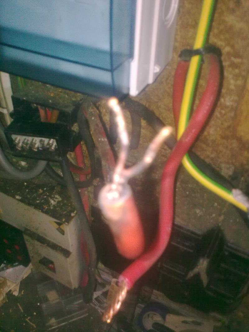

Last week he had a problem with the 2 deep fat friers not working. Got a friend to have a look and fitted a new 2 way CU with a 63A, 30ma RCD and 1 50A MCB going to an isolator and a piece of 6mmCSA feeding both friers.
The rest of the DB was still operating 4 RF & 2 lighting.

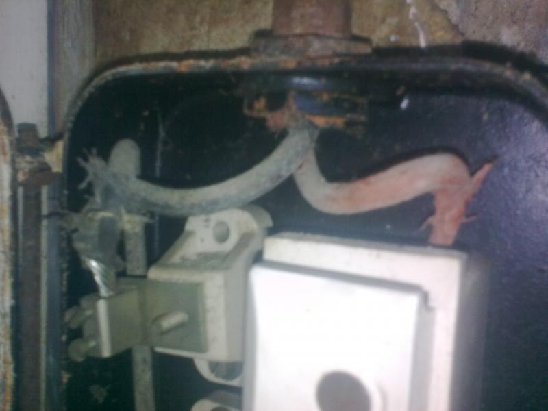

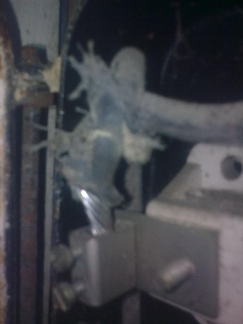

Got to the meter,
Those 2 strands were still powering the entire installation
He was not a happy bunney when i told him i was not going to turn the power back on until he had brought his installation up to current standards.

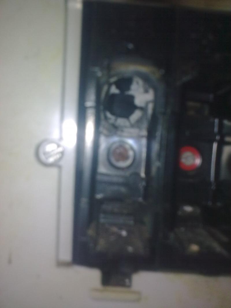

What caused the bang?
I am pretty sure it was being overloaded. The friers on there own are 5500W each (big comercial ones like in McDonalds) and they had 8 chest freezers as well as 4 rice cookers at 1600W each. That was just for the shop, you then had the flat above and all this was running in 16mm CSA tails.
I trust you'll be reporting this to the council
We HAVE to report this to the Council, their supplier and the DNO as the status of the MPAN is held on a national database. If they do anything is another matter but i should find out as i have put a follow up tag on the report.

I am certainly not making excuses for this place but this was in a floor level cupboard with doors.
Forgot to add, all the seals were present so the "friend" who fitted the new DB did so "live".
