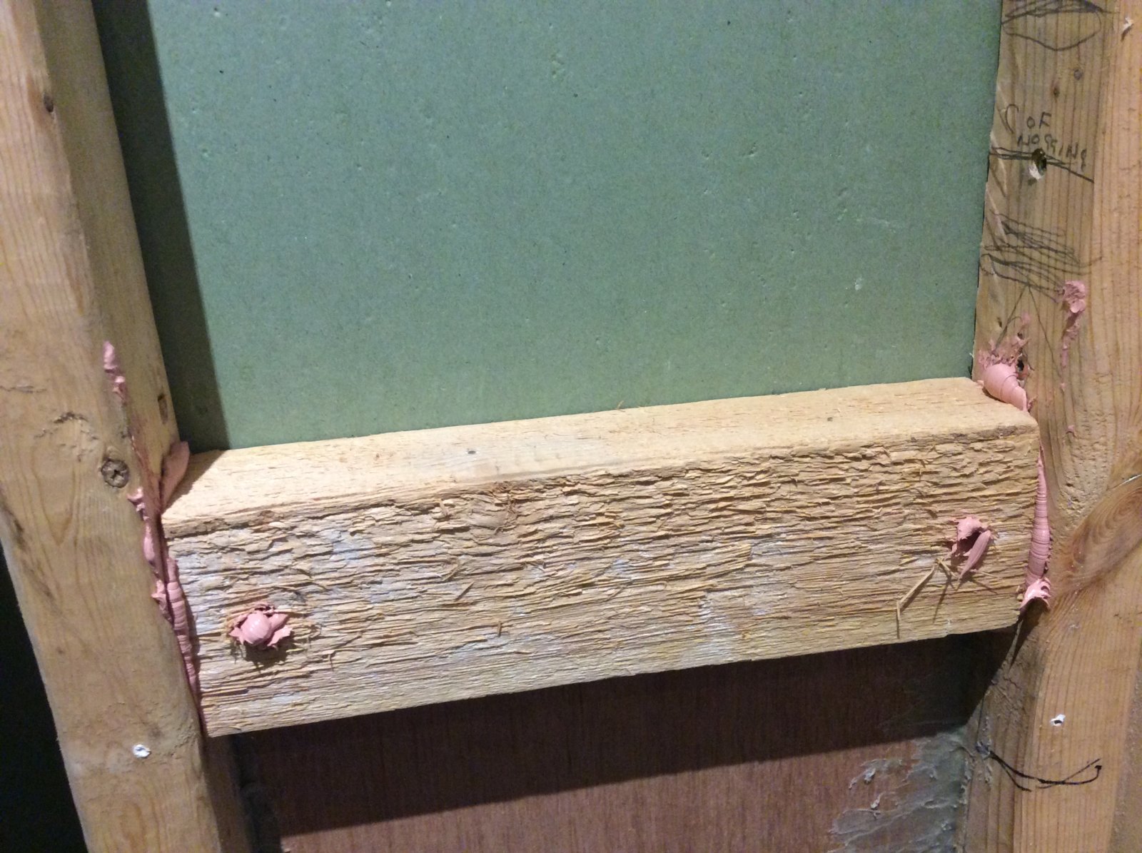

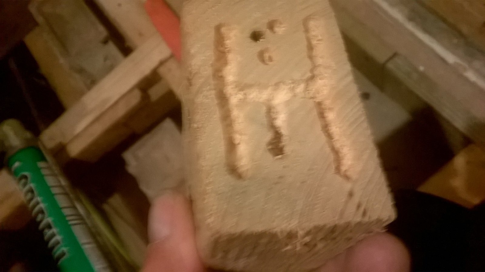

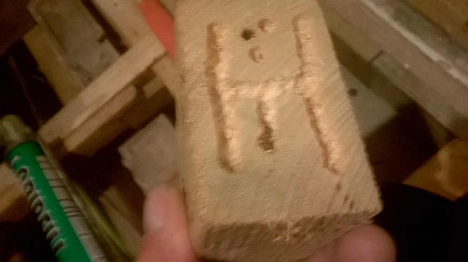

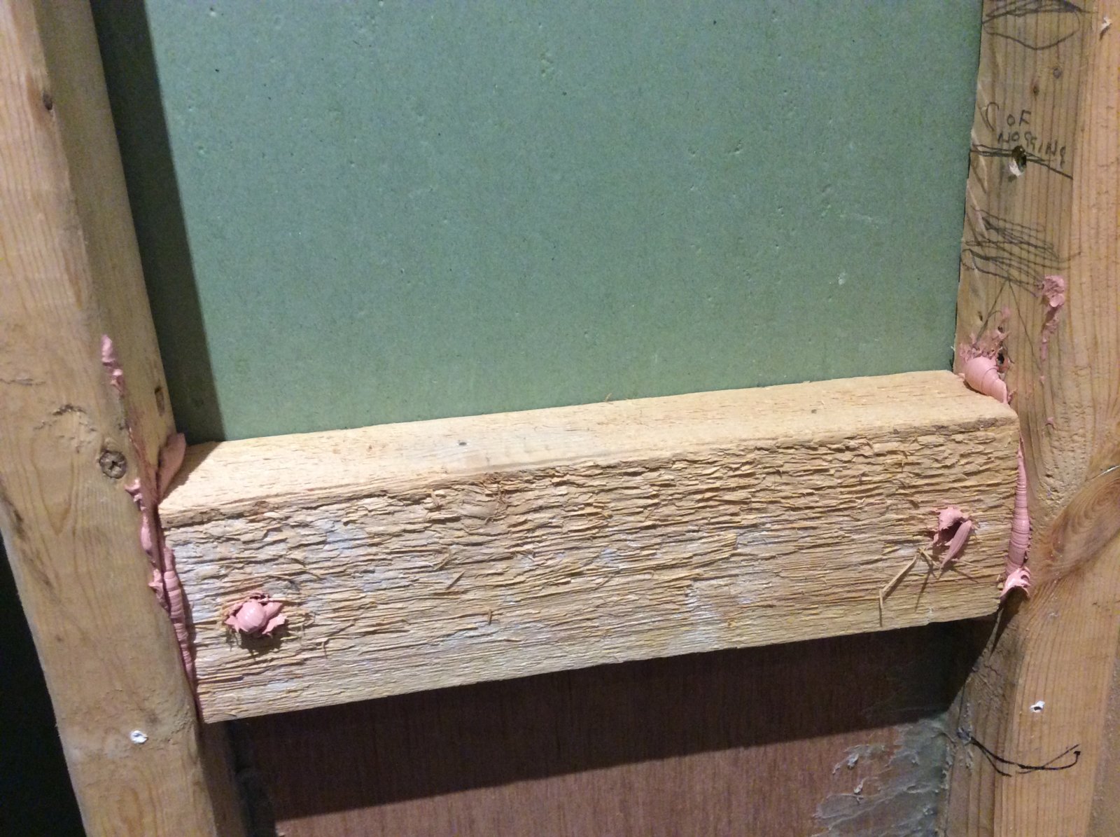

May not be necessary but I gripfill the ends of the noggin as well.
