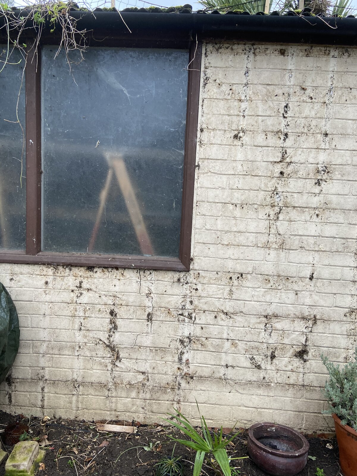

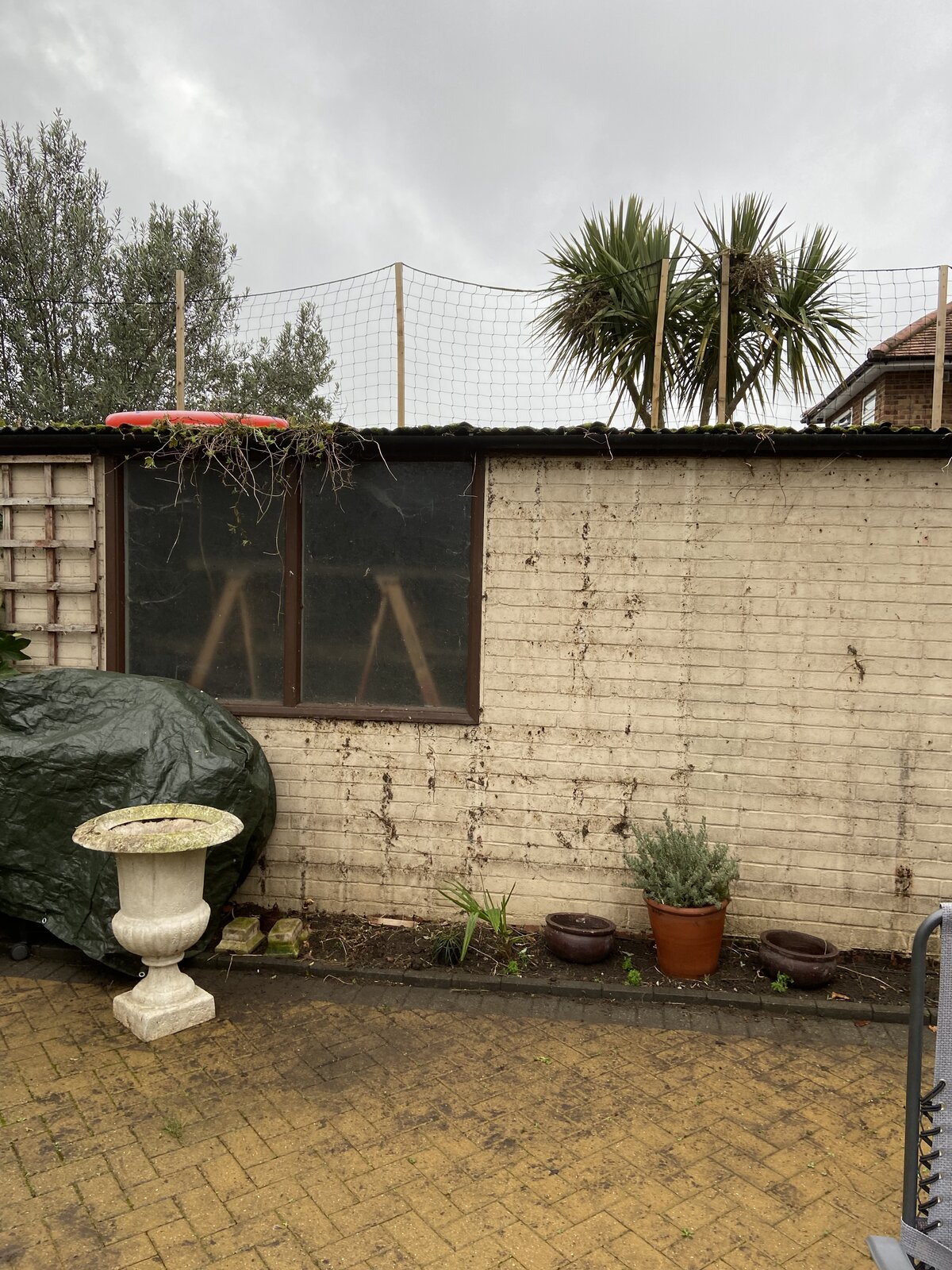

1) existing garage has leaning brickwork- just movement that I can work with as is? You’ll note there is a crack in the middle. Going to remove that segment and put in classic Crittall doors (where the crack and window are)

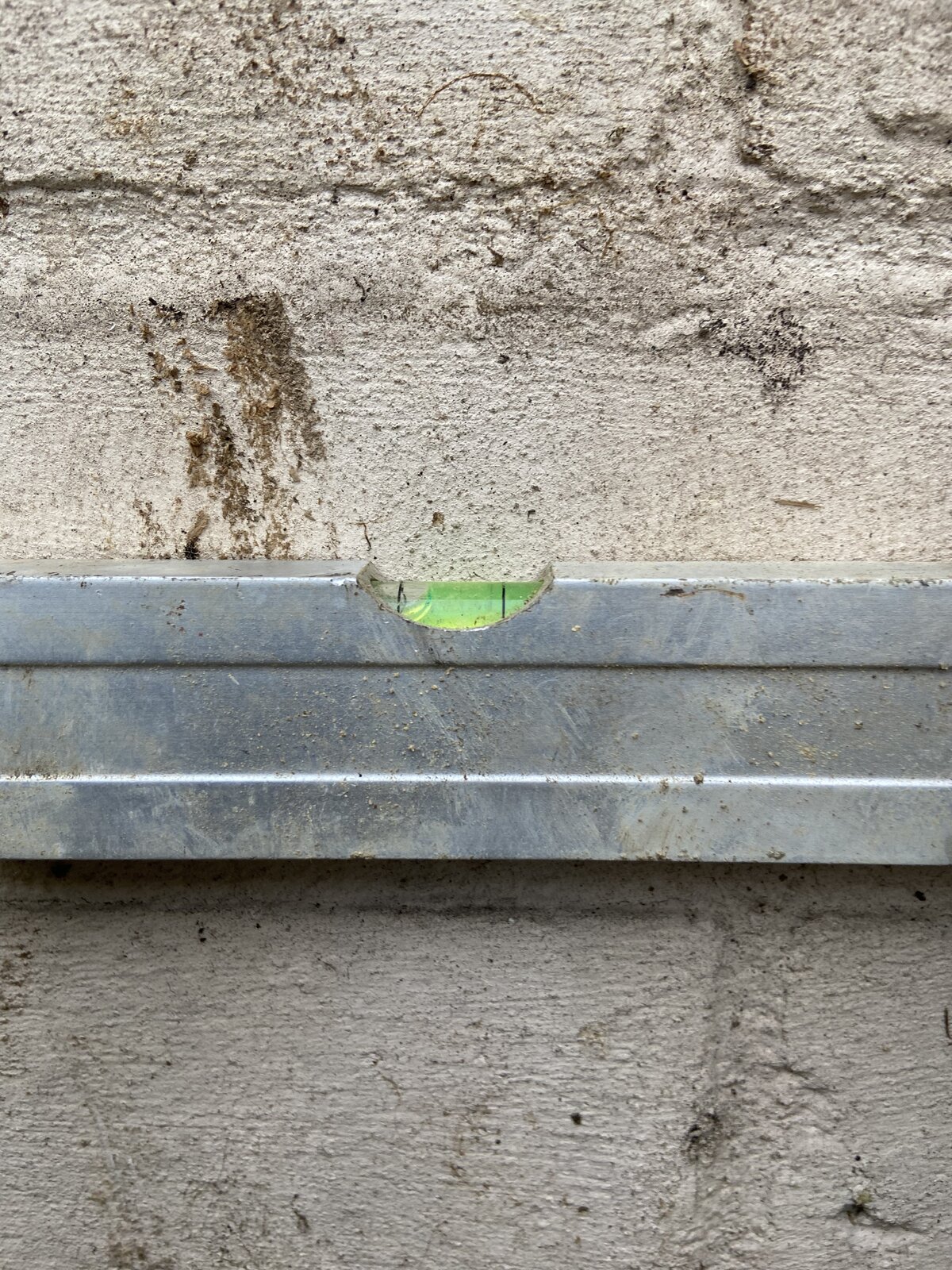

Ps. Pics should be explanatory. (These might be a different order) 1) bubble on the level to show the lean

What’s interesting is that the inner skin (double brick garage) doesn’t seem to have moved…. I’ve cut down bushes in front of it. If you look at the interior brickwork (and exterior) it all looks totally sound to me. The verticals are all correct. Can’t understand why earlier poster called it a pig. Looks solid to me apart from the slope, which might even have been built like that? Just need to know how I could strengthen it, if that’s the most appropriate action

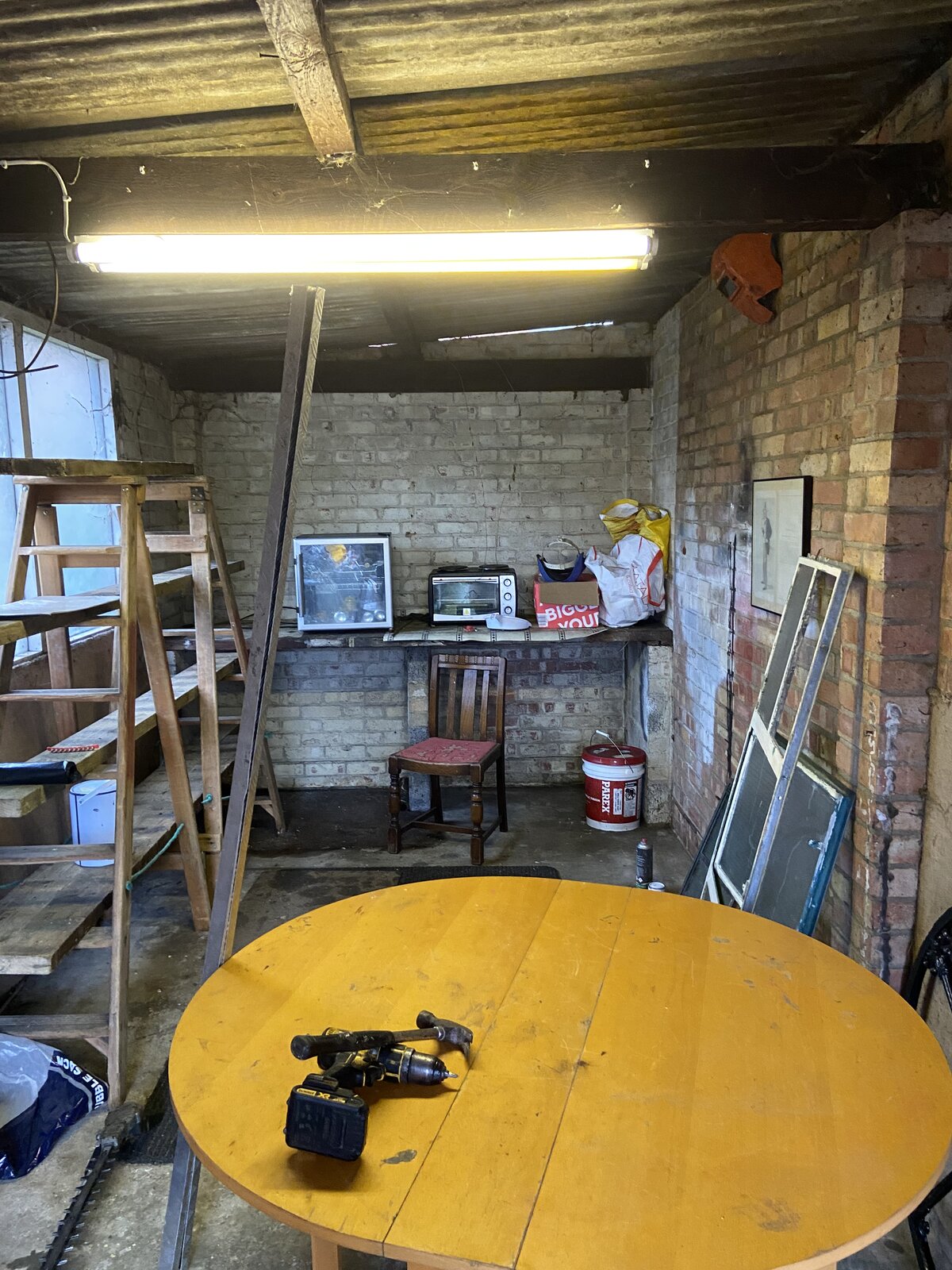

I like the current set up on the counter of beer fridge next to pie oven :giggle:
The part with the crack doesn't seem the strongest, big old window and not much of a lintel?
Current roof sheets look like asbestos cement?

Yes, that old beer fridge has been through thick and thin with me. Bought it for £7 over 10 years ago down the boot sale. .
Yes, Roof going to be replaced.

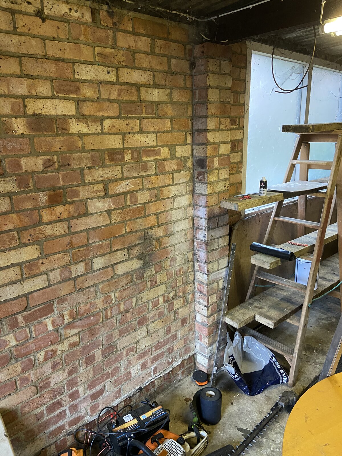

It looks like a single skin garage with 9 inch piers from the photos, rather than a double brick.

Look at the brickwork. It's flush with the window on the inside, Look at how the the brickwork is on the outside at the window. You don't normally have 9 inch piers with 9 inch brickwork. That to me looks like a typical single skin garage with 9 inch piers.

It is, as you say, a single!! AND my shabby measurements with a small level were wrong too. So I took several new levels and they were all straight. It looked ****ed I think because the patio has got a big fall on it and was throwing my eyes out….. you’re obviously a pro. Any other advice will be gratefully received!!!!!

I was looking at the crack under the window -its wider at the top than the bottom, could be an indicator of foundation movement.
As you have rechecked and the brickwork is pumb it may be solid
