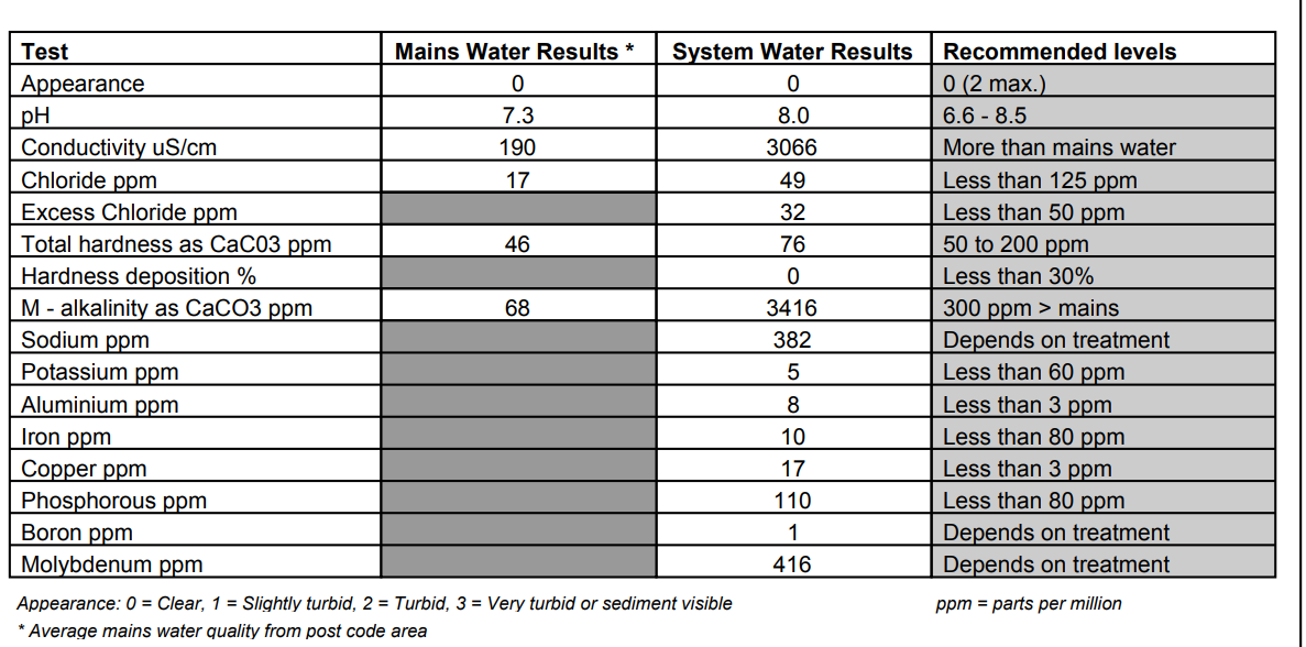

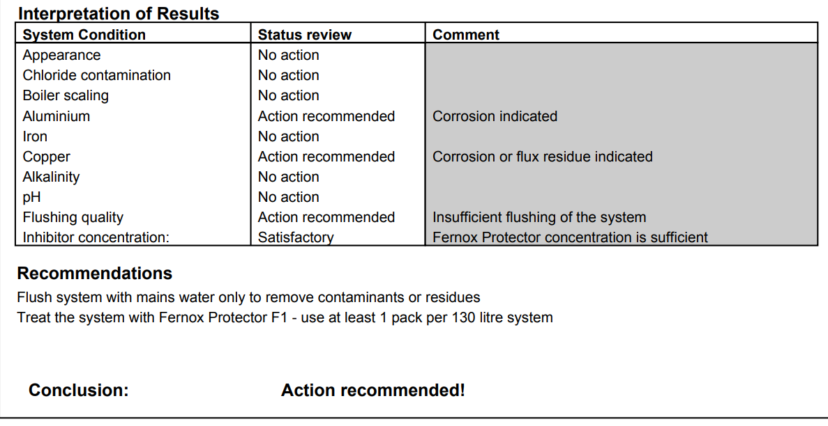

Here are the results of the test sample I sent to fernox a few weeks after the powerflush, I dont know really how bad (or not these results are), can anyone chime in with a bit of knowledge or thoughts? i May start a different thread

Still needs flushed again to remove corrosion. To get it all out 100% is a time consuming job. Depends on pipe runs etc if drop feed then each leg needs drained to endure all crap out. You may never get it all out.

+1 ..... sometimes it a best endevours unless all the rads are being changed and pipework is fully cleaned and flushed then it may not be possible to remove everthing, even with a powerflush.
As long as the system water is clean and clear (low or no turbidity) and inhibitor levels are sufficient then sometime that's the best that can be achieved.
I would look at the alkalinity levels though as that's an aluminium killer, but given the PH levels aren't that high then I'd be questioning the CaCo3 levels. I'd be tempted to perform another litmus test on it and compare with the tap water just to confirm.
