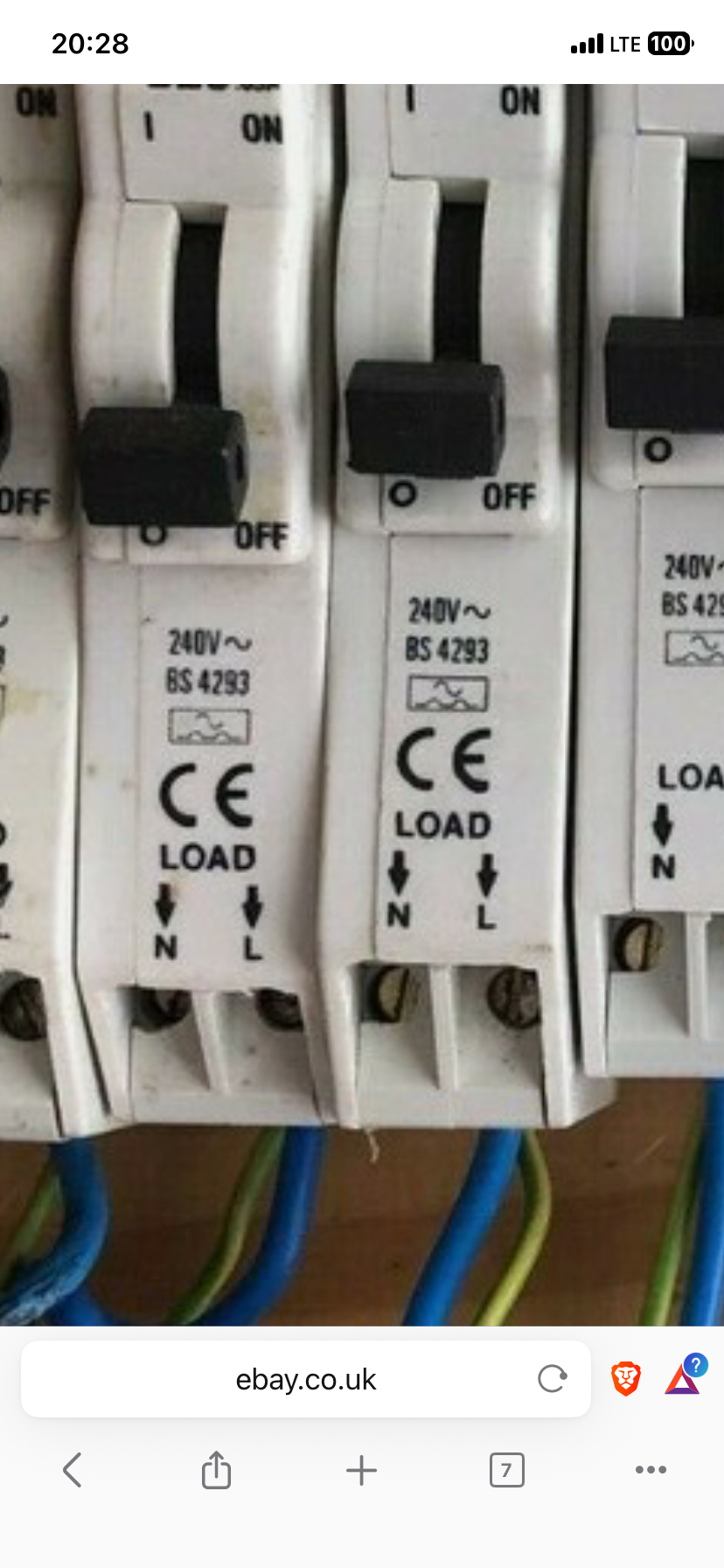

I saw that they were old-type yet were type A and they looked off appearance wise
Happy to be corrected appears I was mistaken
I've dealt with a number of their MCB's but not RCBO's, they look just the same apart from the extension for the RCD part.

... I saw that they were old-type yet were type A and they looked off appearance wise
Where does that "Type A" come from?
Yes the square D rcbos in the ebay link
They're type A according to the legend unless I'm mistaken
Ah - I hadn't even noticed, let alone looked at, the "eBay link" so that explains my confusions :-)! The are, indeed, RCBOs

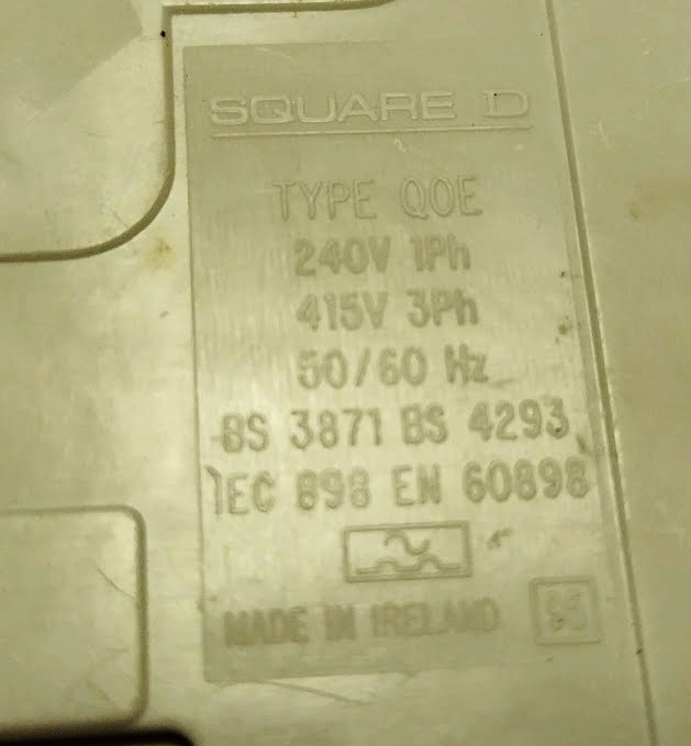

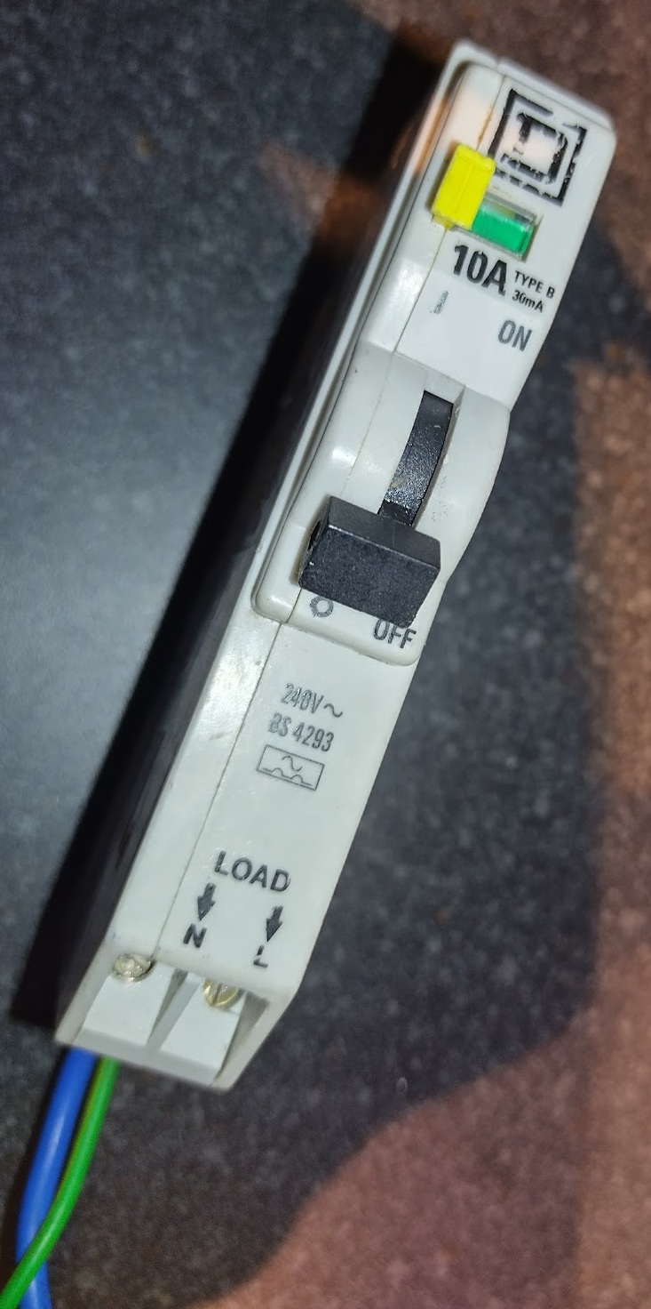

Yes, although that symbol is a little different from the one used these days (in which the upper 'sine wave' is about the same width as the waveform below it), I presume that indicates Type A.
Those BS 4293 devices must be very old - I think that Standard was effectively replaced by BS EN 61008 (for RCCBs) and BS EN 61009 (for RCBOs) over 30 years ago (1995 rings a vague bell) - so I'm a little surprised that they were Type A that long ago -although very many countries did move away from Type AC ones a long time ago.
It appears I was mistaken as the seller is reputable
Indeed. SquareD is, and has been for over a century, I think, an extremely reputable manufacturer.
