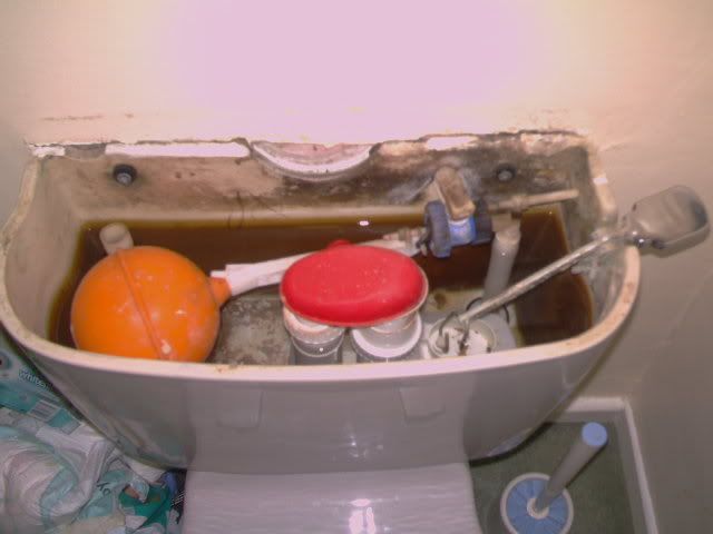

I have a cistern with a lever which is really awkward for my kids to push - so much so they've given up. Even the adults struggle.
The problem (as I see it) is that the fulcrum is in the wrong place...
I want to replace the innards with something that is pneumatic. I have seen these in the past, but cannot find them now - are they still around?
Alternatively, can you suggest another solution?

I think you are going to have to take the cistern off to replace that syphon, and it will not take a different kind of handle.
A flapper valve is not successful with the handle at the end (I've tried it)
You can get a new cistern with push button and internal fittings for about £35.
Or you could get a different kind of thing to replace the syphon, I will see if I can find a pic. (yes, here it is - £10 at Screwyou
I have got one of those "T" handles on one of my cisterns, I will climb upstairs and have a look inside it in a minute.
Looked - mine is "Spring Bathrooms" brand. the syphon is different, it is more to the side so the pull-up is closer to the lever. the lever is directly over the pull-up. The lever is 90mm long from the pivot to the wire link. The link is 100mm long and vertical. Mine works fine.

You can look @ screw-U-like but there`s no round hole in the cistern for the button..............My name Is Nige and I live in the Ashdown Forest...near Eeeyores soggy patch :eek: I`d get the local blacksmith to wrought me a longer lever.......give me a lever long enough and I will move the world .........Gallileo ;)
