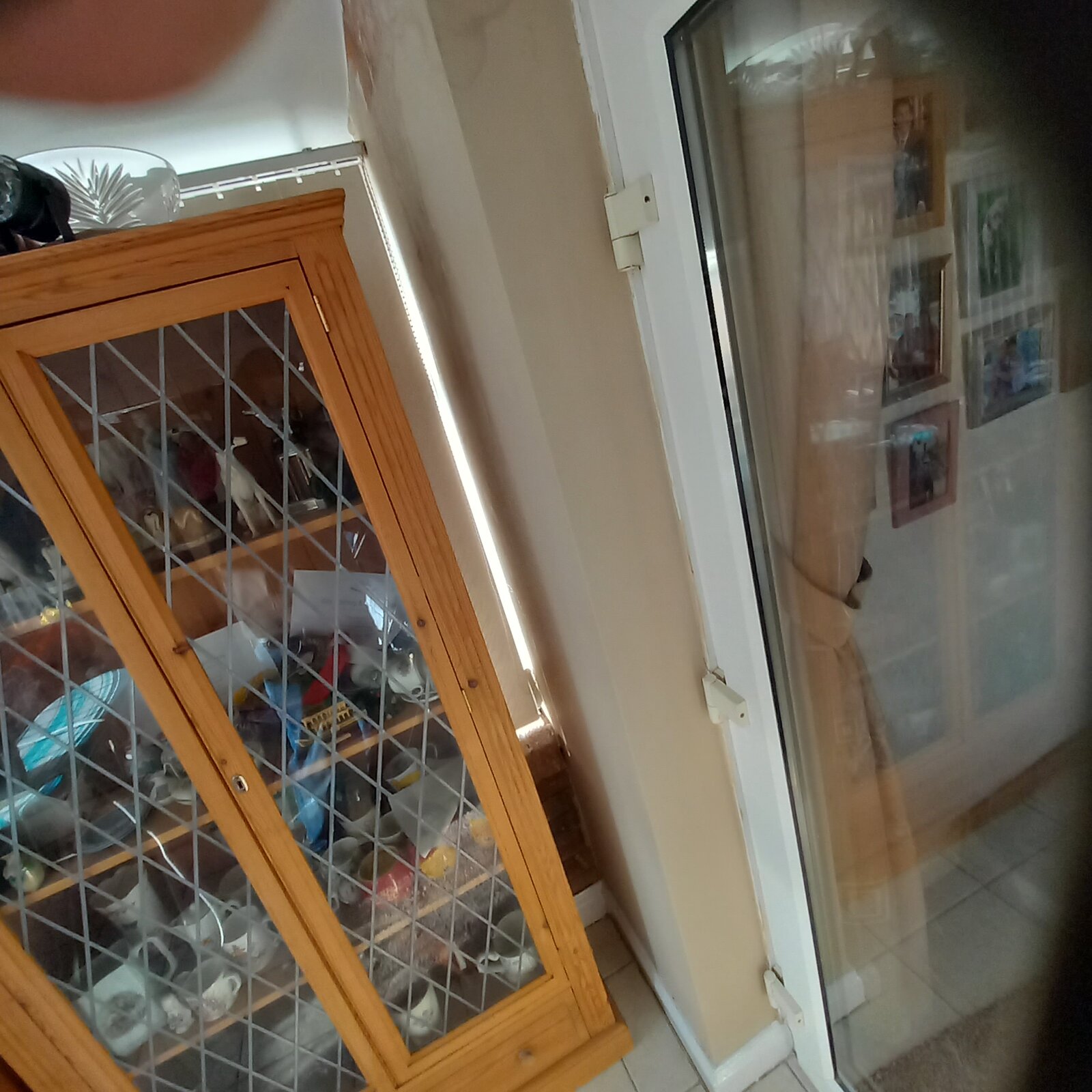

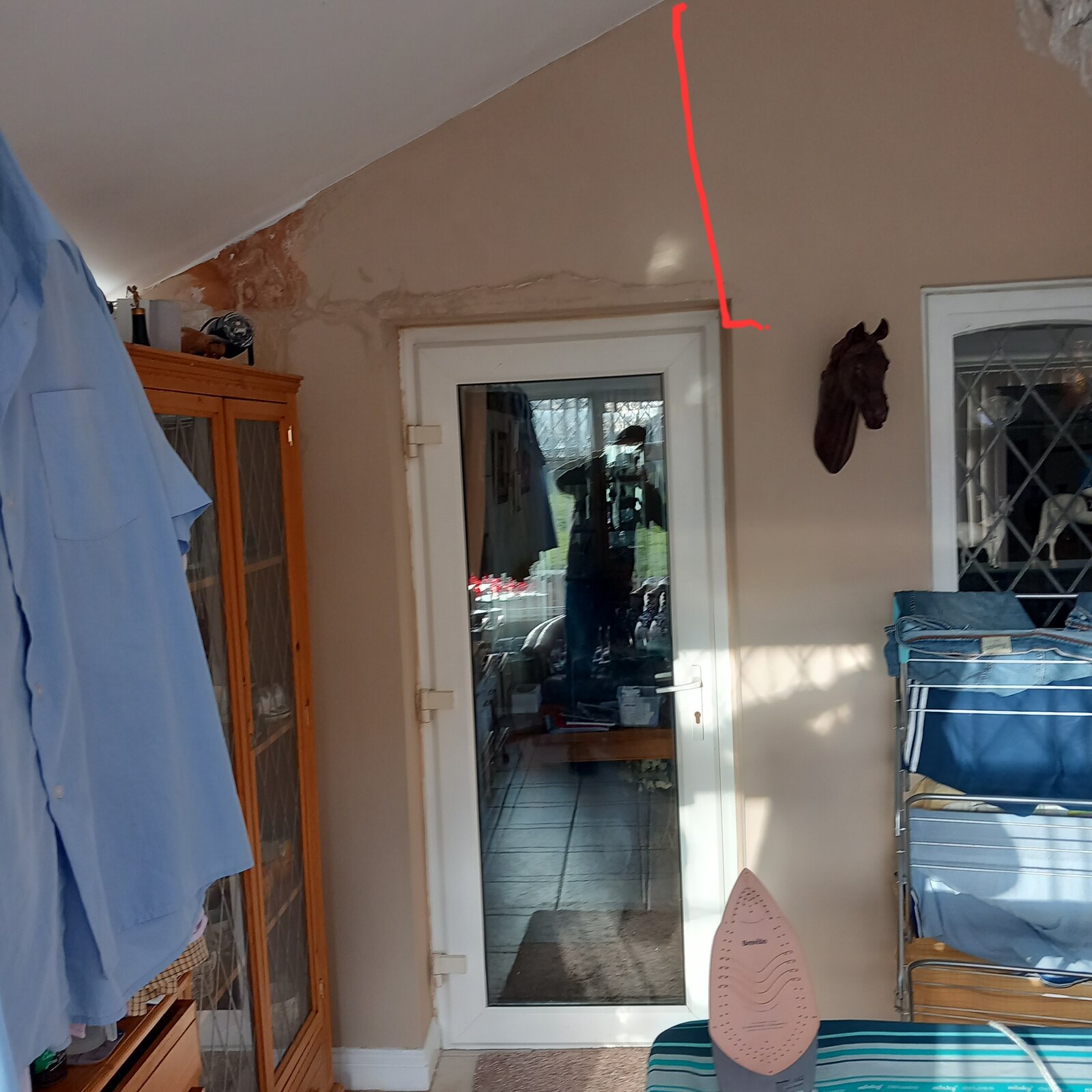

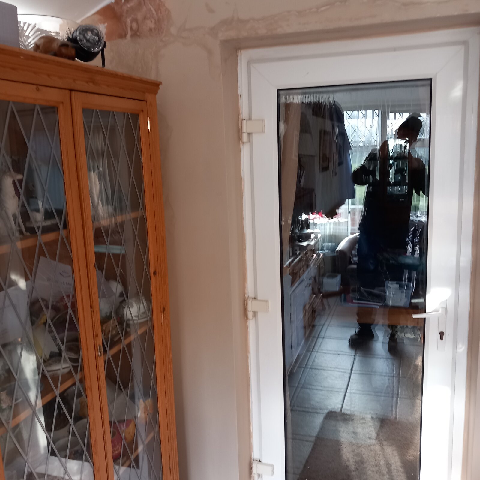

Need to clad a section of unsightly wall and hide water damage. Needs to be clad on batons on wall but put into door reveal without batons. Clad up to where red line is from ceiling to floor and butt up to blinds on the left Does this seem feasible?
look up upvc T&G cladding will give you the resistance to stain coming through i assume you want and treatment free surface matching i assume a white upvc ??

Should be achievable, just make sure battens on wall overlap the edge of the reveal by the thickness of the plasterboard to hide the cut edge.

the reveal at the door looks tight at perhaps8-12mm :unsure:
The OP says clad on batons, but he should be able to scribe to the wall if his skills are up to it.

Hold cladding level then scribe the cut with piece of baton on slope of ceiling
if the damp is there and you dont cure the problem it will build up until it shows its self up elsewhere on the new surface 'drip down to the floor and appear there or mold or fungal growth as it cant dry out
The OP's proposition, & some of the replies border on nonsense.
You dont paint over ongoing damp penetration - personally, I wouldn't paint over any kind of damp signs.
Pulling out that patch of the wall with battens is absurd - it will be weirdly obvious ( to any surveyor or house buyer) & create a possible condition for future dry rot.
You find the cause & fix it - not cause more problems.
OP, why not post pics of the outside shed roof abutment or verge, & the gutter?
Also, why not shift the unit and the blind, and take more pics esp of the brickwork below the window board?
