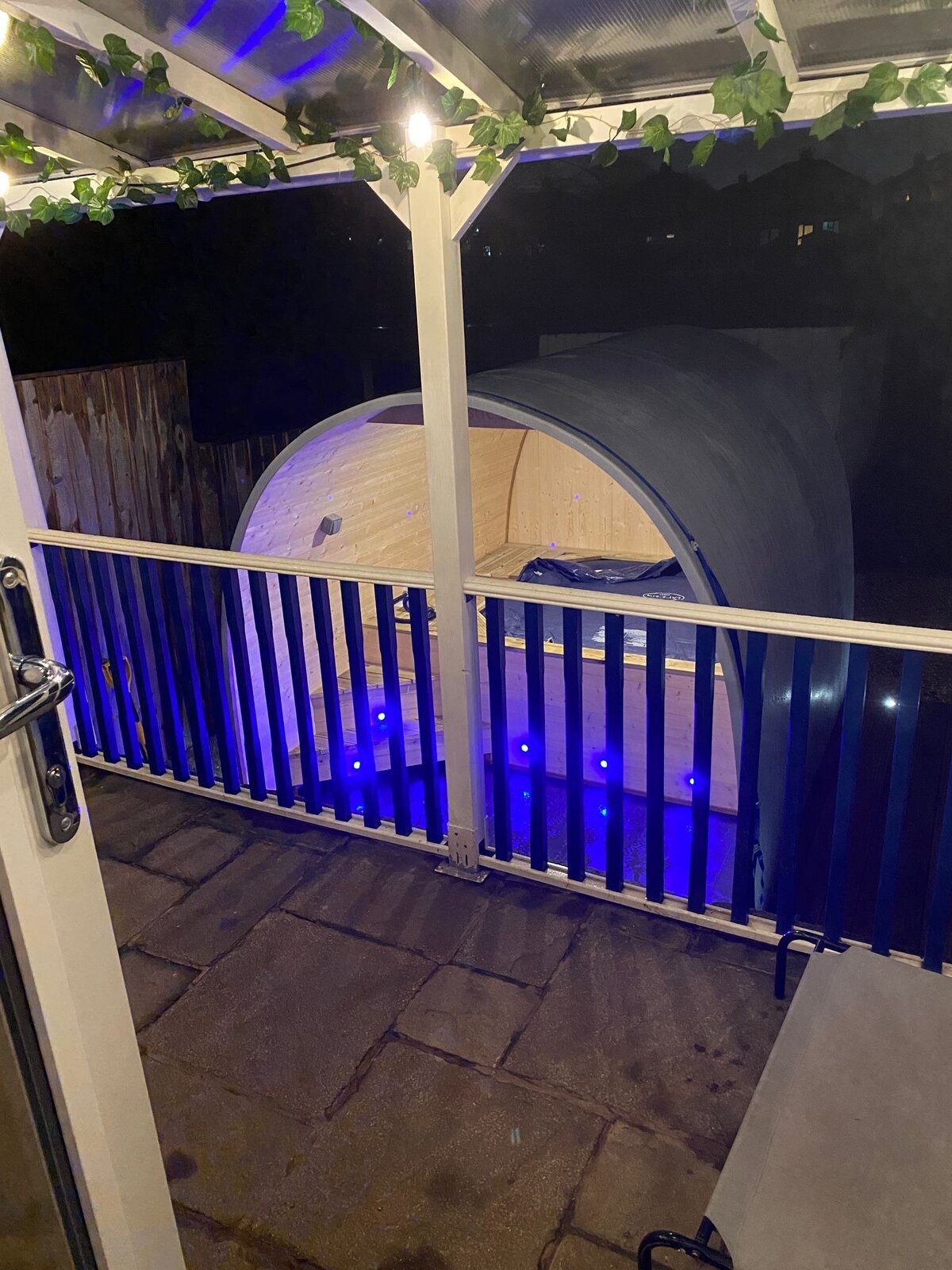

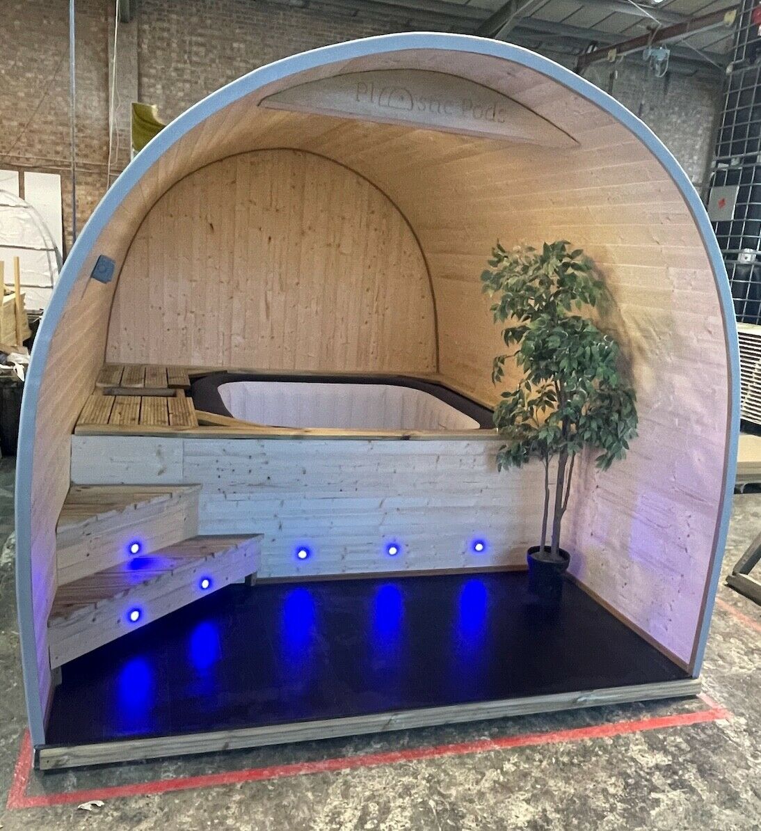

Recently I pleased SWMBO by finally buying her a hot tub. I went for one complete in a garden fibreglass "pod". On the web, it looked fantastic, but when in situ in our garden, it's a stark, ugly, grey, plastic, slab. Don't get me wrong, it's functionally brilliant, but it really is ugly.
So I've decided to clad it in timbre. I don't want to pierce the fibreglass in any way so I don't compromise it's water resilience, so I think I'll make five or six curved battening ribs around the circumference of the pod, then apply the cladding to them (And maybe add some insulation between the cladding and fibreglass).
My reason for posting is I have no idea how to make the curved ribs or whether I'm restricted to wood for them, can anyone offer any advice?

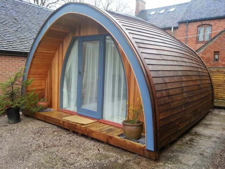

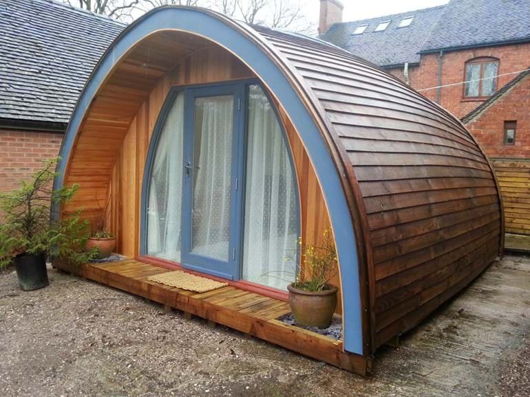

This is the effect I was hoping to achieve with the cladding - although I doubt my efforts would be anywhere near as good
Perhaps use some water pipe secured in the ground on one side and bent over the curve and lodged in an opposite hole, so its touching the fiberglass but not penetrating in anyway, then fix the cladding to the pipes as if they were battens?
